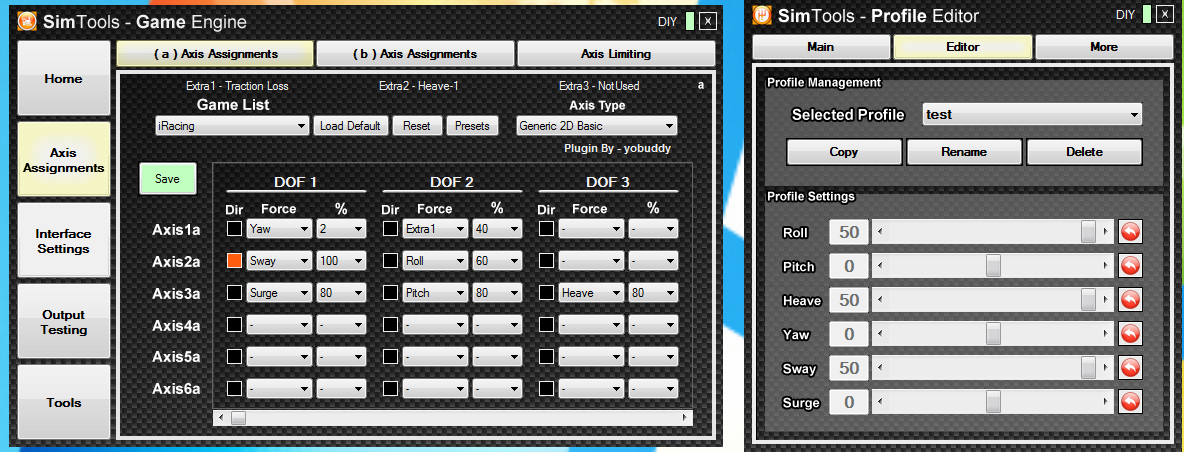

    I am having an issue where my SCN6's are not correctly centering when GameEngine loads.
    If I run the homing routine before running GameEngine it finds the endpoints of each SCN and centers as expected, however, when I load GameEngine and it does its initializing routine, the "home" points are off center on all 3 DOF.
    The sim is usable and has full motion as expected (running iRacing) but the "home" position is not correct.
    I can go into Output Testing and move each axis into the correct position but once Output testing is turned off, all actuators go back to the "fake" home.

    3. Settings are as per attached.

    What is the physical design of your rig, can you please post some pictures of it, because your Axis Allocations are unlike a traditional 3DOF, or even a 2DOF+Traction Loss, though I guess you may have dedicated axis.
    In addition your Axis Assignments % totals are likely too high, you can go a little over but should aim for around 100% total: https://www.xsimulator.net/community/faq/axis-assignment-percentage-totals.120/

    The physical design of our rig is 1 actuator per axis in a pitch/yaw/roll. Here is a video from testing earlier today using the settings above:
    I understand about potential issues with percentages being over 100% total, however this homing issue occurs when I first start GameEngine, long before I even start iRacing. I believe the issues lies in the startup sequence when GameEngine is first loaded. From what I have watched in other builders videos, GameEngine startup should drive each axis to the end points and then return to the middle "home" position, however this doesn't happen.

    I remembered @Historiker had an issue with the plugin awhile ago where heave was causing his rig to go to the top of the heave axis. If im not mistaken it has to do with the way Iracing reports gravity calc. its not zero it reports a 1 as 0
    yes ill take a screenshot l8r today. my heave/extra2 is only at 1 or 2 tho because of sensitivity.
  14. bruce stephen
    Jun 7, 2015
    1,286
    general contractor
    michigan
    9,112Coins
    +1,238 / 9 / -0
    @Jeremy Corbett I would also suggest using sway instead of roll. roll will give you track angle but it doesnt degrade as it should with the addition or increase of sway thru the turns. this is most evident at higher banked high speed turns. it may just be the way the game reports at this time.
