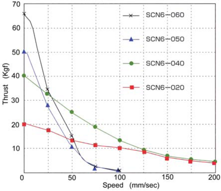

    Looking at the DIY actuators on the forum I was wondering if anybody has looked and build small actuators like the scn6..
    Otherwise for any experienced diy'er.. would it be possible to make these things ourselves??
    Would it be stepper driven?

    Any idea on how to calculate the torque needed for a ball screw setup with a pitch of 5mm to lift between 50 and 75kg?
  3. adgun
    adgun Active Member
    Jan 28, 2008
    509
    mechanic
    Netherlands
    5,638Coins
    +131 / 3 / -0
    1NM gives 100kg force with a 1605 ballscrew

    The formula is:
    Force (in Newton) = 2 * PI * Torque (in Nm) / Spindle Pitch (in m)
    Example: 2 Nm spindle 1610:
    2 * 3,14 * 2 / 0,01 = 1256 N = 128 Kgf

    I believe the SCN6 uses a 2 start 5mm pitch trapezoid lead screw.
    There is a thread somewhere on forum about rebuilding a SCN6.
