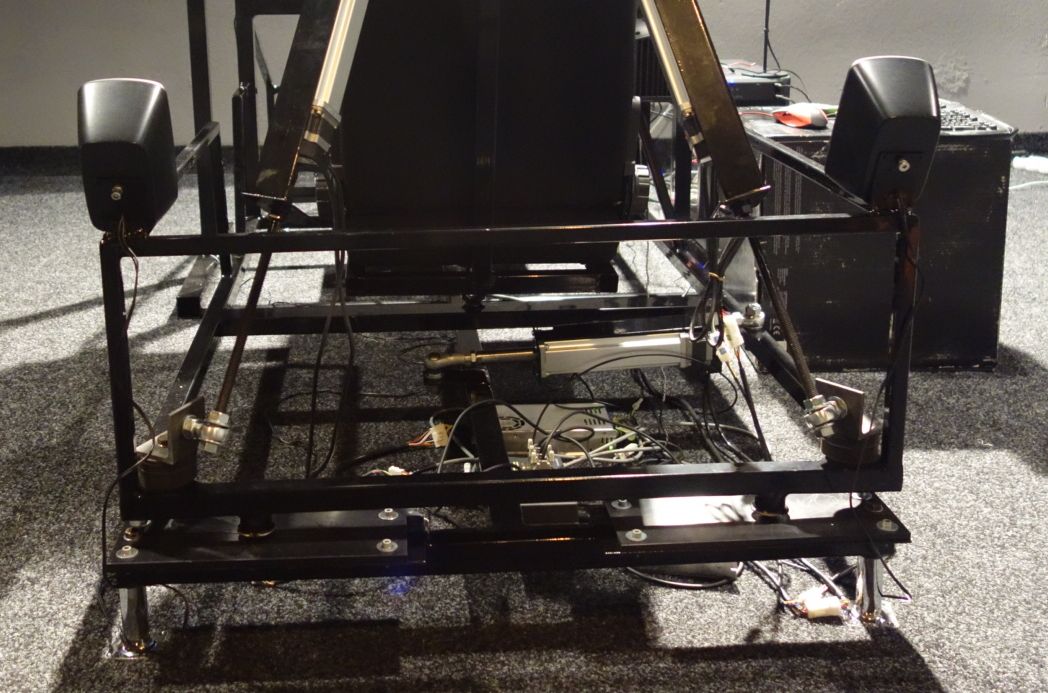

    I still can not find proper tuning settings for my SCN6 rig.
    I´m afraid the problem will be with my SCN6 dampening - so far i have dampening only with silentblocks at bottom scn mount - as shown in picture. I guess it is very soft - when there is some rush movement needed it is absorbed by the silentblocks.
    I tried to turn around the scn mount so all the force goes in the middle of the rubber, it is much better - sharper, faster moving, but on opposite very jerky and vibrant:( then i have to lower speed (to like 5000 only) and acceleration (200!) of scn and also the main profile to calm it down, which is also not what i like. And there are huge differences in cars also, i can perfectly tune the setting for M235i, but then if i jump to formula car, it is very rough as well:(
    So question is - is the problem really in my scn dampening, or shall i try to tune it by software anymore?
    I think some more "inline" dampers will be better - like simxperience do?
    I´m already tired so i thinking about ordering simxperience dampening kit, but i can not find if that work with SCN6 also as i can see the dimensions are different then SCN5:( and their customer support is not perfect, try to send 2 mails with no reply:(
