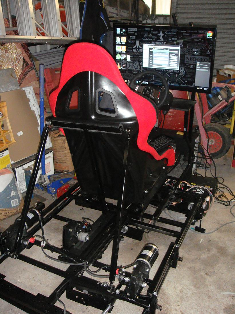

    My current Sim
    Has two motors to drive the seat, another to drive a 'heave' module in the seat, another motor to drive a surge table and another to drive the traction loss (drift) (5 Motors all up). I was testing parts for a possible new 6 DOF (six motors - full movement) for use with the Oculus Rift. But this has turned out so well I don't see what extra a 6DOF would give me. Really pleased with how it has turned out.
    Build history
    Changed to chain drive for surge table and traction loss.
    Then installed a heave module in the seat.
    Basically I cut a hole in the bottom of my seat and hinged a metal plate in there which is driven up and down by the motor and the levers/shafts. It works brilliantly with the sim driving so much more naturally without all the heave/pitching, which has changed my mind in trying to build a 6DOF (not worth it).
    I have uploaded a video (below) of my seat heave module for those that have asked, the lighting is not the best, but you can see the levers working under the seat.
    Final added a Buttkick Gamer 2 for engine and other fine vibration. Job done.
    Now just waiting on my Oculus Rift which I should receive sometime in July 14.
    Added Oculus Rift DK2
    Shown in the video below using DCS.

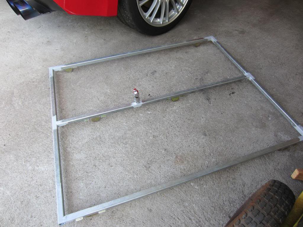

  20. SeatTime
    2,573
    28,370Coins
    +2,844 / 39 / -0
    Decided to put together the seat frame while waiting for parts to turn up. Still to add bracing for motors/seat and possibly stylised Alu/plywood plates on top (for safety and to keep wife happy looks wise).
