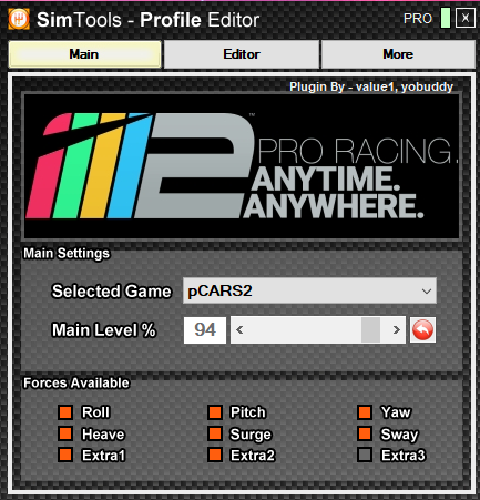

    I have a Prosimu 4-DOF simulator with 150 mm actuators. When I began using SimTools I tested the actuators at nearly their full length, but I quickly discovered this felt more like a carnival ride than a racing simulator. Accordingly, I knocked actuator limiting down to 50% and the platform feels fantastic now.
    However, due to the actuator limiting, one thing I'm missing out a bit on is the feeling of elevation changes on various tracks. Ideally, I'd like to keep surge and sway locked at using only 50% of the actuators, while giving heave, pitch, and roll use of 95% of the actuators to get a better feel for changes in track elevation. I've tried lowering the % values of these forces by 50%, but things still don't feel right. Additionally, I clicked the "fit" buttons on the surge and sway forces and tried setting their "boundary" values at 50%, but as far as I can tell these adjustments have no effect on how the actuators behave.
    Any suggestions on how to achieve what I'm shooting for would be hugely appreciated. Thank you.

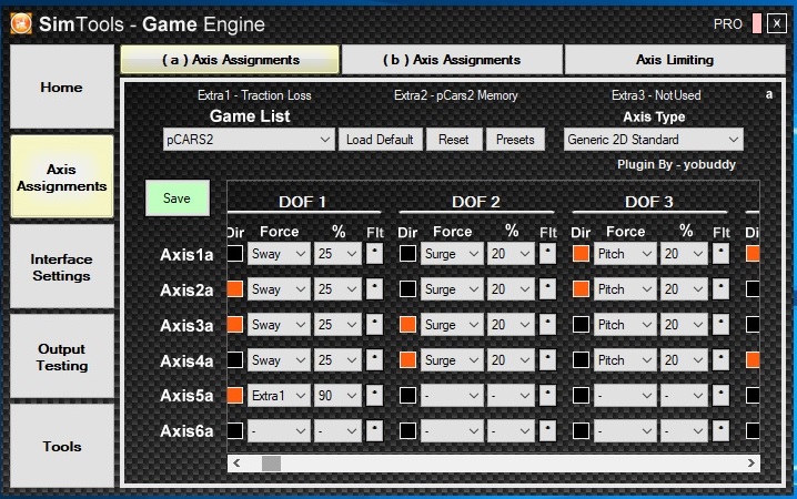

    I own a prosimu 5dof with 150mm prs200 actuators so I assume same as you except for the traction loss. Would love to exchange notes. I have only tuned for iracing and project cars2. Not tried any flightsims yet. I’m at work for the next three days, but I’ll post my current tuning and axis values when I get home. What racing sims are you running?
    A little disclaimer: I’m learning simtools and I’m not 100% certain on my own understanding and if I spread disinformation please let me know. Take it for what it is worth.
    Come to think of it I believe I can give some settings from memory for pcars2 at least. In axis sway is at 25, surge 20, pitch 30, roll 30 and heave 20. I run axis limiting at 95. As you run at 50 limiting and your axis assignment at prosimu recommendation(?) this means you effectively cut your axis-assignments in half so in effect we are in roughly the same ballpark as far as axis utilisation is concerned. Did I get that right? As prosimu recommends 50 or 60 for pitch for example. Will there be a difference in feel when I set 30 in axis assignment with 95 limiting opposed to 60 with 50 limiting? I would assume it is two different paths to the same results?
    If so with axis at 50 limiting you have excluded the actuators potential by 50% and with your current settings what you want to achieve is not possible.
    If my assumptions are right you can try the following. Axis limiting at 95%. Then you tune pitch and roll by their own. Start at 60 for each. Recording telemetry in tuning center at the ring gives me a value of about 9 (perhaps a little higher) on both pitch and roll and as far as I can gather you need at least that to get the full telemetry on that track. My understanding is if you set 6 (degrees) on pitch and you are in an incline of 6 degrees, simtools cuts out any output from the game over 6. In other words your sim will not move further than the position it is in when the game telemetry reaches 6 and movement in the range +6 is clipped by simtools. Movement for pitch resumes again once simtools reach a value below 6. Could use some verification on this.
    When pitch and roll feels ok, try them together. Still ok, move over to the axis that controls forces in G’s. Heave, surge and sway. I run these 20, 20 and 25 respectively, but with lower tuning center values. heave 1.22, surge max 1,3 and min 1,7 (for aggressive movement when putting the pedal down and more range when braking) and sway I have at 2.22 I believe. This gives short and snappy cues for the g-forces as to not mess up the feel of pitch and roll. If you have too high axis assignment value on surge for example it will feel like you drive uphill while accelerating on flat ground. If you are accelerating while going downhill worst case is these two directions of force cancel each other out and the sim remains in a horizontal position. Surge pulls the front up and the pitch pulls down. Result:flat.
    Now for brevity’s sake, don’t bother with heave right now. When you get surge and sway right. Try them together. If you are happy, now try them with pitch and roll. Not happy? If so I believe you have met the physical limitation that SeatTime described and you have to make choice.
    That choice is if you want to prioritise longer movements (more range and detail) for g-forces (surge and sway) or DOFs that affect the inclination of the car (pitch and roll). My current priorities is long movements (high tuning center values) for pitch and roll and shorter and faster movements for G’s (low-ish tuning center values). From my own testing this is the best result I have achieved. My conclusion is that sway in particular gives a lot of usefull cues in mid-corner, but pitch and roll is increasing the immersion factor and if the track is relatively flat you can have both to a degree, but you will run into challenges on the ring. As you have a SeatTime tensioner (I do too, but haven’t put it in the mix yet) I would run sway on that for longer g-forces, a little sway on the prosimu to give a cue at the beginning of turn in and at the end of the turn, low tuning center settings for surge for aggressive, but short movement for breaking and accelerating and higher tuning center for pitch and roll to get nice range and linearity on those.

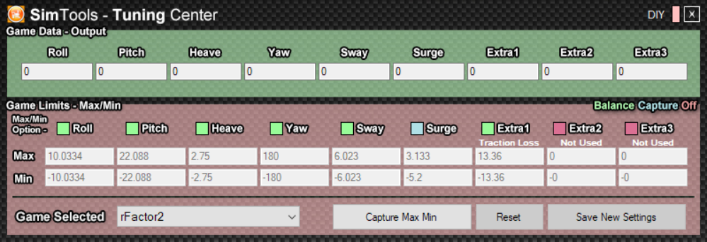

    3DOF, SCN6
    I am by no means expert in SimTools, and my system is different (ProSimu 3dof with Dyadic actuators), but I would imagine you may get better results by:
    * Reverting the limit to minimum recommended by ProSimu (in my case, 85%) IMHO, it is better to limit travel by manipulating Min/Max values, because you get more range headroom.
    * Make sure DOFs you want to be more pronounced have enough Axis assigned.
    * Manipulate Min/Max values ranges to adjust how much weight each DOF gets. I multiply Min/Max value by some multiplier to reduce/increase travel. In your case, I'd say multiply Surge by higher value than the one you use for Pitch, so that Pitch gets to full travel before Surge.
    This might sound confusing, but basically smaller Min/Max range makes actuators reach full travel earlier, whereas larger range will require more force to be reported by the game for actuator to travel. By using different multipliers, you could prioritize forces.
    What I did personally, I collected Min/Max for an average car, then I multiplied those values till forces are not too strong at 0s in game manager profile (Really wish SimTools had master multiplier in Game Manager). I settled on multiplier of 2.5 for all DOFs Min/Max values. The great benefit is that when you crash or hit something, it is only then you get a strong blow, because using this approach leaves some headroom for extreme situations. Then, I just use Game manager profile sliders to amplify/reduce individual forces for each vehicle/track.

    I'll just ask some more as this has not been clear to me. So the max/min tells at what output from the game where full use of a given axis should be used. Tuning center setting for pitch set at 3 means that as the game gives out a value of 3 I'm at full travel of the actuator. If I set a tuning center value of 6 and the game gives a value of 3 I will be at 50 % travel? What I can't wrap my head is how this relates to the speed of the actuator. I guess it might just be better for me to accept this as a "just how it is" kind of thing.
    To give a concrete example for what I am struggling with is when I like the feeling I get with a certain tuning center value, but the output value of the game is higher than that. Lets take pitch as an example. After tuning pitch I've found a tuning center value of 6 which feels responsive and good after running a medium car on imola. When I then take the same car on the ring where pitch can reach around 9 or 10 I experience that pitch axis goes dead when reaching 6 and it feels disconnected because there should be motion from the 6-10 range. I then put a tuning center value to 10. Then I get the complete range from the game, but motion feels less responsive and to soft. How do I get the feeling of a 6 with the range of a 10 is what I'm asking I suppose?
    Will increasing speed and acceleration in the interface settings be the way to go or is it possible to solve this by manipulating the axis assignment percentage in some way?

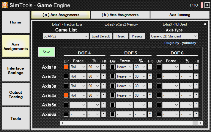

    I believe you are right and I've tried this for a short time today and it seems to be the way to solve my spesific problem. Higher tc values combined with increased axis value for the given dof.
    From what I gather how prosimu intend you to tune simtools is different to what the FAQ here on xsimulator tells you to do. FAQ states: Keep axis assignement to total of 100 % to make sure to avoid clipping because the actuator runs out of travel. You might run into clipping of the telemetry depending on how you set the tc values. In a racing sim mostly related to roll and pitch as I have tried to tune this way and for the g-forces I get good motion even though I have chosen to set those values lower than the output from the game in certain cars. For g-forces it works for me because I find the initial low-G movements (from 0 to 2), but of course will loose the g-forces present when driving a formula 1 car in a tight bend (G's higher than 2 and further) for example. I will attach my settings that I'm fairly happy with after following the intended way of tuning posted by Noorbeast.
    The way I've come to understand prosimu tunes their simulators is with high axis values and then you have to tune your tuning center values way up from the recording you do while tuning center is gathering telemetry or else it will feel like a riding a wild bull. I guess that is why you @The Iron Wolf use a multiplier of 2.5 for your tuning center values right? As far as I can tell you might risk reaching clipping of the actuators travel and that way loose information from the sim, but if your tuning center values are high it will mean that a given DOF will never use the full length of the axis assignment value.
    Example: Tuning center value is 6 degrees for roll. Axis assignment is at 25 %. If the actuators total range is 10 cm that would be 2,5 cm movement available to that DOF. Game outputs a 6 which is full travel. So actuator will move 2,5 cm.
    Next example: Tuning center value is 12 degrees for roll and axis assignment is at 50 %. What you have done is doubling these two values which means that total travel is 5 cm, and as the game outputs a 6 which is half of 12 it will only using half of the 50 % assigned to that axis meaning actual actuator travel will be 2,5 cm, but with headroom for additional telemetry being conveyed through the actutator if the game outputs values above 6 and 12. The risk here is that you run out of actuator travel capacity. Now does this mean that in each of these cases the actuator will respond with the same speed and force?

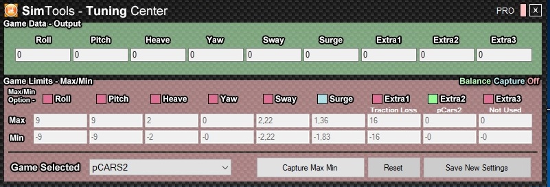

    I am glad it helped. I am perfectly aware of ~100% axis alloc requirement, however I am yet to observe any clipping. This is one of the things I couldn't understand in SimTools yet, but I am still learning. I observed Virtual Axis output test and I never saw any axis maxxing out in racing condition at 60% alloc per DOF. If I adjust axis to ~100% sum, I receive very fast and very limited motion,that is not my preference.
    I use 2.5 multiplier because if I use captured Min/Max ranges I get:
    * High motion in average scenarios
    * No headroom for extreme forces, crash, off road etc.
    * I also run into problem of adjustability of Game Manager profile. +-50% is not enough for drastically different vehicles - Karts vs F1. Here are my math notes for myself to explain the problem, and benefit of expanded range:
    Expansion of Min/Max works, because:
    [-1, 1] -> Min adjusted [-1.5, 1.5] Max Adjusted [-0.5, 0.5]
    [-1.5, 1.5] (scaled by 1.5) -> Min adjusted [-2.25, 2.25] Max Adjusted [-0.75, 0.75]
    [-2.0, 2.0] (scaled by 2.0) -> Min adjusted [-3.0, 3.0] Max Adjusted [-1.0, 1.0]
    [-3.0, 3.0] (scaled by 3.0) -> Min adjusted [-4.5, 4.5] Max Adjusted [-1.5, 1.5]

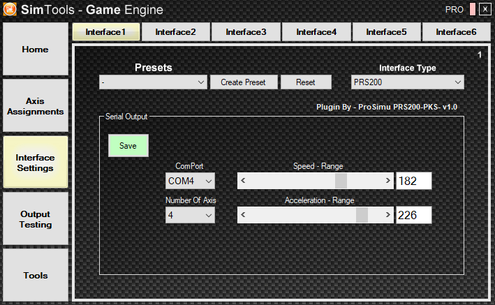

    -I have made some modifications to the speed and acceleration of the actuators. These values were recommended by ProSimu to another user and I decided to adopt them as well. I'm not sure if they make much of a difference from the base values, but I've been happy with them.

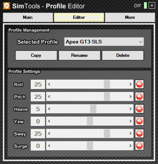

    Here's some screen captures of my settings for Project Cars 2. I set all of my actuator limiting back at 95% and by messing around with the "force %" for sway and surge as well as the "main level %" for PC2 I believe I've found a good compromise between solid motion and feeling too much like a roller coaster. Please feel free to try them out if you're so inclined. Thanks again!

    Just some comments...Axis Limiting in effect does what the name suggests, limits movement to a % of the available range, and is not really the same as changing percentage of an axis, which is a % component of an allocated range, with the norm being 100%. Nor can the effect be fully considered without also considering the Tuning Center values and Game Manager profile tweaks.
    To use an example to illustrate, if you have a profile for a game that covers say and F1 to an off road car with a huge suspension travel, then with the latter the potential range of movement available is reduced with axis limiting.
