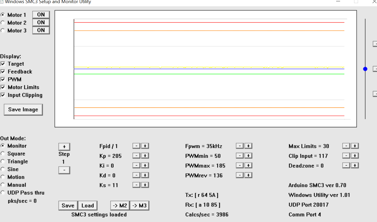

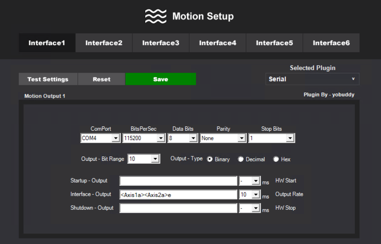

    Here they are:

    In SMC3 Fpwm to 25kHz
    In SimTools:
    BitsPerSec - 500000
    Interface Output - [A<Axis1a>][B<Axis2a>]

    Well now I've got something to play with!
    Thanks noorbeast
