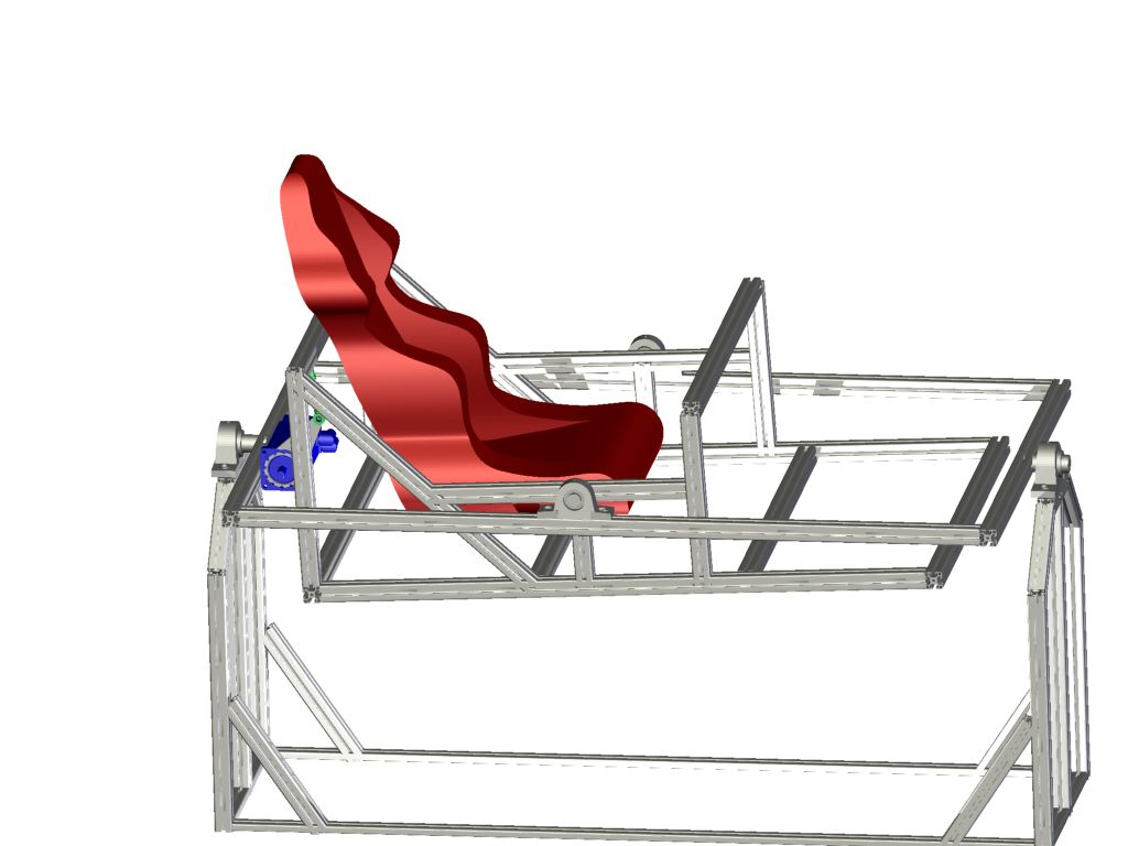

    I am a new member of this board and i just started to plan a 2 DOF sim. :hi:
    For the beginning I wanted to learn all the functions of Profiler 2.0.
    So i started with the Gauge setup. Seemed easy but now i have a problem.
    Profiler --> Servo Commander
    Now i have the Problem that all 8 PWM Signal are on one Soundcard output. I tested the signal with an oscillator.
    one Output: 8 PWM Signals
    remaining 7 Outputs: No Signal
    Anybody an idea? :sos:
    Soundcard is a Realtek High Def Audio Onboard.
    I added a picture. It's the fist construction and not a final version .
    Greets Yoshi
