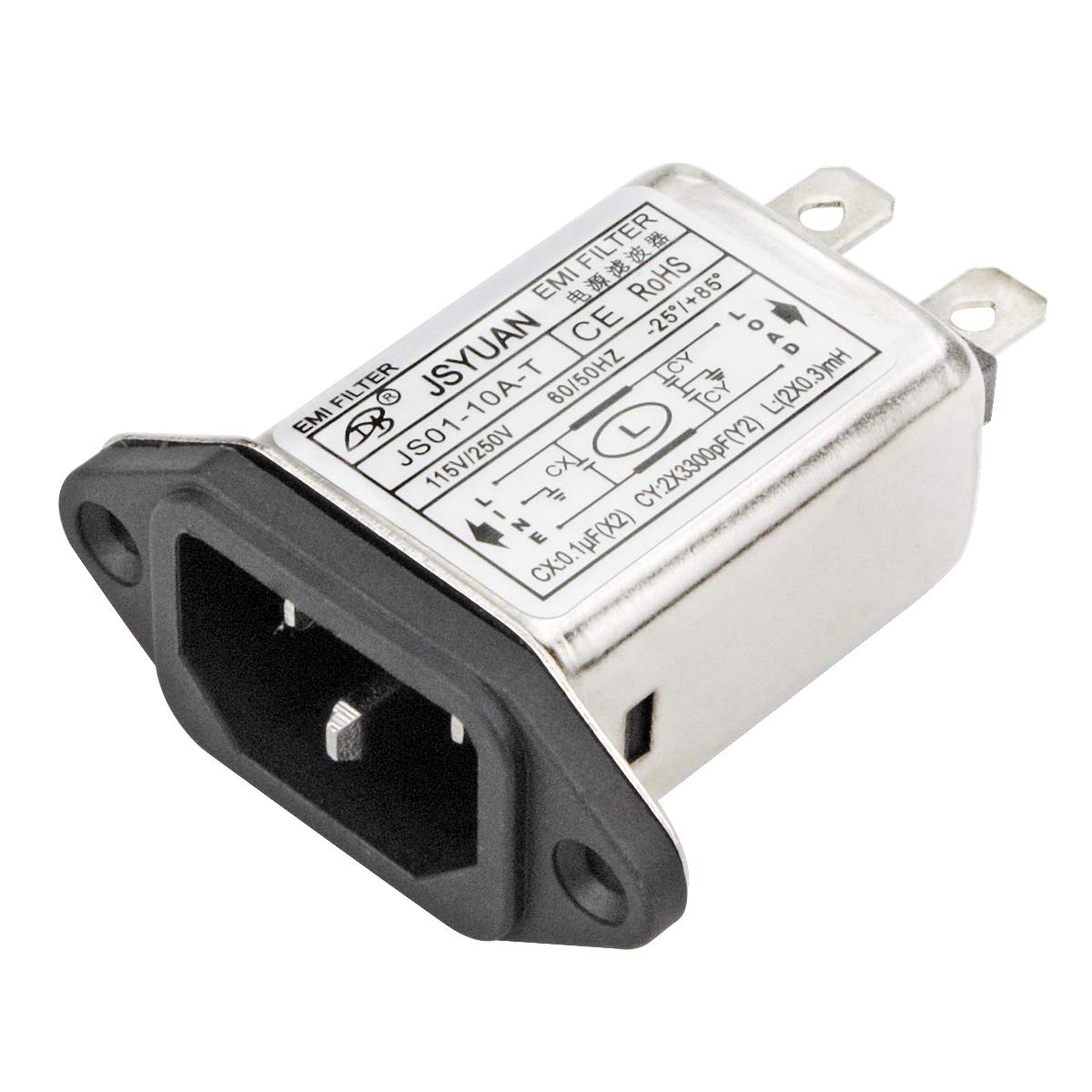

    Yes i think i will also add an EMI filter.
    Update: Now i am pretty sure the biggest issue is the interference from the motors/motor cables. Today started also having issues with my VR headset tracking , this was something never happened before. When i took headset off and looked what`s going on i noticed my headset cable was leaning against the motor/actuator assy. After moving cable away from motor tracking was fine again.
    So my next step is going to be to rewire the motor cables.
    For the time being i can use the SFX mostly fine, if i make sure USB cables are as far as possible from the motor wires.
    btw, Anyone have a video link how to disassemble/rewire the motors?

    Ordered some shielded cable today. Will update to this thread if my issues are gone after rewiring motor cables.
    Also ordered an EMI filter. I think it doenst hurt to fit the filter too.
