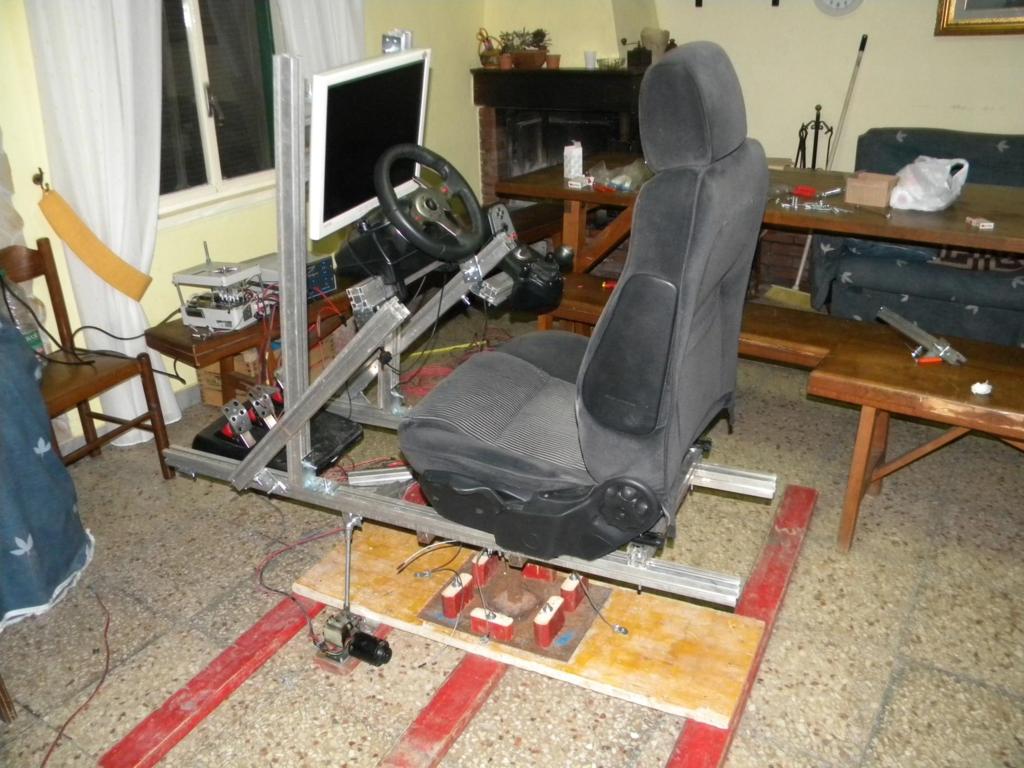

    Hi, my name is Michael, 30, electrical engineer, living in Sicily - Italy. About four months ago I discovered http://www.x-simulator.de ... and all his people, always available. I started to think about the type of sim that I wanted to build. I chose the 2-DOF SFGT type - pitch and roll - ie 2dof-wiper-motor-car-simulator-by-Deriya-(SATO), 2dof simple wipermotor chair by ua6aak. In the future I'd like to give the 3-DOF Sim - drift / yaw - ie 3-DOF simulator by whaleman SFGT style. At the time the mortgage is in prototype phase, running 2 DOF, but some solutions will be implemented (ie 3DOF) or improved, as well as appearance. Below is a video of the first tests.
    Salve a tutti, mi chiamo Michele, 30 anni, ingegnere elettrico, vivo in Sicilia - Italia. Circa 4 mesi fa ho scoperto http://www.x-simulator.de … e tutta la sua gente, sempre disponibile. Ho iniziato con il pensare alla tipologia di sim che volevo costruire. Ho scelto la tipologia SFGT su 2 DOF – pitch e roll – i.e. 2dof-wiper-motor-car-simulator-by-DERIY-(SATO), 2dof simple wipermotor chair by ua6aak. Nel futuro mi piacerebbe dotare il Sim di 3 DOF – drift/yaw – i.e. 3-DOF SFGT style simulator by whaleman. Al momento il simulatore è in fase prototipo, funzionante 2 DOF, ma alcune soluzioni verranno realizzate (i.e. 3DOF) o migliorate, come anche l’aspetto estetico. Di seguito un video della prime prove eseguite.

    Nice work!!! :clap:
    It's interesting that only 2 wipermotors can move such a construction. :eek:
    I intend to build a similar one, but i was thinking i need at least 5 wipermotors. I should research some more.
    Good luck in improving it as you want!

    Two things that I noticed:
    Lateral movements are wrong configured. The sideways movement (lateral g-forces) should be inverted in the math table. When driving left, the seat should lean to the right.
    The universal joint seems too small, causing the construction to rotate.

    thanks guys, your comments make me happy! I read a lot about your projects and I learned from them.
    @ egoexpress ... thanks for the observation, made ​​by the desire to try the sim I realized the error,
    short a video with the correct profile.I do not understand the question of universal joint, could you clarify?

    He means you are rotating on the vertical axis (yaw), which is due to the slop in the u-joint or something around that area.

    tonight I ran some tests, the effect of rotation on the vertical axis there is very low but not annoying. I just fear that it could damage the universal joint, just take reasonable steps to put the bolts with the hub or other equivalent solution.
    I made ​​several changes to the profile of forces (i.e. lateral force), is absolutely realistic, definitely improved in the fast dynamics and large.

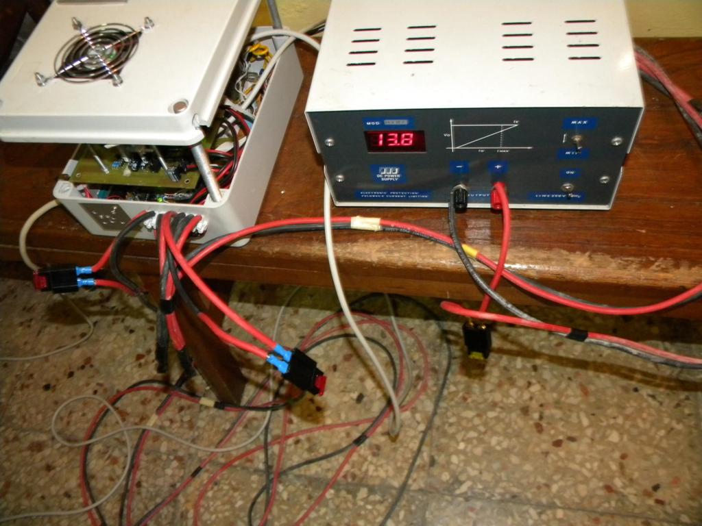

    For food AMC I used a small power supply DIY ac / dc voltage set at about 6 V,> 1 A.
    For the controller (AMC) I think it is important to use power transformer, diode bridge and voltage regulator to have a clean then no switching power supplies. I use a straight 232 serial COM cable (pin to pin) 9-pin. By connecting the cable if youturn off the green LED AMC disconnect and reconnect or reset. If something does not work try to power cycle the power.
    Following what is written on http://www.x-simulator.de/wiki/AVR_Motion_Controller_ (AMC) _by_Tronicgr
    I loaded the 2DOF firmware on ATMega8535 (first test and then to 14 MHz to 18 MHz, both ok, 14 MHz more noisy, while 18 MHz more fluid and precise), then I proceeded to set the values of KP
    (currently KP - mot 1 axis x = 6, KP - mot 2 axis y = 7).
    Later I tried to understand the manuals as 2.0 X-Sim interacts with the game GTR2 and AMC. I use the X-Sim version of the file xsim21013bbeta.zip. X-Sim software Sirnoname - Martin Wiedenbauer and SimBin's GTR2 are installed on one PC with the following features: OS WinXP Professional S_Pack 3, ASUSTeK P5KPL/1600, Intel Core2 Duo CPU E7300 @ 2.66GHz, RAM 3 x 1024 MB DDR2 (PC2-6400), NVIDIA GeForce 8400 GS 512 MBytes).

    Profile looks better now.
    You could minimize the rotation by using support rods like in the Frex design, or by using a stronger U-joint. You could try to find a U-joint from a farm tractor driveshaft at the junkyard for example.

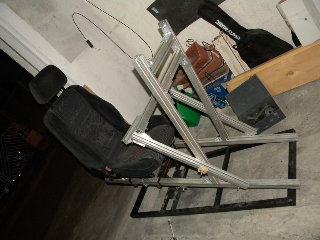

    new: Siki-LUNA Sicilia 2DOF SFGT
    Hi all,
    I'm here after almost two years off ... (home, work and marriage ... time passes).

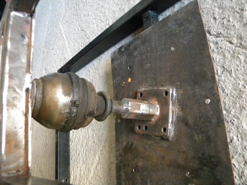

    I decided to place the sim and improve it. Today I recovered a omo-cinetic joint, and soldered the plate ... short photos of what has been done.
    I am happy to be able to climb back on the sim!
    i.e.
    advice about this joint? (the recovered today is very robust ... I sit on it with tranquility)
    will be fine?
    Meanwhile, I try ...
    regards

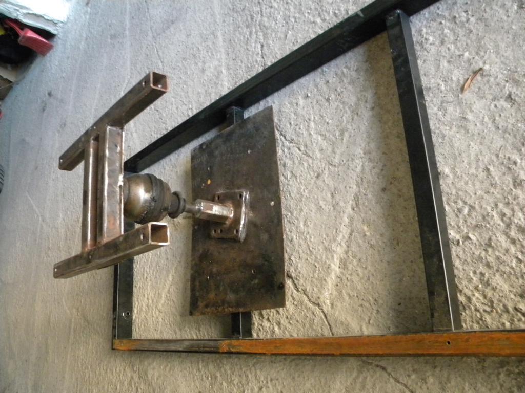

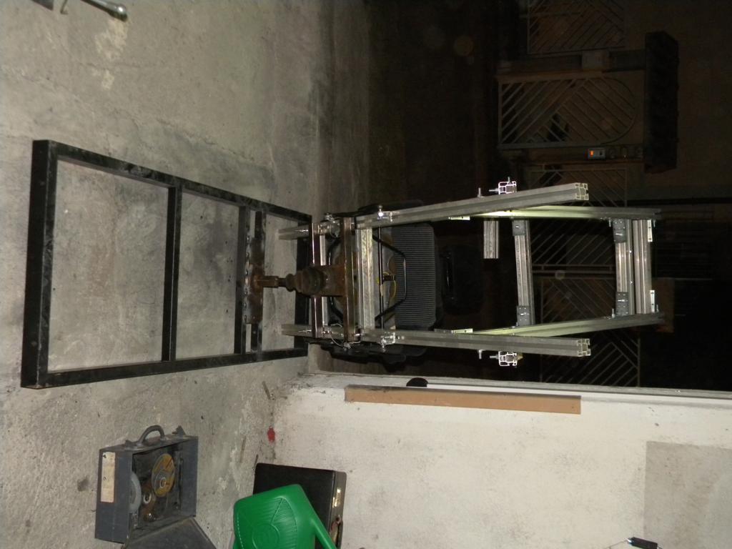

    Hi all,
    here is the work done during the week, I am now looking for the uniball joint at a low price (€ 9 for a head M10 ? ... crazy!)
