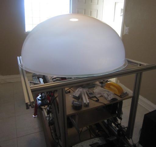

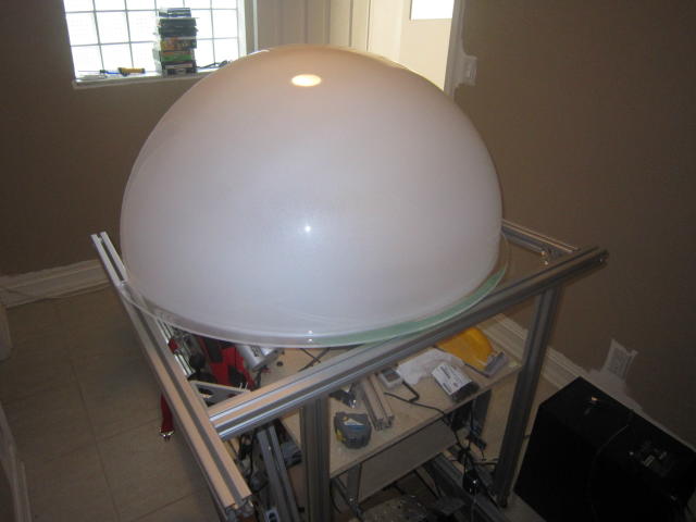

    I got the dome from www.cleardome.com and after cutting it in half I ended up with two 38dia. x 19 high it seemed like a good compromise between the total FOV and the available space I have.

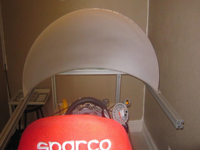

    Using the GOO Paint a sprayed the dome and tried the result by holding it up to my HT PJ and watching images from a Blue Ray DVD the results were better than expected.
    After I mount and test this front screen the next step will be to install the rear part of the screen. I was planning to using a 1/4” or less thick sheet of acrylic curved over my head the same height as the front dome and extending back over my head (36” total length should do it then again using Goo screen paint this will give me the option later to add two more PJ’s for the side view.
    The idea is to encapsulate the driver for a feeling of total emersion; the big idea will be to add two more PJ’s with 3D but as I said that is down the road, as it is cost prohibitive right now.
    The 8020 Extrusions were purchased on fleabay and copying the Frex set up, I hope to attach an actuator to lift and lower the dome. (Although I am still trying to figure out how to simplify the hinge part of the equation) I am trying to achieve this with the minimum amount of parts and wires
    The attached photos are from me getting the dome and the work done so far they are rather crappy due to the fact I took them on my mobile I will have better photos in a few days.

    It’s working? :yippiee: :clap: :highfive: :cheers: Not perfect but better than expected and beter than all my other ideas.
    It needs some tweaking but this is the way to go for that immersion factor! And I say that as after the single 28 Screen, the triple 28 Screens, the three styles of curved screens....... I think I have exhausted most options.
    I am trying to upload a short video on Youtube and it should be ready (Hopefully no errors in 245mins)
    I will go into more detail once the video is published but I am very excited about this project…. and 3D for Christmas if the Grinch/ Santa/Wife agrees to buy me shutter glasses!!!!!!!!!!!! and I get the TrackIR working.
    I could however just buy a race car for the money this has cost me.

    Is the dome too small? Great question, I have used it for a few weeks and think I WANT BIGGER!
    I used to have a 96 X 36 curved screen and that is big but still it looked small after a week or two.
    I guess it is all down to the driver preference, the size I have now works great and leaves the option of adding the overhead enclosure but do I want a bigger dome ......yep
    I am working with a company out of Texas for a P95 Acrylic (this will not need painting) 60 X 30 Dome then with the concept of adding a overhead cockpit and two more beamers, I think this will be big enough, for a few weeks. As a side note, they will cut the dome in half so I am looking for a partner to take the other half any takers???? just 50% of the cost of the dome and shipping to your place.
    The distortion on the edges it dealt with using Nthusim, I have thread running on that site regarding the issues of getting an acceptable image, as it is a challenge due to the exreem shape.
    Then once you have warped the hell out of the image foe the dome the image on the monitor is useless due to the extreem distortion.
    I am hoping for a response from the R&D at Nthusim on how to just get the correction on one screen and leave the other (Monitor) unaffected
    The trailing edges of the image are the hardest as one the projector cannot project around the dome to the bottom corners edges, yes two PJs will work much better but you can live with one as the Image spread is good over 95% of the dome.
    There is no issue with sharpness, it is not LCD crisp but as good as any projected image you can get, due to the short throw distance from the PJ to the dome surface.
    I have asked Santa (the wife) for a second PJ but listening to the arguments I do not know if it is worth it. Dome Front 1.JPG
