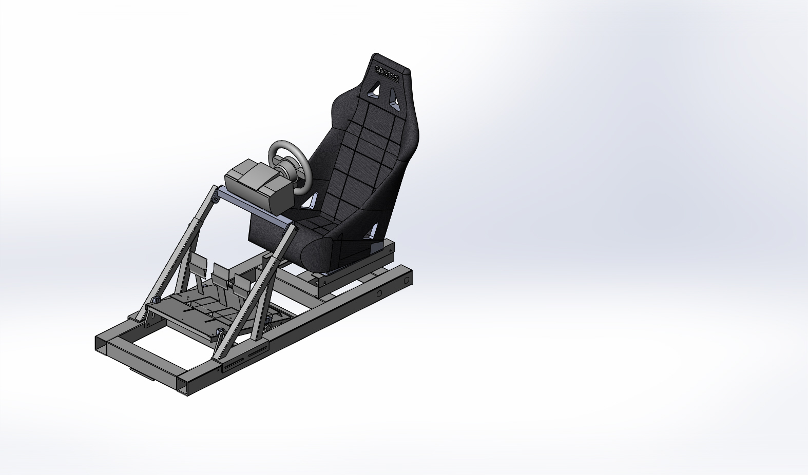

    I'm Starting an new Sim Project and have t say its amazing how much info and helpful everyone is, so hope I can give back some.
    Ultimately it will be 2dof with Traction loss. nothing new here except how I am doing the build. Since I want traction Loss and the whole frame needs to move side to side I'm building the frame out of 3" alum Box tubing. The size makes it really stiff and still fairly light weight. I probably would have done it with smaller alum tube like 2" x 3" but I had this in stock from an old project so that's what its getting.
    The frame is designed so I can add to it as time permits. So the basic frame as shown below has bungs built into the sides so I can add a rear section to it for the actuators and electronics. As shown I wanted to be able to use it as a fixed Sim Base while I worked out the electronics package as time permits. I will post more models once I sort out the best way to do this.
    One thing I wanted to cover was make it very adjustable sine the seat will basically be non adjustable I wanted a large range for the steering and brake pedals. I have friends I an sure will want to try that range from 5'2" to 6'2" so hopefully there is enough adjustment to accommodate everyone by just listening a few knobs and sliding things around.
    I will post more models once I sort out the best way to do this. I did everything in Solidworks so not sure if just converting to Jpegs is the best or PDF's.

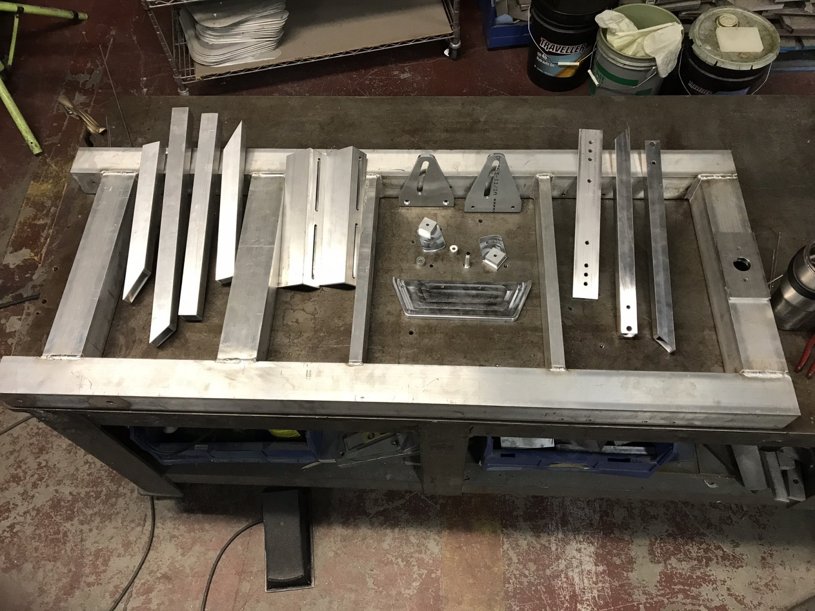

    3C1470AF-D040-4950-B379-BAFB7A48B2AE.jpeg Ok here’s my kit of parts. Base is welded but still have some stuff to do to it. The big hole on the right is for the nose pivot for a pillow block for the traction loss. Most of the other parts are for the steering system and the pedal tray.

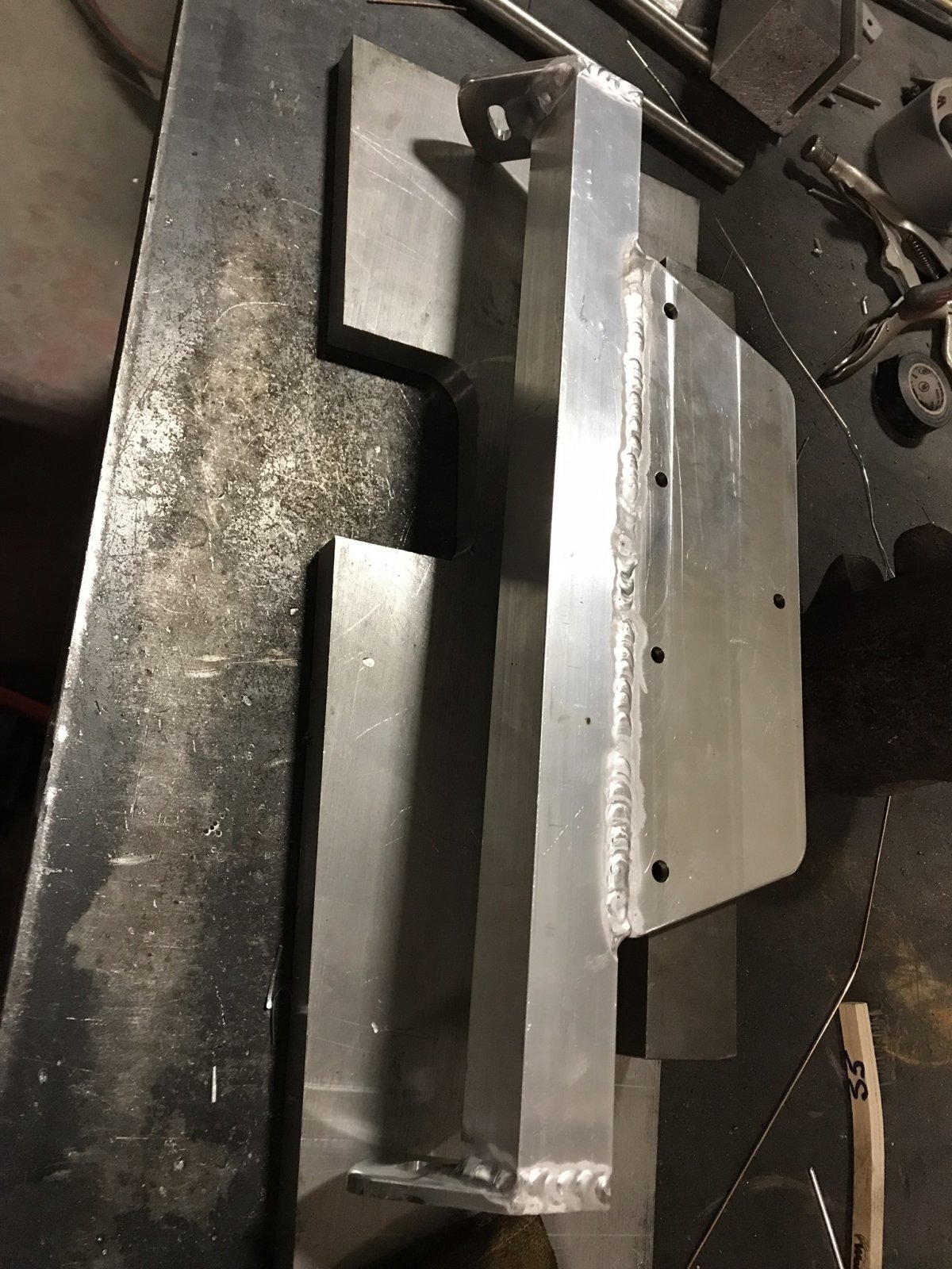

    This is a quick shot cutting the backside of the steering baseplate.

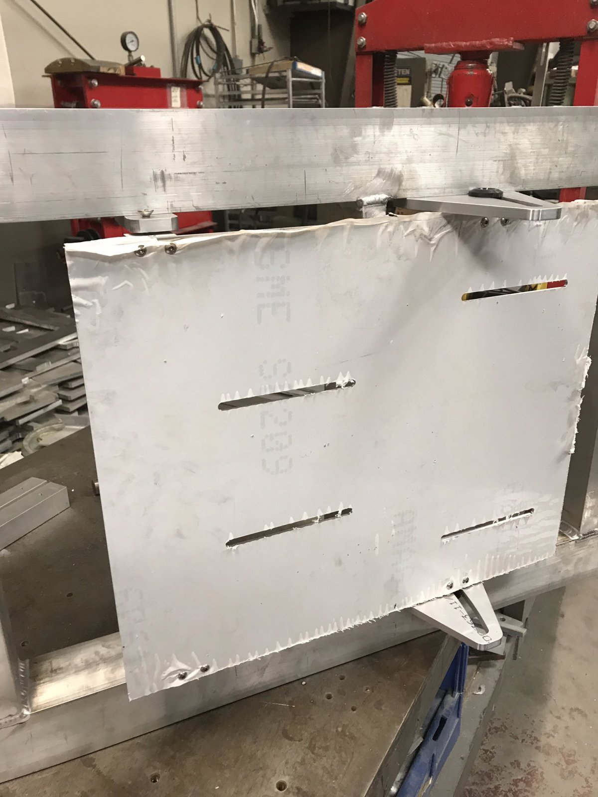

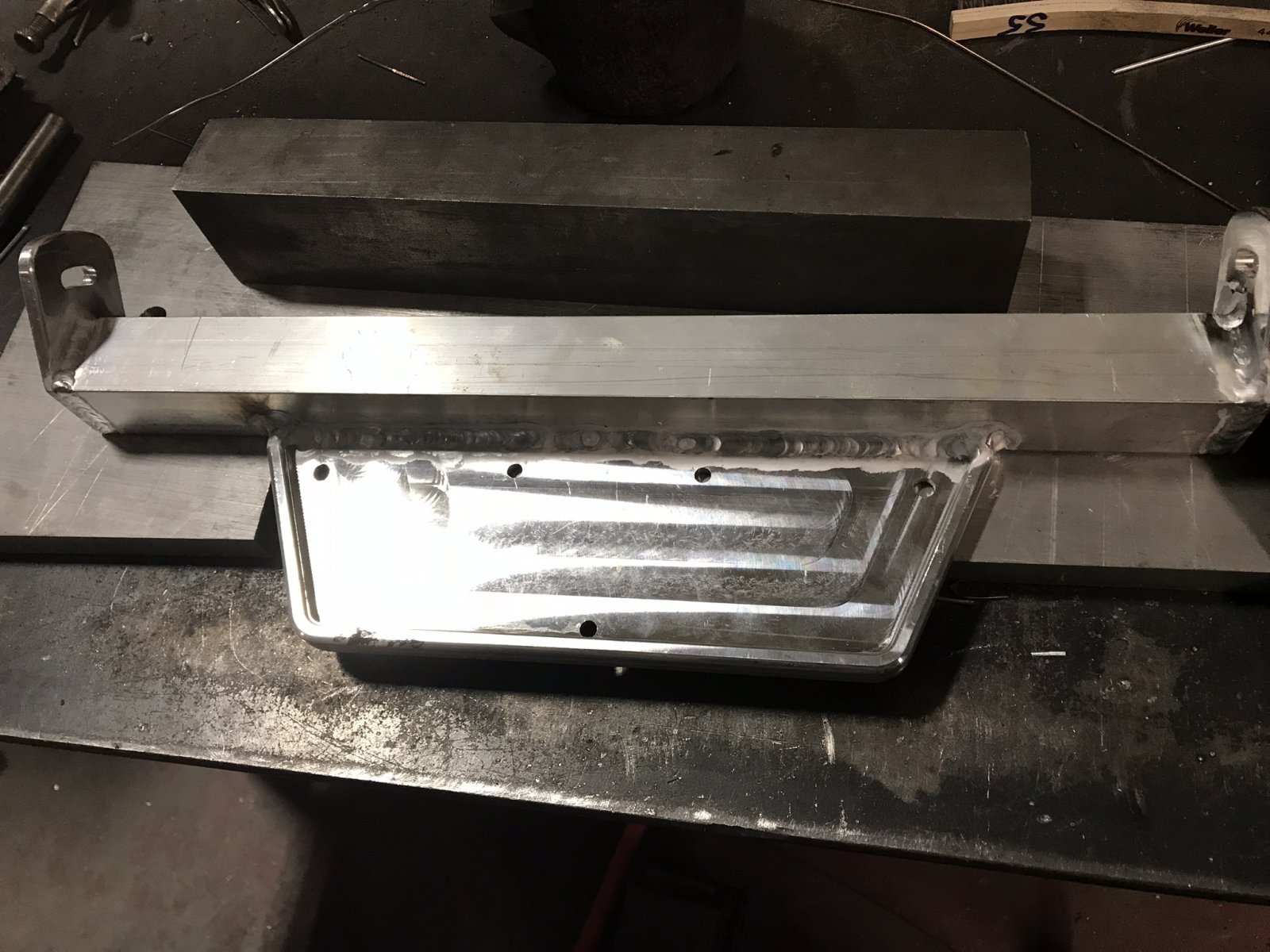

    A634B788-6C1D-4489-952C-0CB07AF1AEB1.jpeg This is the topside of the brake base plate. It tills and can be mounted 4” forward or rearward. You can also tilt it from flat or tilted. I mounted it separate from the steering base so they can be moved independently. Not sure if this is the best idea, but I wanted lots of adjustment. The pedal Assy can also slide forward or back with quickrelease handles.

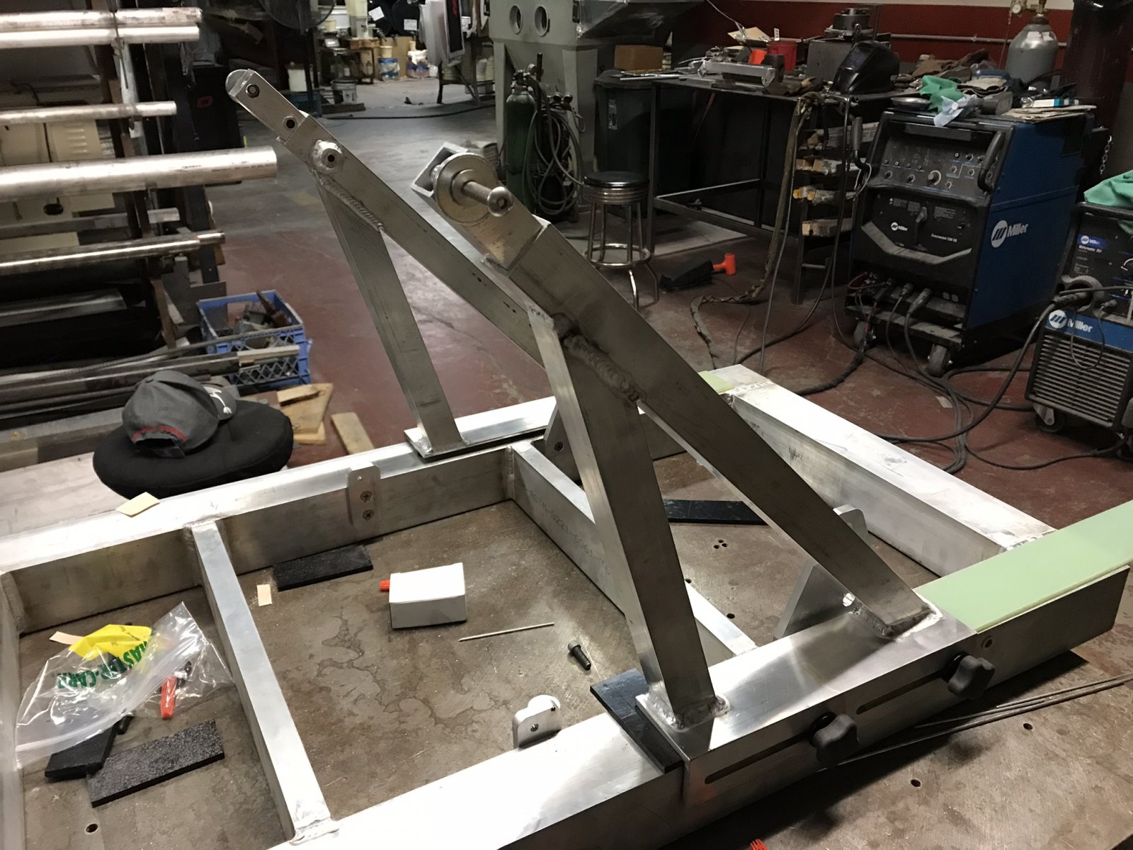

    This is the base for the steering assy. The knobs on the side clamp the base to the frame. Behind them are roller bearings that the base slides on. Originally I just cut slots for the thumb screws and as shown worked fine. Then when I mocked up the rest of the base with the wheel base attached the weight from it cantalivered or tipped the base forward and bound up on the thumbscrews. So it didn’t slide very well. Thus the bearings.
    I thought about using seat slide or drawer tracks for the sliders but wasn’t sure how much slop there would be. Any feed back on that from anyone? I’m pretty sure I’ll be doing another one in the future and I’m always open for change. A71758CB-CA2B-4D38-B512-71C79843B36E.jpeg

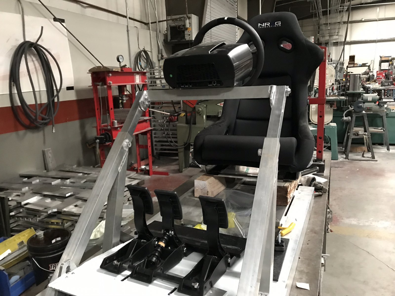

    First mock-up. With pedals, wheel base and seat.
    Since I’m starting out with it as a fixed base but converting to 2dof the seat position is fixed. So it needed to be in the same position that it would be with the universal joint under it. So I did my best guess calcs to get the pivot point on the btm of the seat so it would be neutral to rear bias if needed in the point I wanted on the base.
    Since I used a generic seat model for my drawings I wasn’t sure how close I’d be to my cad modeling. All in all it came out pretty close and is within the range I needed for everything to feel comfy and lots of adjustments for shorter and taller people. D13337F9-5029-456F-B8DE-C95D363F8F17.jpeg
