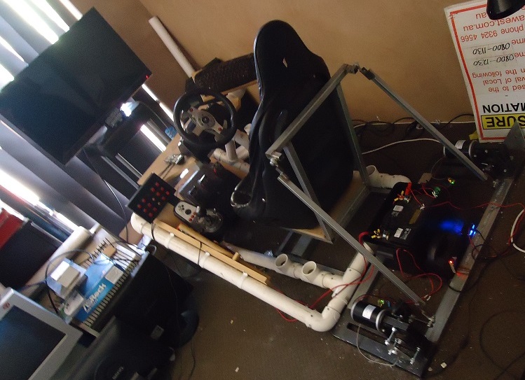

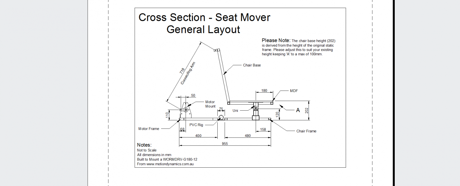

    My rig has been improved heap since photo. Had an existing simul8or PVC rig design from the insidesimracing website and decided I wanted motion in the Rig so I designed a simple cheap seat mover frame and use Jrk12v12 with 12v 200W motors, I'm a feather weight and she throws me like a rag doll and sons a lot bigger than me , damit, and it does the same to him without a worry.
    For use for flight you can remove the front deck which has the Wheel etc in it, and stand the frame separately, I have been using it lately to test the flight plugins for SimTools. I was surprised on how effective it was. Just needed two mounts on the side for flight stick and throttle and rudder pedals sit on the ground in front of you, all infront of my overhead projector and yea , not bad at all.
    I do have most of the cad drawings needed to build the motion part if needed, welcome to copy or use as a base.
