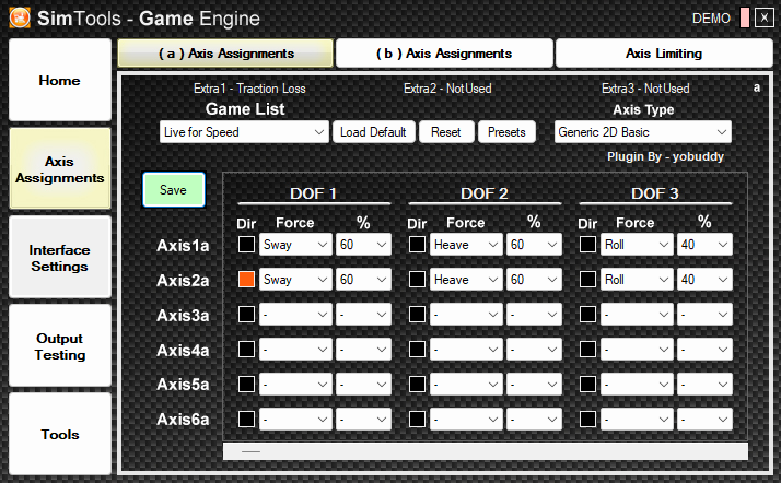

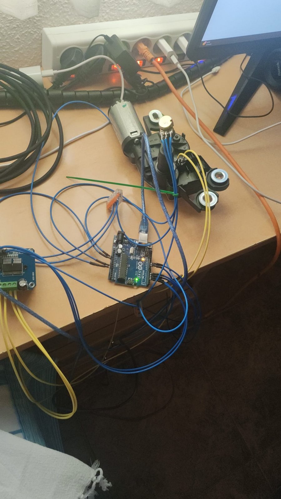

  5. Yenavern
    Yenavern New Member
    Aug 12, 2025
    20Coins
    Yes, I patched LFS with GameManager, and that one conect with Game Engine, I can see that red square turn in to blue.
    Maybe need to detect all the potentiometer?
    I Attach a photo of what I have
    21,713
    151,923Coins
    +11,061 / 56 / -2

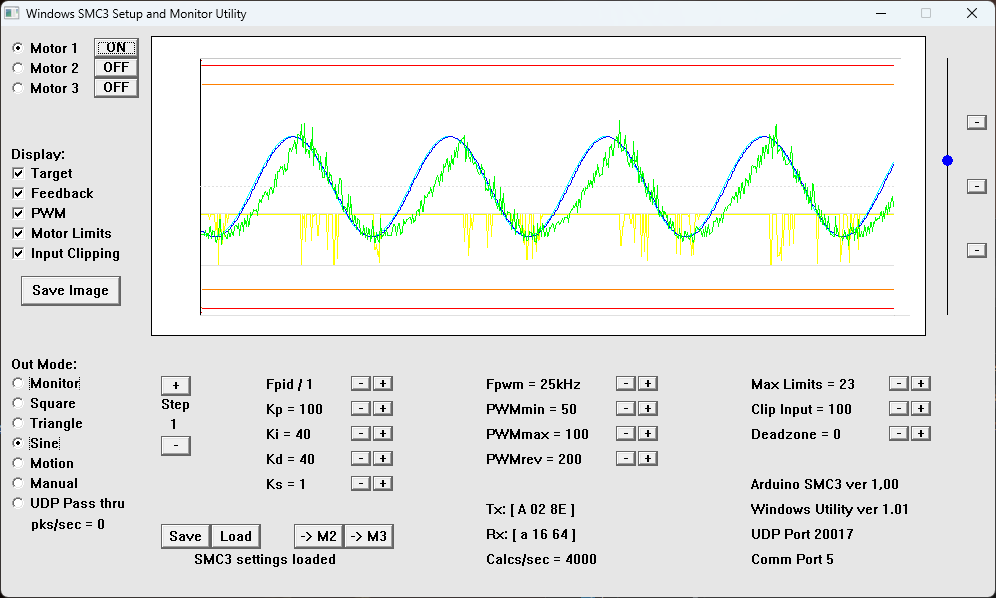

    Can you please post a picture of SMC3 running the Sine test.
  7. Yenavern
    Yenavern New Member
    Aug 12, 2025
    20Coins
    Yes, here is the picture:
    Shakes a lor because i don't have the best joitn, is just tape for the test.

    20Coins
    Thank you, finally works.
    I think that the problem was in potentiometer, because when it goes to 0% or 100%, all gets down.
    Some times, when potentiomer shakes goes to 0%
    I change the potentiometer and all is working.
