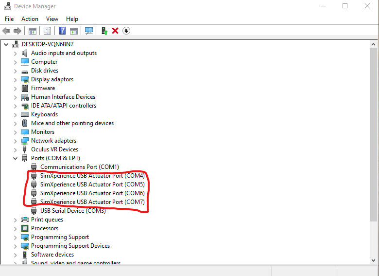

    Hi everyone im new here and need your help.
    I am having problems trying to get motion out of my SimXperience stage 2 SCN5 Acuators in the Game Engine App.
    What is happening is: in Windows 10 device manager on the Ports (COM & LPT) section it shows as follows when usb cable is plugged in:
    Communications Port (COM1)
    - SimXperience USB Actuator Port (COM4)
    - SimXperience USB Actuator Port (COM5)
    - SimXperience USB Actuator Port (COM6)
    - SimXperience USB Actuator Port (COM7)
    USB Serial Device (COM3
    And when unplugged it shows the following:
    USB Serial Device (COM3)
    My issue is i am only running 2 actuators but it is detecting 4?
    The usb cable is connected to the SimXperience SX4000 control box where the 2 actuators are connected to and maybe thats what is causing the problem.
    So when in the Sim - Tools Interface Settings regardless of what Com port number i try to assign it to i get nothing, no motion whatsoever and dont know what to do anymore.
    If any of you have the same kind of setup please advise me on what to do.
    My apologies if this has been posted before.
    Please help. Thanks

    As I remember It is detecting ALL Simxperience Ports. The 3000 box has 3 ports and the 4000 has 4 ports and all are shown. You have to "try an error" find which ports belong to the motors you have connected. Dont worry, You will find the ones connected and simtools will do the magic with them

    @noorbeast and @hideki thanks for your help guys it’s much appreciated.
    Got it all working now, ended up being ports 6 and 7 that needed using for Simtools.
