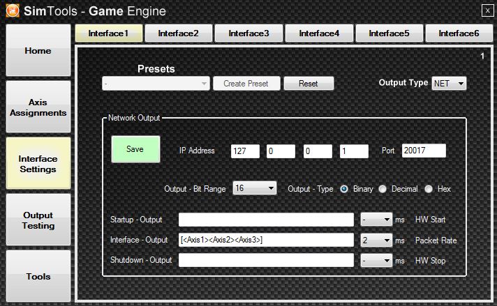

    Step 7 – open Simtools Game Engine and goto a new “unused” interface tab
    Step 8 – setup for NET interface, enter the IP address of the computer running MotionTracker, use 127.0.0.1 if on the same computer. You can also use 192.168.1.255 to broadcast to all 192.168.1.xxx IP addresses.
    Step 9 – Enter UDP Port 20017 (unless changed in motiontrack.ini)
    Step 10 – Set for 16bit binary output
    Step 11 – Output string [<Axis1><Axis2><Axis3>] and set 1ms delay.
    Step 12 – Save the settings
    You MUST include all three Axis in the output string even if you don’t use 3 axis. If all goes well, when you now run a game the MotionTrack should show approx. 500 pkts/sec UDP data in the bottom left of the screen. You should also see the “Target” traces on the screen moving as you drive round the track.

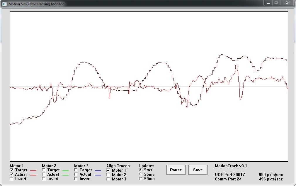

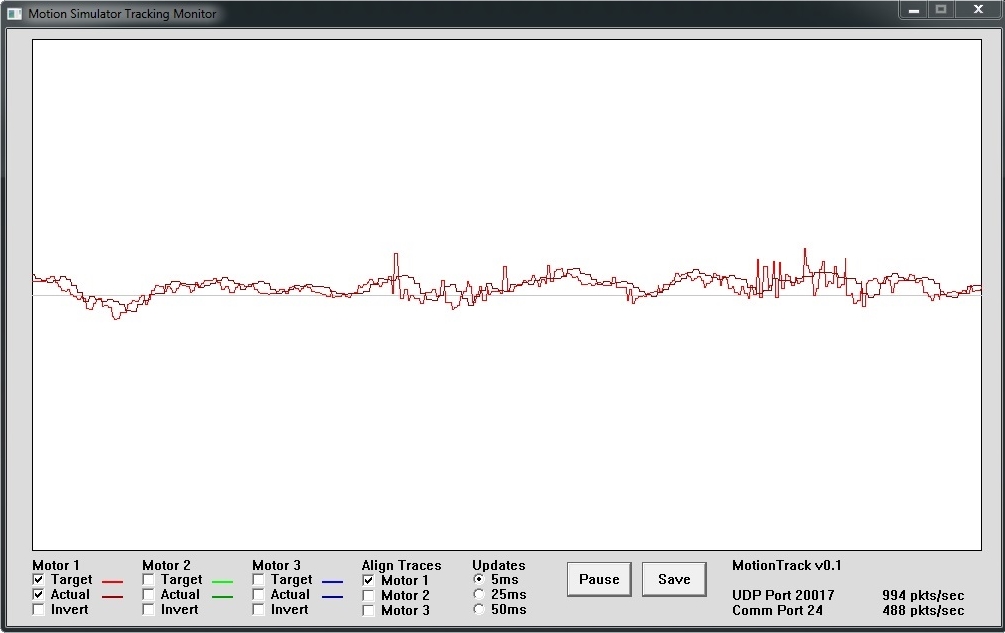

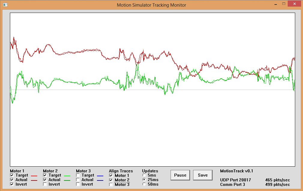

    Definitely sabertooth + kangaroo is not made to operate a racing sim. (good for a flight sim but not a racing sim!). When I replaced my S+K by my MM+Arduino (SMC3), the difference was huge. Sabertooth works fine but the response time is too slow. I've never been able to feel the little bumps as with my MM. Here are some images that speak for themselves.
    With MM on a F1 at Spa.:
    MM again at Spa :
    and now sabertooth :
    Thanks @RufusDufus for your digital scope ! :thumbs
    Eric
  10. RufusDufus
    RufusDufus Well-Known Member
    Jul 21, 2013
    681
    Adelaide Australia
    16,508Coins
    +1,018 / 10 / -1
    @ericRacer, the MM looks like it is setup very well. :thumbs A great example of how well they can work!
    The sabertooth looks like something is not working? more like it is just producing random shaking than actual motion tracking?
    Good to see someone using the software... The reason I made this software is so anyone can see how well there setup is performing which is useful if you have never tried anyone else's for a comparison. I suspect there are alot of sim users out there that could tweak there setups to get better results?

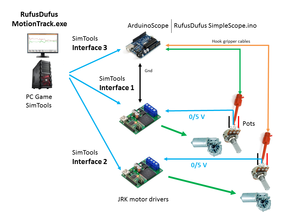

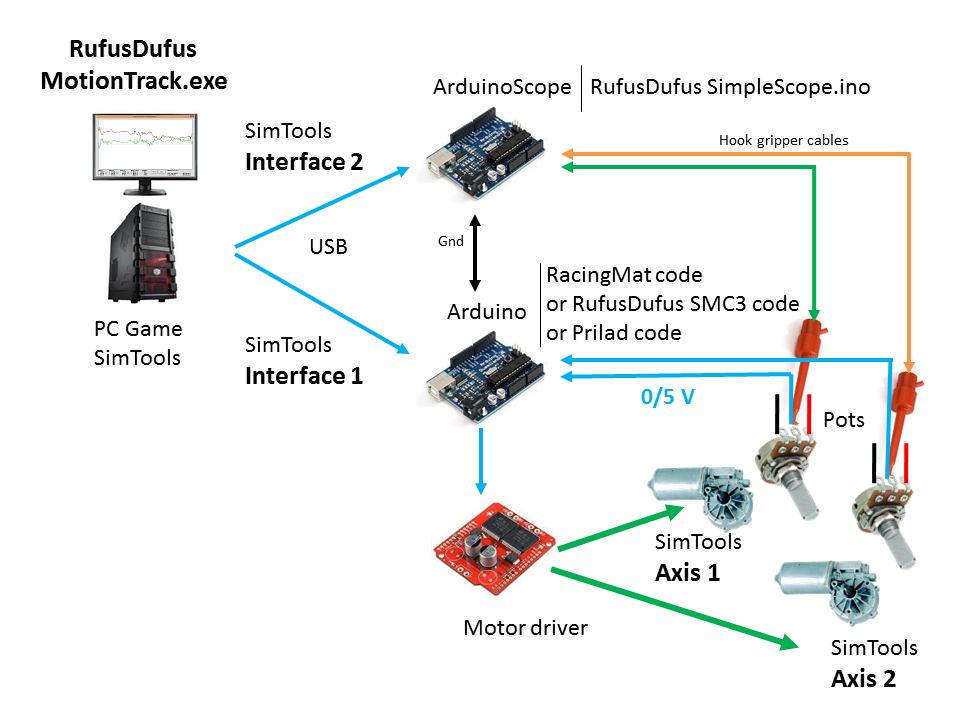

  14. RacingMat
    2,234
    21,094Coins
    Here are some pictures to illustrate the connections:
    Arduino:
    or JRK wiring:
    @RufusDufus : is it correct? :)

  16. ericRacer
    Jun 11, 2009
    251
    Pilot
    Canada, Quebec
    922Coins
    +147 / 2 / -0
    @RacingMat
    nice work and well done. :thumbs
    But I wonder why you drew the + 5v. between 2 Arduinos, I do not see the utility of it :confused: they are already connected via the usb cable and gripper cables needs only the ground.
