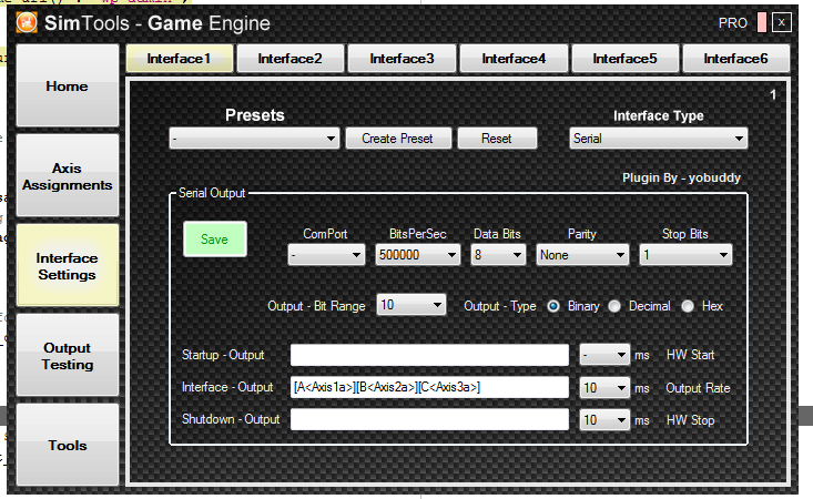

    Hello.
    I bought one SV-3TL and one SV-2 from NJMotion.
    It took time to assemble the whole product without a guide, but I did it anyway.
    But I do not know how to connect Simtool.
    I asked him, but he does not come back.
    What should I do?

    Hi @kjjcard
    these are my Game Engine Interface Settings:
    @NjMotion Can you make sure that he get the needed informations?
    Cheers

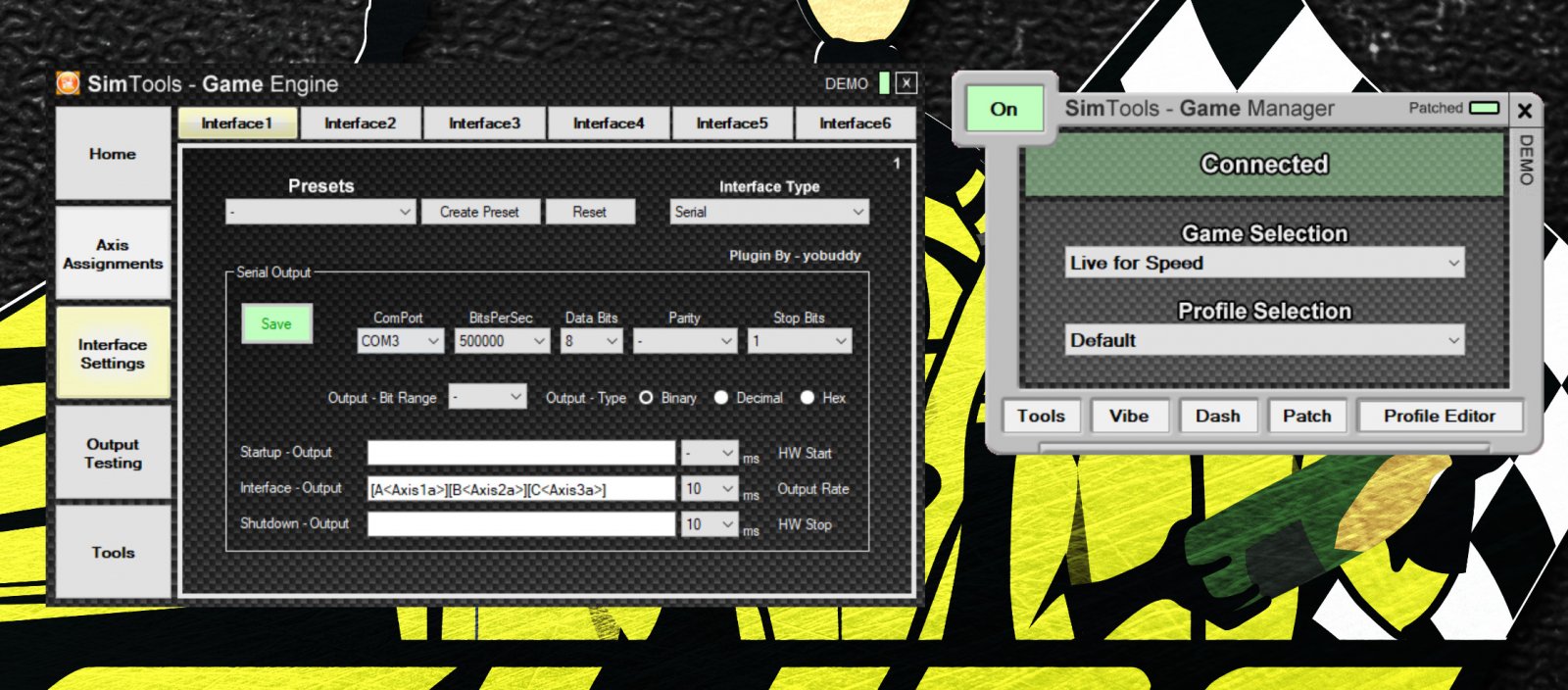

    I have the same problem,
    1. Computer recognised the COM3 connected via USB, the Rig auto moved to center the first time I connect it to to the powersources
    2. IP Setting was the same between Simtool Game Engine and Simtool Game Manager (I edited it)
    3. I have set the Axis Assignment in the GE with 3 Axis 1a, 2a and 3a
    4. I have set the Interface via Serial and exactly the same the image above.
    5. I CAN NOT test the output.
    Can I anyone help?

    You need to set Output Bit Range to 10.
    Parity to None.
    You should not need to edit the IP.
    As an aside LFS needs to be run before patching it for motion: https://www.xsimulator.net/communit...run-in-first-person-mode-before-patching.365/

    Parity should be set to None.
    Output Testing should work as expected before messing with any game.
