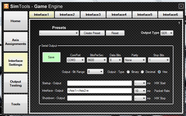

    hey guys im in the final stage of my simulator 2 dof plataform, i need your help one more time.. i didnt found much information so here is
    i got this
    arduino R3( prilads firmware) all works good with xsimctrl..
    the problem is simtools connection.. i cant make simtools to move my motors..
    u know when i press the output testing in simtools a orange led turns on in ard, if i run game this led blinks semms that its getting data information but no movement on motors
    ive try a lot of combiantions setting and nothing,, im not very familiar with simtools.. i read the documentaion and treads 10x lool
    if i must put some values in startup output/shutdown what shoud be and how to find the correct values? sorry if it has be aswared in some thread i really didnt found much information what could be the problem? cheers!!

    Hey thaks earobie u have helped me in the past and now. Ive try the string u gave to me, okay i have connection.. But it moves a bit, very very few movements, if i slide the slider quicly it jerks the simulator,, but only it nothing more... Any more sugestion?

    Its working, sorry, i just change from hex to binary, all working now, woooww thats so cool thanks man
