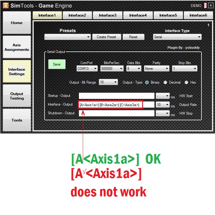

    What am I doing wrong?

    Next time please post pictures, it is much easier to see settings than a moving video.
    There seem to be spaces in the Interface settings, copy and paste this: [A<Axis1a>][B<Axis2a>][C<Axis3a>]
    Do not run SMC3 and SimTools at the same time, it will cause a port conflict.
    Of course the pot should be properly secured.

    New Everything worked as soon as I removed the spaces between the characters, it turns out that you have a misspelle line on the forum that the newbie copies and does not get the desired result, correct.
