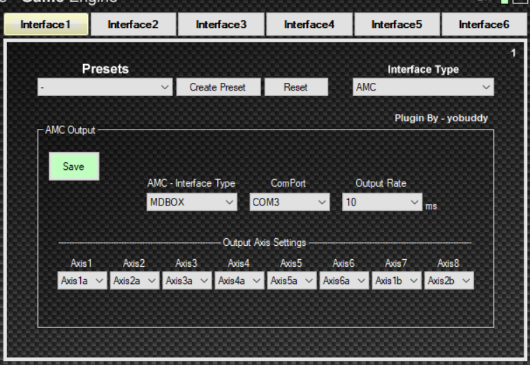

    I'am i new simtools user dealing with a simulair KERNELBASE.dll issue, that is why I react to this thread. I am using F1 2020 as simulation software with simtools v2.5. I have motion while playing F1 2020, but sometimes simtools (and the motion) stops working. After restarting the PC it works fine again until the next error. Also I'am using the AMC-box to communicate with the actuators. Sometime it takes 1,5 day for the error to occure and another time it occures two times in a morning.

    Hi Buddy,
    This tells me that the interface is probably dropping out.
    Maybe a bad connection or a loose usb cable?
    What output rate are you using for the AMC?
    Maybe set it to 10ms for a test and try again.
    Take care,
  10. VTD
    VTD New Member
    Feb 4, 2021
    13
    49Coins
    Hi yobuddy,
    Thanks for your reply. First I checked the USB connections again with treeviewer. I noticed that the usb for the AMC box was shared with other usb devices. So I reconnected the USB cables so the AMC was alone on a usb controller. It worked al good, until this morning again. The motion just cuts out during racing. But I didnt got any error massages this time.
    I used the standard output rate for the AMC box (2ms). I will try it again now with 10 ms and I will see how that goes. I will report again after I tested this setting.

    I tested the setting today and it seems that a different usb-port solved the last error message. But unfortunate I still getting errors, but a different one this time.
