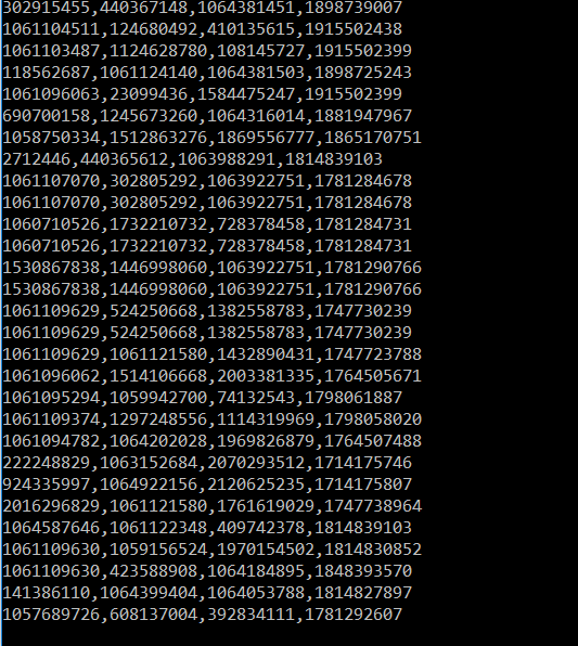

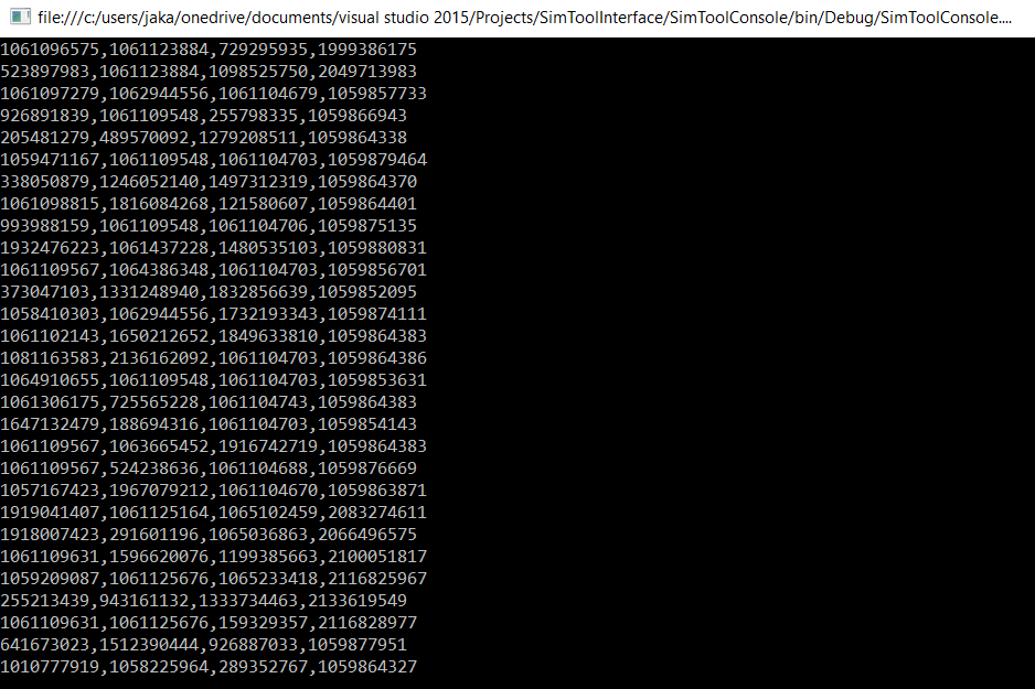

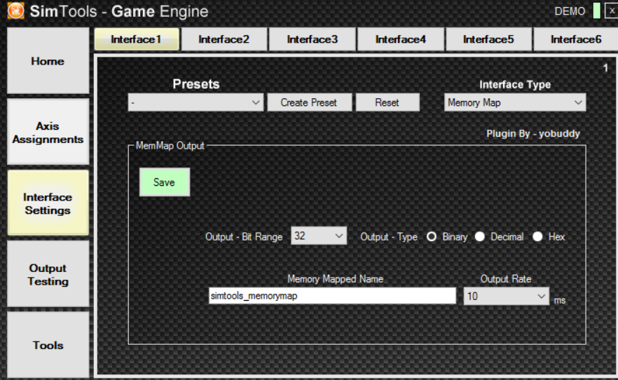

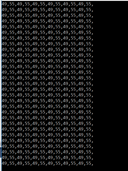

    I have a problem with memory map not writing sensible data to the memory map. Has anyone got memorymap working?
    My setup:
    Output seems OK
    This is what I recive on the other side from memory map
    <code>
    mmf = MemoryMappedFile.OpenExisting("simtools_memorymap");
    MemoryMappedViewAccessor accessor = mmf.CreateViewAccessor(0, 128, MemoryMappedFileAccess.Read);
    int fl = accessor.ReadInt32(0);
    int fr = accessor.ReadInt32(4);
    int rl = accessor.ReadInt32(8);
    int rr = accessor.ReadInt32(12);
    Console.WriteLine($"{fl},{fr},{rl},{rr}");
    </code>

    Hi @telesimke,

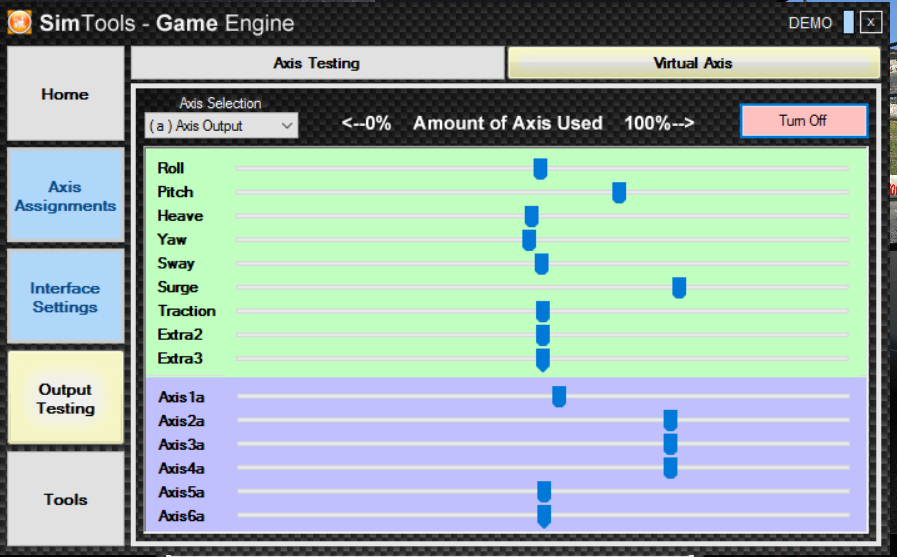

    For testing purposes, will you please set your Output - Bit Range to 8 bit.

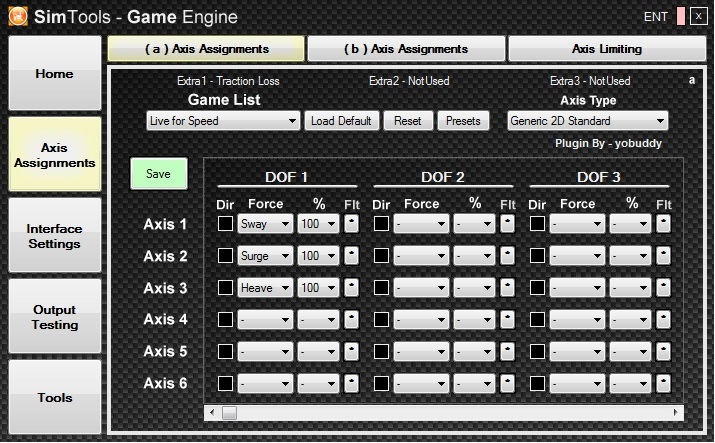

    And please set your axis mixing like this.
    This way we are just sending the output of one dof and It will be easier to see what's happening.
    Now run the test again and see what you get buddy!

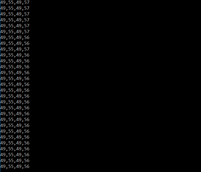

    I did like you asked and also set the Axis limiting to 8, 20 and 50%. The output still does not reflect actual forces
    I changed the accessor read to "accessor.ReadSByte(0);"
    BR

  6. telesimke
    telesimke New Member Gold Contributor
    Feb 25, 2017
    10
    Slovenia
    42Coins
    Hi!
    Here is the output from 8bit decimal with the car not moving(output is showing slight movement of the axes) and all 12 axes are being read.
    br

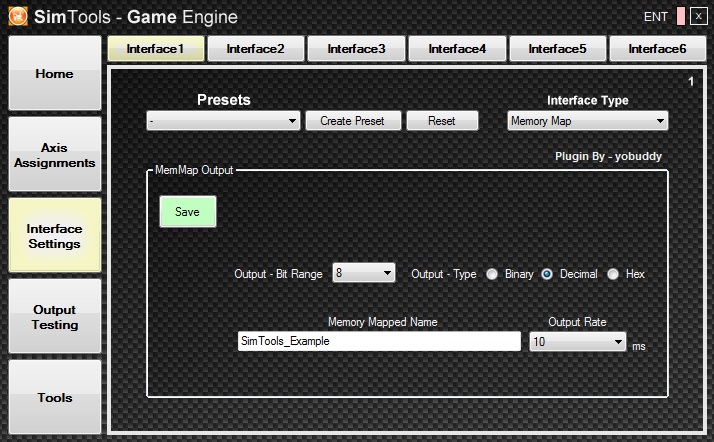

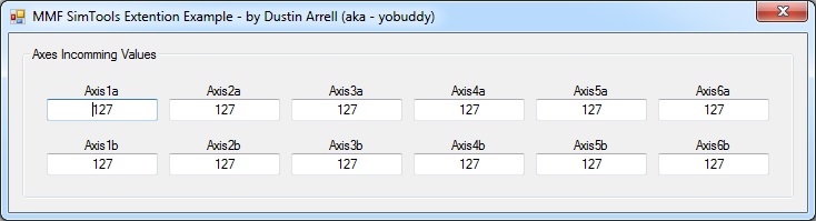

    So lets try this with an example, I think it may be easier.

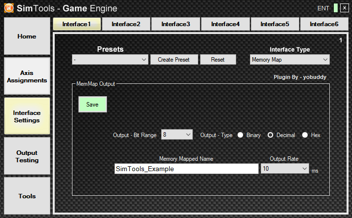

    First Setup an output like this.
    Now you can use my Memory Map Example App to get you started.
    Please set this thread to resolved should this get you going buddy
    Hope this helps!
    Download the Starter App Here:

    I did all my testing with Axis1a included.
    I did not see any problems.
    Please show me how to reproduce the error your seeing, or I have no way of even being able to look at the problem you are seeing buddy.

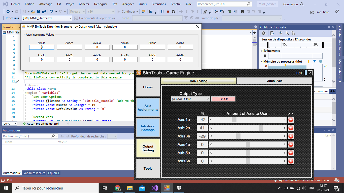

  11. smallmadtv
    smallmadtv The Astrophotgrapher Gold Contributor
    Dec 23, 2020
    10
    Tech Manager
    Belgium - Sambreville
    100Coins
    2DOF, 3DOF, Arduino, 4DOF, 6DOF
    Hi I just download Visual Studio and try to compile it.
    But when I run the app, I don't have any number displayed.
    See here:
    this is my setup:
    Any idea, where I can find the file? Maybe I need to store the app in a specific folder? like Simtool?
    Thx for any reply!
    FYI, this is just a casual investigation on the different interface type...
