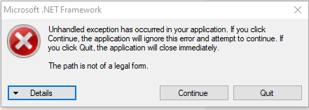

    Hey all, I have been happily and comfortably using SimTools for several months now with no issues at all. Today I decided to download the Xplane11 plugin and give it a try.
    I ran the SimTools PluginUpdater, it updated successfully.
    Then I opened Game Manager and got a .NET Framework error. "Object reference not set to an instance of an object." aaaaannnd it was broken.
    Details:
    Code:
    System.ArgumentException: The path is not of a legal form.
       at System.IO.Path.LegacyNormalizePath(String path, Boolean fullCheck, Int32 maxPathLength, Boolean expandShortPaths)
       at System.IO.Path.NormalizePath(String path, Boolean fullCheck, Int32 maxPathLength, Boolean expandShortPaths)
       at System.IO.Path.GetFullPathInternal(String path)
       at System.IO.DirectoryInfo.Init(String path, Boolean checkHost)
       at System.IO.DirectoryInfo..ctor(String path)
       at SimTools_GameManager.frm_GameManager.If_StartWithWindows_Checked()
       at SimTools_GameManager.frm_GameManager.frmMain_Load(Object sender, EventArgs e)

    i have similar problem, on my wife laptop work very well, but on my gaming computer I can't start it. I try reinstall net framework. tool for repair find nothing. its a log:
    See the end of this message for details on invoking just-in-time (JIT) debugging instead of this dialog box. ************** Exception Text **************
    System.ArgumentException: The path is not of a legal form. at System.IO.Path.LegacyNormalizePath(String path, Boolean fullCheck, Int32 maxPathLength, Boolean expandShortPaths) at System.IO.Path.NormalizePath(String path, Boolean fullCheck, Int32 maxPathLength, Boolean expandShortPaths) at System.IO.Path.GetFullPathInternal(String path) at System.IO.DirectoryInfo.Init(String path, Boolean checkHost) at System.IO.DirectoryInfo..ctor(String path) at SimTools_GameEngine.frm_GameEngine.StartWithWindows_Checked() at SimTools_GameEngine.frm_GameEngine.frmMain_Load(Object sender, EventArgs e) at System.EventHandler.Invoke(Object sender, EventArgs e) at System.Windows.Forms.Form.OnLoad(EventArgs e) at System.Windows.Forms.Form.OnCreateControl() at System.Windows.Forms.Control.CreateControl(Boolean fIgnoreVisible) at System.Windows.Forms.Control.CreateControl() at System.Windows.Forms.Control.WmShowWindow(Message& m) at System.Windows.Forms.Control.WndProc(Message& m) at System.Windows.Forms.ScrollableControl.WndProc(Message& m) at System.Windows.Forms.Form.WmShowWindow(Message& m) at System.Windows.Forms.Form.WndProc(Message& m) at System.Windows.Forms.Control.ControlNativeWindow.OnMessage(Message& m) at System.Windows.Forms.Control.ControlNativeWindow.WndProc(Message& m) at System.Windows.Forms.NativeWindow.Callback(IntPtr hWnd, Int32 msg, IntPtr wparam, IntPtr lparam) ************** Loaded Assemblies ************** mscorlib Assembly Version:

    Seems to be having a problem with a path?
    The path is not of a legal form...
    How are you getting this error buddy?
    At launch, install?
  8. miaziol
    miaziol New Member
    Dec 20, 2020
    29
    Poland
    - 77Coins
    +13 / 0 / -0
    at launch when I hit ignore program start, but I can't make anything.
