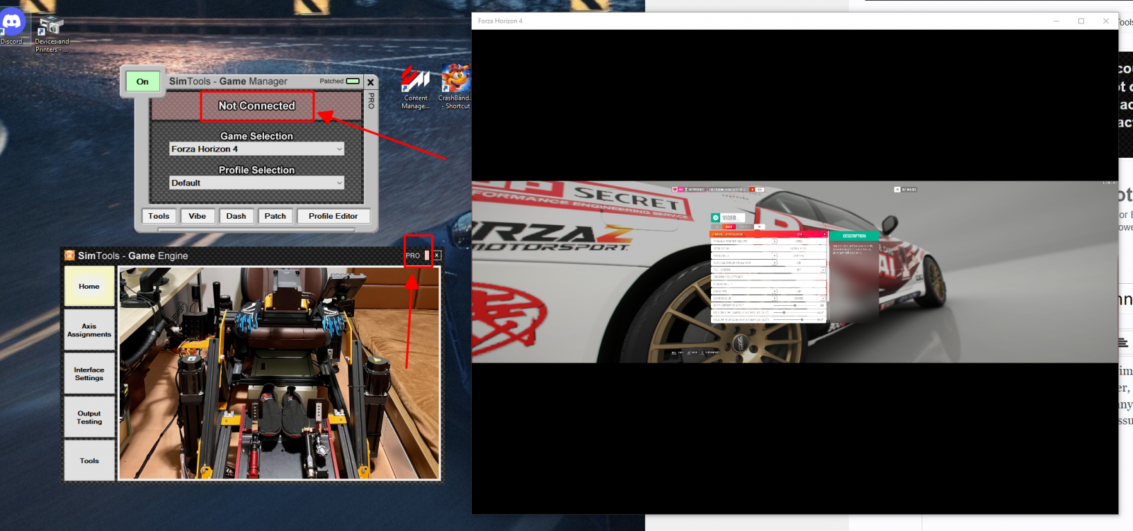

    Hi every one, I don't understand why my SimTools is currently not functioning and displaying a "Not Connected" error as shown in the image. However, when I try the "output testing," the degrees of freedom (dof) still work properly. They used to work fine in any game I had installed and played before, but now they don't function in any game. Please help me with this issue. upload_2023-8-13_22-15-28.png
    PS: Previously, before installing the AC Mod, I was using my DOF normally. This issue only started from the day before yesterday.
    Thank all

    If you have installed a mod that in any way messes with game telemetry that may interfere with a plugin, but if the issue affects multiple games it is more likely that something is interfering with communication, often that is antivirus or firewall, so temporarily disable those and test.

    Did the IP addresses get changed in either app?
    Under the tools button, the ip address for each app should be 127.0.0.1 when used on the same PC.

    Thank you, Youbuddy. Indeed, the IP address on my simtools has been changed to 192.168..., and when I set it to 127.0.0.1, everything is working fine. I appreciate your help very much

    Thank you, I tried following your and Yobuddy's method, and everything is working fine now.

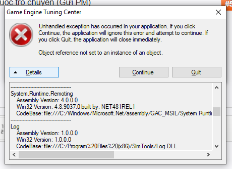

  6. kiennt
    kiennt New Member Gold Contributor
    Dec 17, 2022
    18
    - 100Coins
    4DOF
    I am currently getting the NOT CONNECTED error as shown in the image. I had previously added the WRC10v1, WRC2023, and WRCGenerationv4 plugins, which I downloaded from the simtools website. Thank you!
    Detail:
    System.NullReferenceException: Object reference not set to an instance of an object.
    at SimTools_GameEngine.frm_TuningCenter.LoadGameList()
    at SimTools_GameEngine.frm_GameEngine.frmMain_Load(Object sender, EventArgs e)

    What version of SimTools are you using v2 or v3 Beta?
  8. kiennt
    Dec 17, 2022
    18
    - 100Coins
    4DOF
    I’m using v2
    20,710
    146,110Coins
    +10,809 / 52 / -2
    You can't use v3 Beta plugins off the simtools website with SimTools v2, they are incompatible.
  10. kiennt
    Dec 17, 2022
    18
    - 100Coins
    4DOF
    Oh, I understand. Does SimTools v3 currently support all games as v2 does, so that I can upgrade to v3?
    20,710
    146,110Coins
    +10,809 / 52 / -2
    Not yet, but you can install v2 and v3 on the same PC and use the same license for them.
