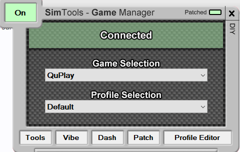

    Recently I have been trying to be able to connect Unity through Simtools to move a servo on an Arduino. I am trying to make this work with the Quplay plugin and Unity project found here: https://github.com/ddkclaudio/QuplaySimTools
    After testing it seems that no matter what random values I send to the Arduino it will not move the servo. I have verified that the servo works in Simtools using the DOF testing in GameEngine. Additionally, I have verified using the tuning center that Simtools is only registering recieved packets on some occasions. I am not sure why this is occuring but it seems to be random when the packets go through. Even when the values are being registered the servo does not move. Any assistance would be fantastic I am not sure how to go about fixing this issue. My Simtools is running the correct plugin and is registered btw.

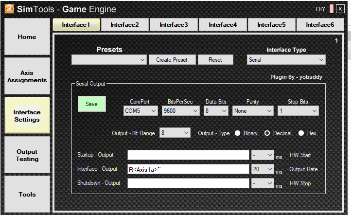

    More information would be helpful, like pictures of all of your settings, in particular your Interface Settings.

    Thanks for the help, here are the settings I am using. I changed the COM port of the arduino to 5 in my device manager to try and troubleshoot. These settings seem to make the servo move in output testing so I am not sure if their is a problem here.

    Thanks, this was a very useful addition. I finally figured out that the problem was that I was not sending high enough values between about ~ -32400 to 32400 to get the servo to spin. One other problem I am still encountering is that Simtools is not recieving input if I slow down the packet rate to not constant. Not a big deal but figuring this out would make my code more lightweight network wise.
