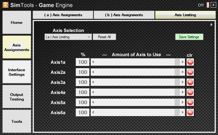

    5. Axis assignment as per SimTools manual, see screenshot

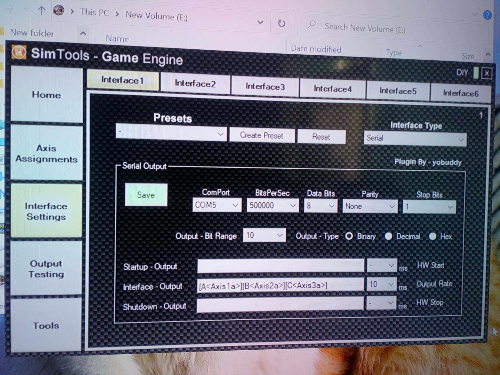

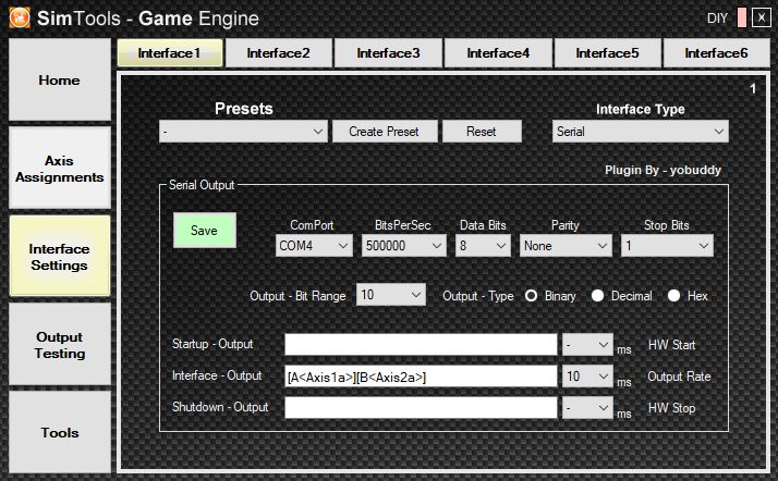

    6. Interface setting serial 500,000, N,8,1 as per manual, Interface Output [A<Axis1a>][B<Axis2a>]
    7. Same COM4 in SMC3 Utils and Simtools
    8. Setting SMC3 Utils to UDP passthrough

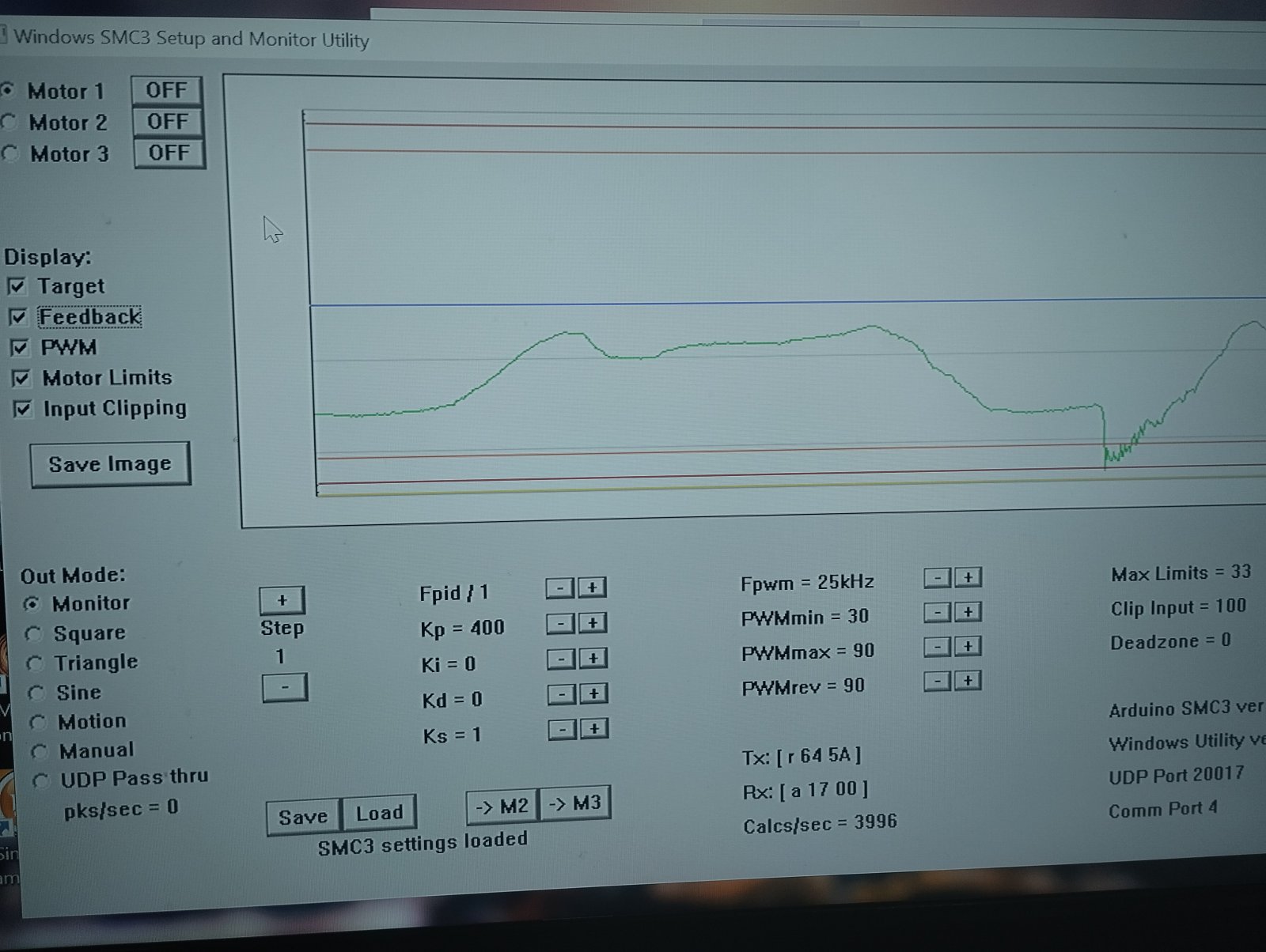

    Running the motors from SM3 Utils works fine. Only thing that puzzles me is that it shows Arduino SMC3 ver 0.80 even though I use the latest SPS 8.2 sketch from @BlazinH
    Problem is when try to go to output testing. The little color box in the Game Engine next to the DIY license indicator goes from orange to blue, but not green. When I move the sliders in output testing nothing happens.
    I have checked the interface settings several times, but something seems to keep Simtools from communicating with the SMC3 Utility. Please see below screenshots. Any ideas?
    SMC3Utils working.jpg Axis Assignment.jpg no axis limiting.jpg interface settings.jpg output testing.jpg

    Check if other programs such as anti-virus or firewall are interfering with communications.
    Temporarily disable anti-virus or firewall, reinstall the latest version of SimTools and test in Output Settings.

    Scn3 needs this i believe [A<Axis1a>][B<Axis2a>][C<Axis3a>]

    I only had time to disable the firewall, but that did not make a difference. Will try reinstalling SimTools tomorrow.
    In what mode has SMC3 Utils to run, monitor or UDP Passthrough when SimTools is on?
    Will the Output Testing from the Game Engine work without the Game Manager running?

    Do I need to state all 3 axis even though I have only two assigned?
    My current Interface Output Setting is [A<Axis1a>][B<Axis2a>] only.

    [A<Axis1a>][B<Axis2a>] is correct for 2DOF.

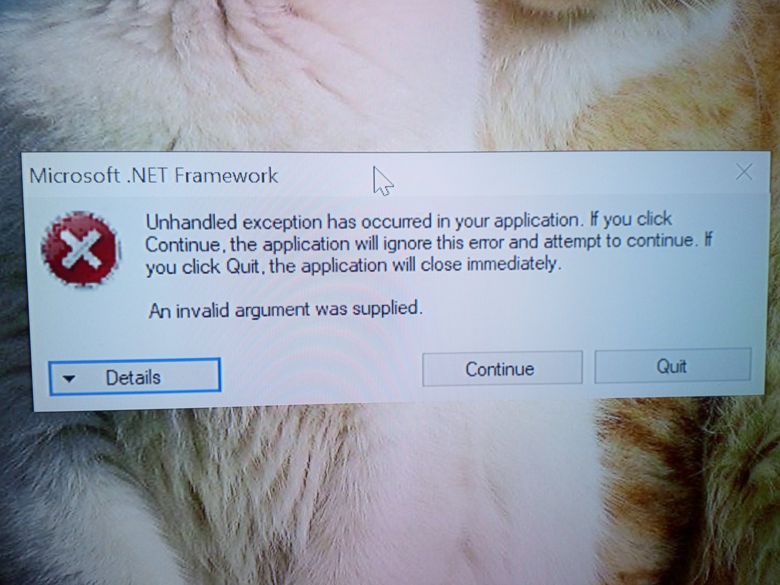

    [QUOTE = "noorbeast, post: 224642, member: 10786"] Check if other programs like anti-virus or firewall are interfering with communication.
    Temporarily disable anti-virus or firewall program, reinstall latest SimTools version and check in Output Settings. [/QUOTE]
    why when opening simtool shows a message when not connected to the internet? so internet "simtool" is required to work

    You can expand the error and copy and past the full error.
    You could try reinstalling the .NET Framework: http://www.microsoft.com/en-us/download/details.aspx?id=17851
    If the problem persists Backup, uninstall SimTools (answer yes to "remove old settings and files"), and then reinstall SimTools: http://www.xsimulator.net/community...thout-loosing-your-profiles-and-settings.160/

    System.Net.Sockets.SocketException (0x80004005): An invalid argument was supplied

    This is a socket error...
    System.Net.Sockets.SocketException (0x80004005): An invalid argument was supplied.
    Maybe your running the smc3 app at the same time?
    (All I can think of is a conflict.)

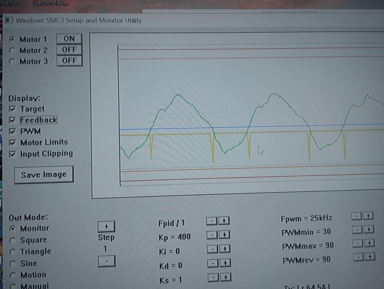

    hi .why does the feedback line fluctuate up and down like this????

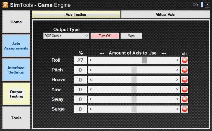

    i have a quastion about the movements in output testing to... i didnt really find it in the pdf manual as well.
    i have a 6DOF stewart and it seems that some movements in my config are the wrong way around ...
    so in which direction should the sim go if i push the test sliders to the right (!)
    -Yaw : Front to the left or right ?
    -Heave: up or down
    -Sway: left or right- i guess right ?
    -Pitch: front up or down ?
    -Roll: left or rigt - also guess right ?

    Please see the FAQs here: https://www.xsimulator.net/community/faq/which-way-to-set-simtool-axis-movements.230/
