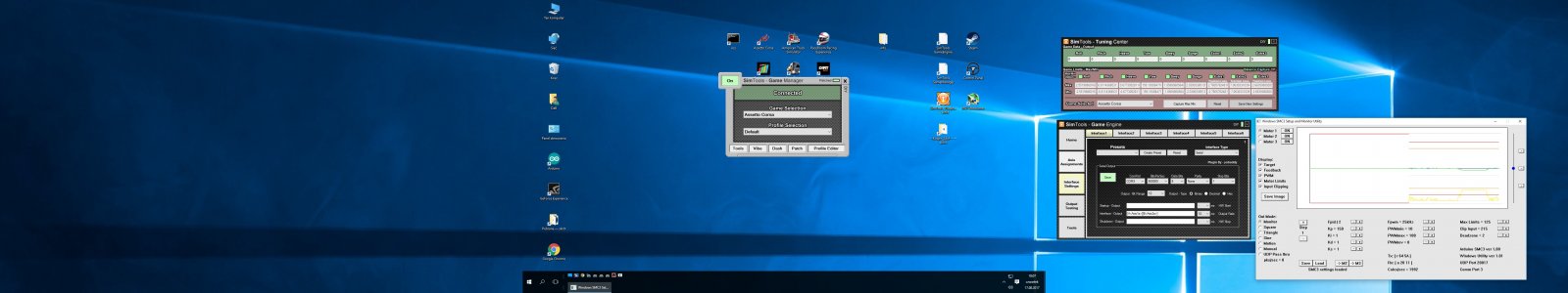

  7. wustamariana
    wustamariana New Member
    Apr 11, 2015
    18
    - 254Coins
    setting
    21,030
    147,878Coins
    +10,880 / 54 / -2
    Unfortunately that is is not clear enough to read all the settings. Please take a screenshot of each window instead.

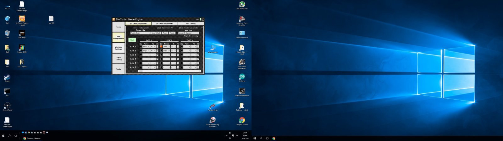

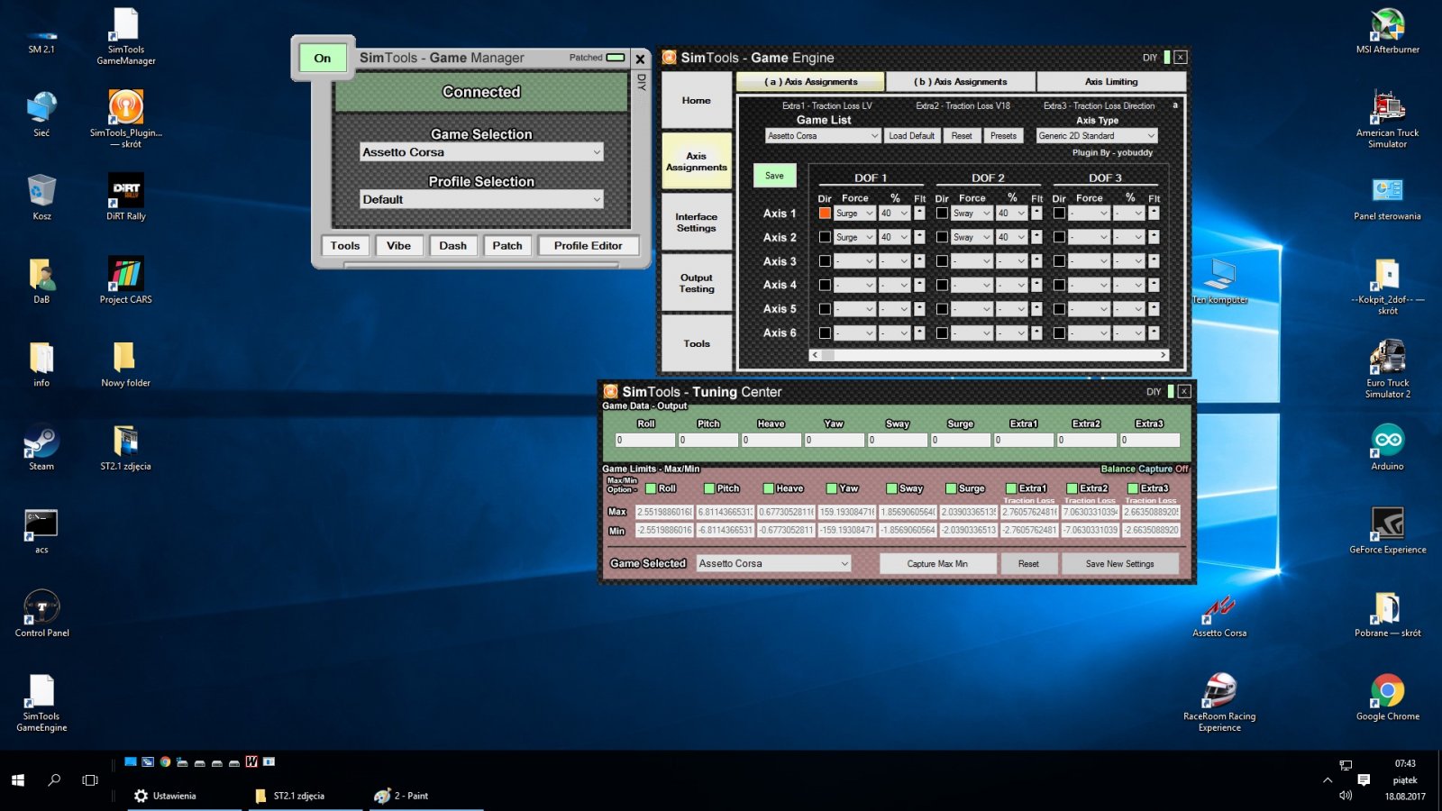

  9. wustamariana
    Apr 11, 2015
    18
    - 254Coins
    Gentlemen ashamed to admit, were misplaced axes. Confused me setting with 1.3.
    Thank you so much for help

  11. wustamariana
    Apr 11, 2015
    18
    - 254Coins
    Now it is good, there are two settings, good and bad
