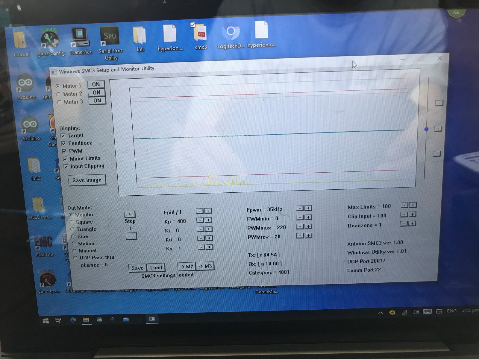

    Am trying to setup Simtools for UDP PS4 console to my Tablet running Arduino 2dof .
    but seems not working.
    can any one assist?
    Setup.
    PS4 pro console.
    Project cars2 . ( UDP pc1 or pc2 , frequency 1-9 )
    Tablet win running Simtools.
    Arduino SMC3 BTS7960 x2 DC motor.
    SMC utility can testing motor working. /setting as pics 1/

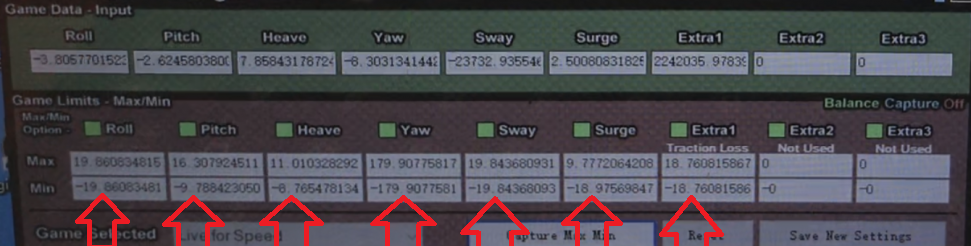

    >>> PS4 UDP simtools
    After hit the play button, start PC2 and hit race .
    As soon as click start. all the axis output when crazy and motor start spinning for some while. then all stop.
    or after some while it popup with the .NET Framework error. /as pics2
    >>> Tablet simtools live for speed.
    After then i try to download LFS to see if UDP or network problem.
    game loaded same, all axis start left right random flying, and then Microsoft.Net Framework error show up. /As pics2/
    # am also try free simhub with the DIY Gear Indicator , rpm light, dash board.
    Seems PS4 PC2 can send good UDP info out. <Pc2 with frequency 1>
    as for simtools. i had try with all options of PC1 PC2 with 1-9 frequency combination. seems non working.
    pls if anyone know which steps am doing wrong let me know.
    Thank
    Jay

    Does Output Testing work as expected?
    Have you tried updating or repairing .NET?
    Can you please copy and paste the full error so we can read it.

    1> Yes both working,
    on Axis Testing, DOF output / or Axis output working as expected.
    2> .NET on version higher then 4.8 of Win10 Tablet.
    "Checking for possible version"
    3> Here with the error .
    ## Below error from Live for speed . as soon as start racing . this error pops up.
    System.OverflowException: Arithmetic operation resulted in an overflow.

    sometimes get lucky.
    when there is no error message pops up.
    the Game Date: Input
    show just randomly flying numbers even when the car is dead stop still.
    and the Virtual Axis show the same. all axis jump from 0-100% , back and forth.

    I don't think I have seen that specific error before, so @yobuddy may want to take a look at it.
    In the meantime some things to check and try.
    Is your computer set to English Local: https://www.xsimulator.net/community/faq/simtools-language-setting-bug-change-to-english-local.233/
    You could try reinstalling the .NET Framework: http://www.microsoft.com/en-us/download/details.aspx?id=17851
    If the problem persists Backup and then reinstall SimTools: http://www.xsimulator.net/community...thout-loosing-your-profiles-and-settings.160/

    Hi Noorbeast.
    By reinstall Simtool. repair .net framework .
    Seems until now no .net framework error show up.
    LFS start.
    # but the GameDate input still show the same. it's a bunch of random numbers flying which had nothing to do with the game. all axis run from 0-100% and back.
    # seems not receiving the correct input?

    Maybe try re saving the max-min settings for Live for Speed before starting the game.
    It looks like you have spaces in the values?
    like instead of "18.476" you have "18. 476" with a space?

    Just checked again very carefully there is no space in between them, i had revised the system numbers display,
    There still show the same. there is no space inbetween,
    # Please be advice that all axis randomly jump from 0-100 ???
    which seems not normal for me,
    Do you suggest a old version of simtools for testing? think this should be the problem on the software instead of other setting, options 1. tablet problem options 2. simtools not working with this tablet.
    Maybe maybe pls assist.
    tks

    This is not a version or software problem as such, it is something odd about your system.
    What @yobuddy is pointing out is that there seems to be an apparent gap after the decimal point and that is not normal, something specific to your system is at play.
    I am aware you said this, but it is not correct, we need you to follow the settings instructions to rule out all known possibilities.
    So please check that English Local is selected in the Settings: https://www.xsimulator.net/community/faq/simtools-language-setting-bug-change-to-english-local.233/

    Maybe here with the trickiest problem ever having.
    yes confirmed it was the numbers problem.
    After I change the small number tolerance from after the dot 2 digits to 9 digits.
    eg. original setting 0.12 max
    Now. Allowed 9 number after zero . eg: 0.123456789
    all running well. Udp received the correct date.
