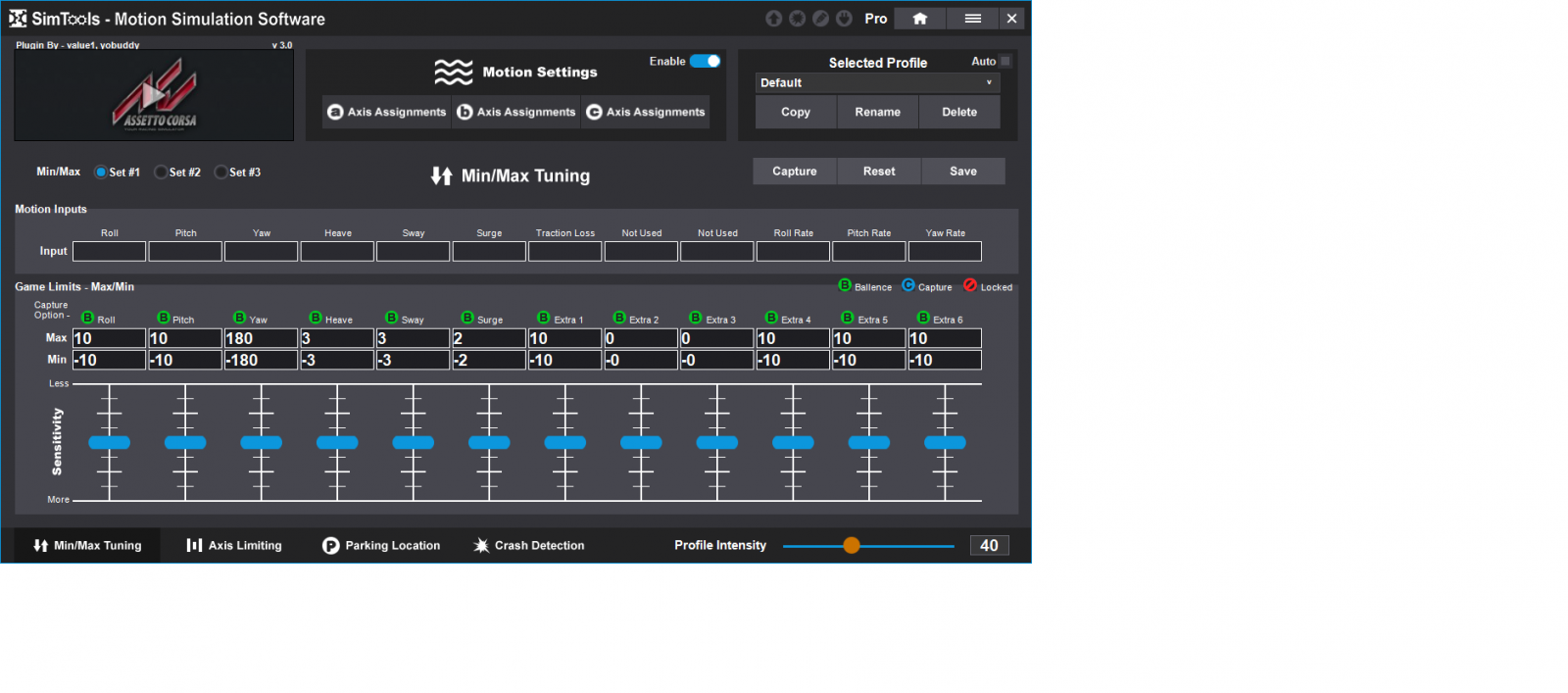

    I installed the plugin (Version 3) and only Yaw and traction loss work here. I installed it the same way I installed the other games and they all work perfectly. Do you have any special tips? Thanks.
  11. Nailson Roveta
    Nailson Roveta New Member
    Jun 3, 2025
    4Coins
    I found the problem. I'll leave this document because it might help someone with my inexperience. Now everything is working. The problem was in the Min/Max Tuning tab; the Surge values were too high. I repeated what I use in Asset Corsa and now everything is working. Cheers.

    Hi, first, thanks for the great work that you guys have done here.
    • I tested this new v3 plugin, and some feeback
    • I have little few details from it, need to increase a lot the axis range to actually feel anything
    • Surge seems not working
    • Vibe is also not working for rpm at least
    I have some experience using simtools, and to be honest doesn't seems a configuration issue, but could be something that a miss somewhere. Anyone here is experiencing similar issues?

  20. Joao Costa
    Joao Costa New Member
    Dec 11, 2023
    18Coins
    yes but limits are fine. the current values that i saw in that table are very low, close to 0
