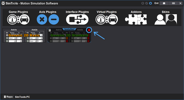

    3) Go to the Plugin Manager and Install an Interface Plugin, an Axis Plugin and a Game Plugin.

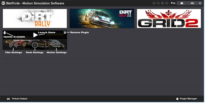

    Any action that is directly related to a specific game can be done under its own menu.
    Updates Available
    Click the down arrow for update options for this plugin.
    Launch Game
    If this button is white, the game is ready to be launched. If this button is gray, you need to set a launch path for the game. Double Click to launch a game.
    Remove Plugin
    Click this icon to remove the installed plugin.
    Vibe / Dash / Motion Settings
    If these buttons are red, they are temporarily disabled and will not be started when the game is launched. If these buttons are gray, it means there is no interface setup for the given section. If these buttons are white, it means the section has valid settings and the section is ready to run.

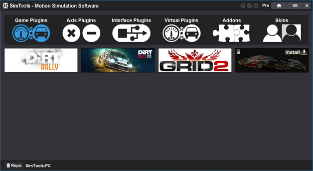

    ~ Installing Plugins ~

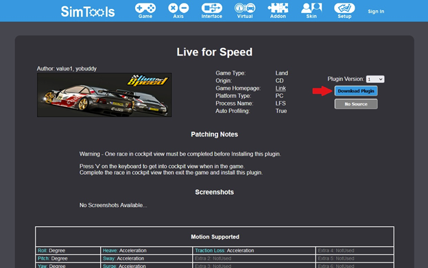

    Installing plugins can be done directly thru SimTools v3 in the plugin manager section of the app. Or by downloading them from the online repo system and then drag and dropping them into the main GUI for offline installation.
    For Offline Installation, grab the file from the new Online Plugin Repo.
    Then Drag Drop the plugin into the main gui
    You may find that some game plugins do not set a launch path for a given game plugin, or the path is setup for a different version of the game than what you’re running. To update a launch path for a game plugin, simply drag and drop the games exe or shortcut on the banner for the given game plugin.
    You can only remove plugins from the plugin manager if they are not used in the app.
    If can not remove a plugin, check that it is not assignment in the app.

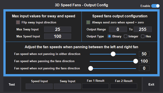

    And 3D speed fans are now up and running.

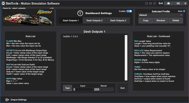

    Dash Rules page revamp.
    New Rule GetBits!
    Take Speed for example, we can now clamp, translate to bit range, and return the output we want with a single rule.
    Example: When speed input = 100
    GetBits 0 5 8 d (this means clamp between 0 to 5, get the value in 8 bit range, and return a decimal.)
    The output would be 255.
    Simple Right?

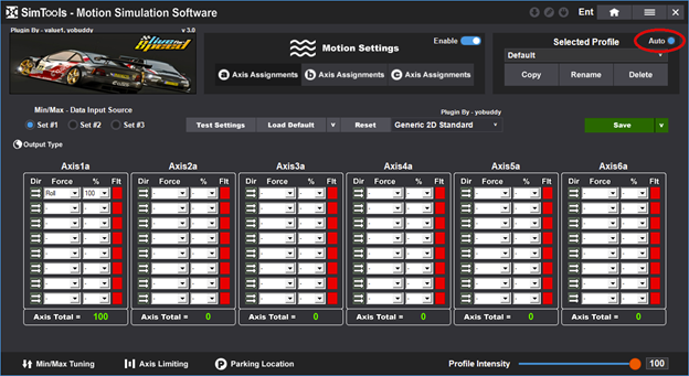

    For a game that supports auto-profiling, you can turn it on here!
    And it will auto select/create a profile for the vehicle currently being used in the game.

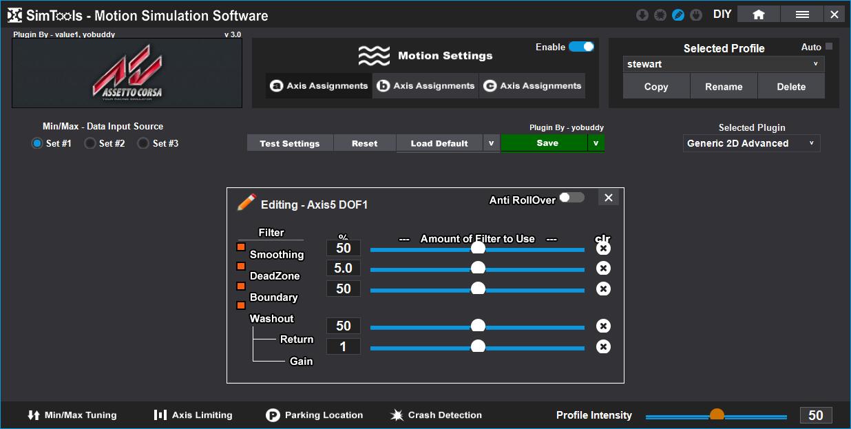

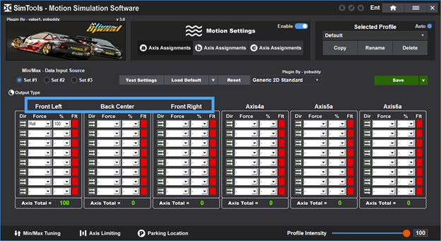

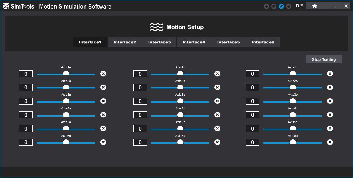

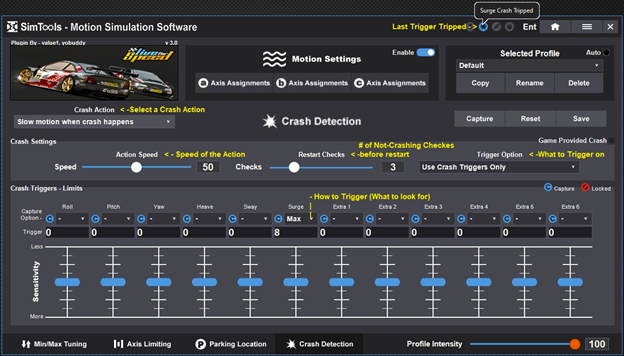

    Something new in v3 that would be hard to know about if I didn't tell you is: Axis Naming.
    And then the names are used everywhere in the app that makes sense.
    You can even assign axis with these new names in the interface section if wanted, <Front Right> as an example.

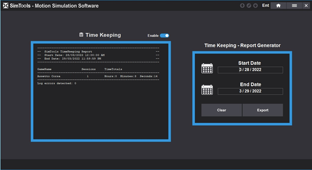

    ~ Time Keeping ~
    You can simply turn it on, and it will record the amount of time you play each game.
    It will only count time when the game is running, not paused, and at least one interface is being used for motion (sim is running).
    After a session or two, you can spit out a report for the day, and it should add up total play time for each game.
    (Example Time Keeping Report)
    ~ Crash Detection ~
    Crash Detection now included.

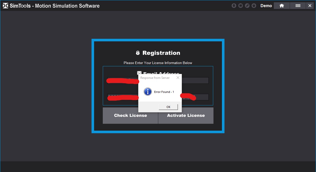

    this is really a great news. thank you @yobuddy !

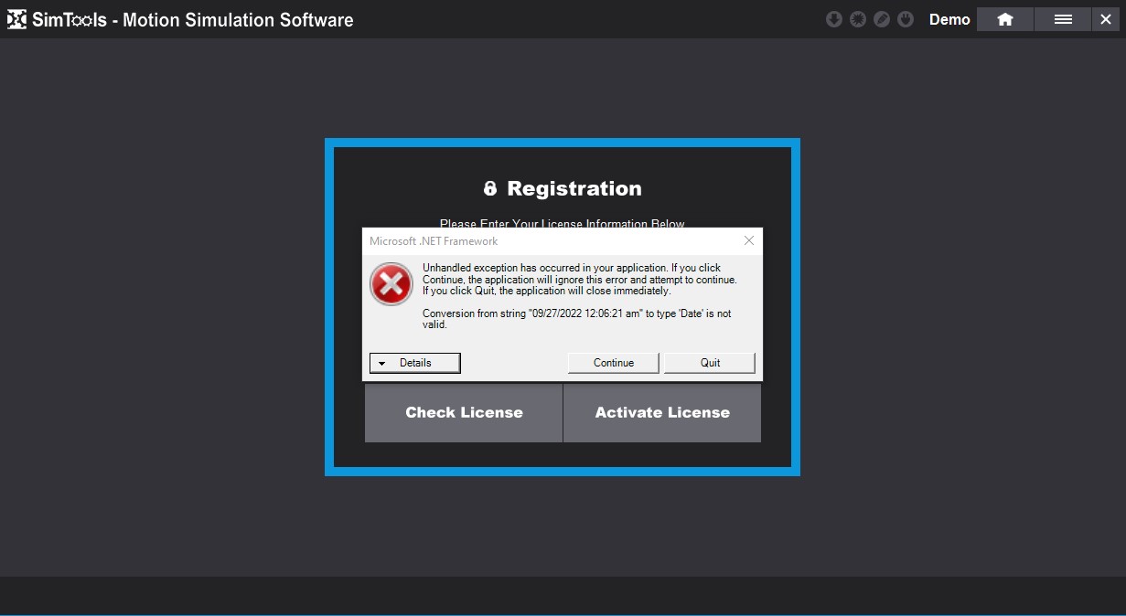

    btw, can I use my diy license for V3?
    I get an error to register with it.
  8. yobuddy
    51,675Coins
    +5,204 / 19 / -0
    w00t!
    Yes!
    I uploaded a possible fix just now, please relaunch simtools and select 'Yes' to the update (should auto update).
    Then try to register again and let me know how it goes buddy!
    Thanks for the message!

    thx for the fast response.
    but unfortunately it's the same.
    here the detail for the error.
    System.InvalidCastException: Conversion from string "09/27/2022 02:32:09 am" to type 'Date' is not valid.

    @itsumairu
    Did SimTools v3 update before you tried to register again?
  11. itsumairu
    itsumairu Active Member
    Dec 13, 2021
    210
    Psychologist
    Indonesia
    440Coins
    +92 / 2 / -0
    2DOF, 3DOF, DC motor, Arduino
    Yes, It's already updated.
  12. yobuddy
    51,675Coins
    +5,204 / 19 / -0
    Hi @itsumairu,
    I uploaded another possible fix for the reg problem.
    Please let it update and try to reg again and let me know what you get buddy.
    Thanks!
  13. itsumairu
    Dec 13, 2021
    210
    Psychologist
    Indonesia
    440Coins
    +92 / 2 / -0
    sorry for the late response.
    it's still doesn't work.
    but it has a difference respond
  14. yobuddy
    51,675Coins
    +5,204 / 19 / -0
    Found where the problem lies thou, I will have to look it over tomorrow as its 3am here. lol
    We will get it working, take care!

    I had two problems:
    1. I tried registering with my DIY licence which got from my rig thread for free(year 2020), "check license" said it's valid and has been previous activated(sure I'm using on my simtools V2), after click "activate license" the window said my Email and key is invalid.
    And later I used another purchased DIY key(recently this year) and activated with no problem.
    2.All the drag bars are not working for me(like in the axis filter and interface Test Settings), I think it's because the window is a bit squished so my cursor can't grab them properly.(my resolution 1920x1080)
