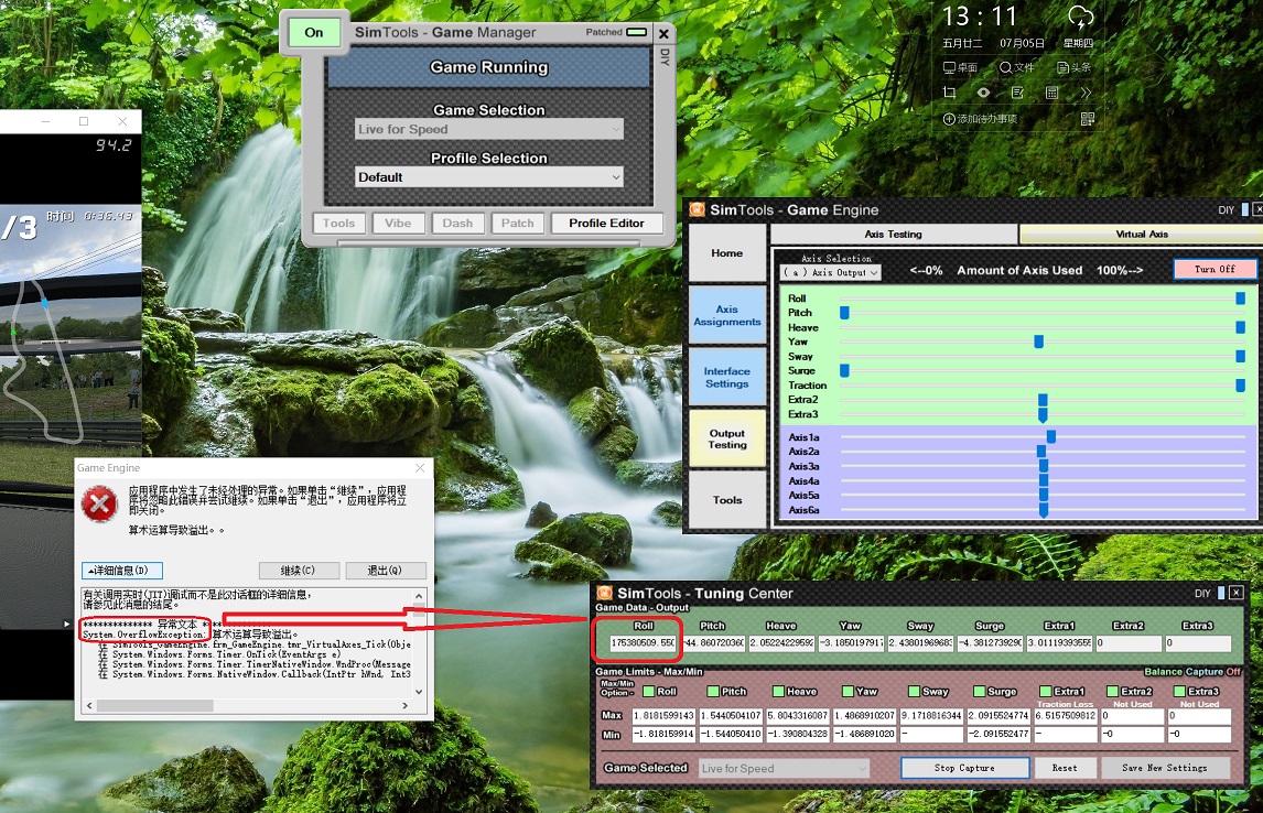

    Hello all, I am new to Simtools, and trying to use SimTools to control my 6-dof platform (RC model servor based). I run Live for Speed , but it seems some wrong game data is exported. After I checked the tuning center and find some data is extreamly big,
    When I turn on virtual Axis , Win10 pop up a message "the System overflow Exception" , I guess it may be caused by the extreamly big data from the LFS.
    I checked the CFG.txt , the UDP port and outsim mode is ok,
    OutSim Mode 2
    OutSim Delay 1
    OutSim IP 127.0.0.1
    OutSim Port 4123
    OutSim ID 1
    The Simtools is V2.2, Windows 10 X64 , Live for Speed 0.6R
    Any one can help me to solove this issue?

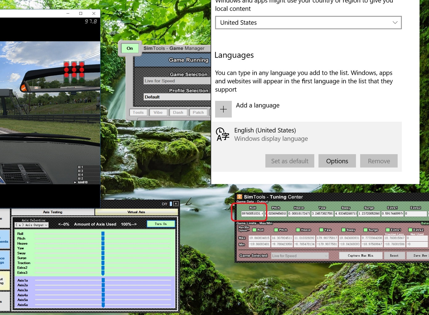

    I changed the WIN10 system language to english only and restart the PC. but the value of game data still is extremely big(roll, pitch , surge.......) and the "overflow" message popup again and again. Do I need to reinstall the win10(english only)?
    please check the attached screen capture.

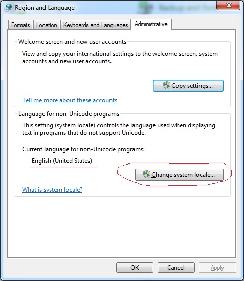

  4. yobuddy
    5,282
    49,199Coins
    +5,093 / 18 / -0
    Not the language buddy, the system local, as in the pic.
    Take care,

    Thank you, I tried once again, It's done..
