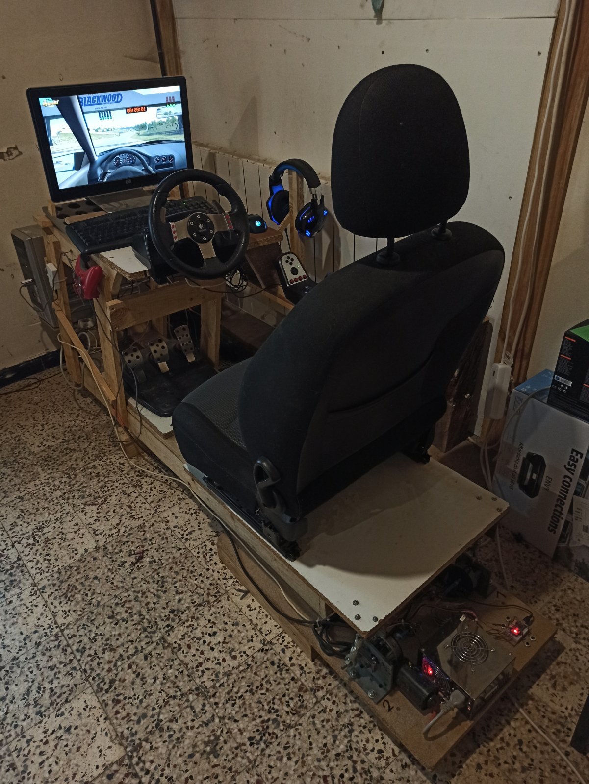

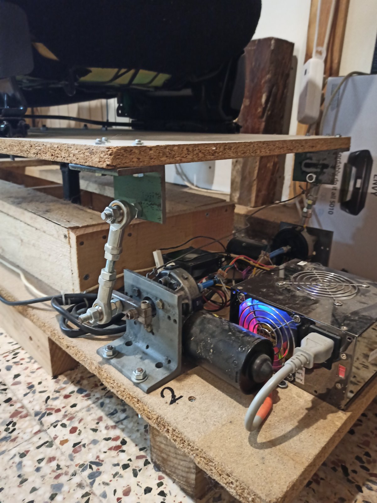

    Bonjour, apres de nombreuses recherche sur ce site, je suis parvenu a realiser une 1ere maquette 2 dof :
    le materiel:
    -carte Sabertooth 2x32
    -carte arduino Nano
    -2 moteurs essuis glace voiture 12v
    -alimentation 12v pc classique
    parti logiciel, j'utilise Simtools
    Vu le test positif de la maquette, je suis passé a la realisation du simulateur:
    en attendant de pouvoir utiliser plus, je test le simulateur sur LFS.

    Hello, thank you for your support, so far all updates are made.
    I use the simulator, especially my son, almost every day, no particular problem.
    Maybe just potentiometers that are not good quality and I have a repositioning engines not very precise, but it does not bother the feelings of the machine.

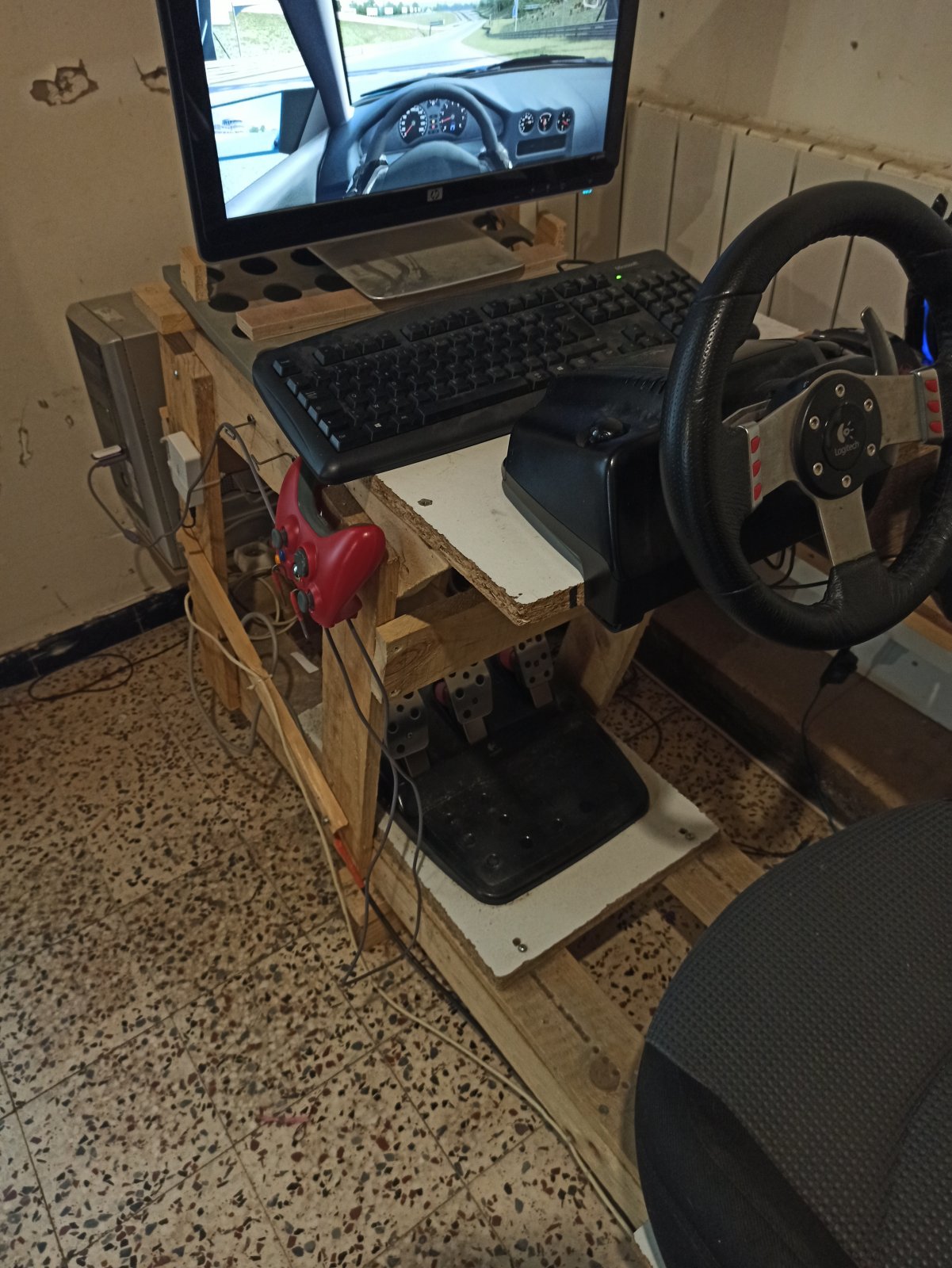

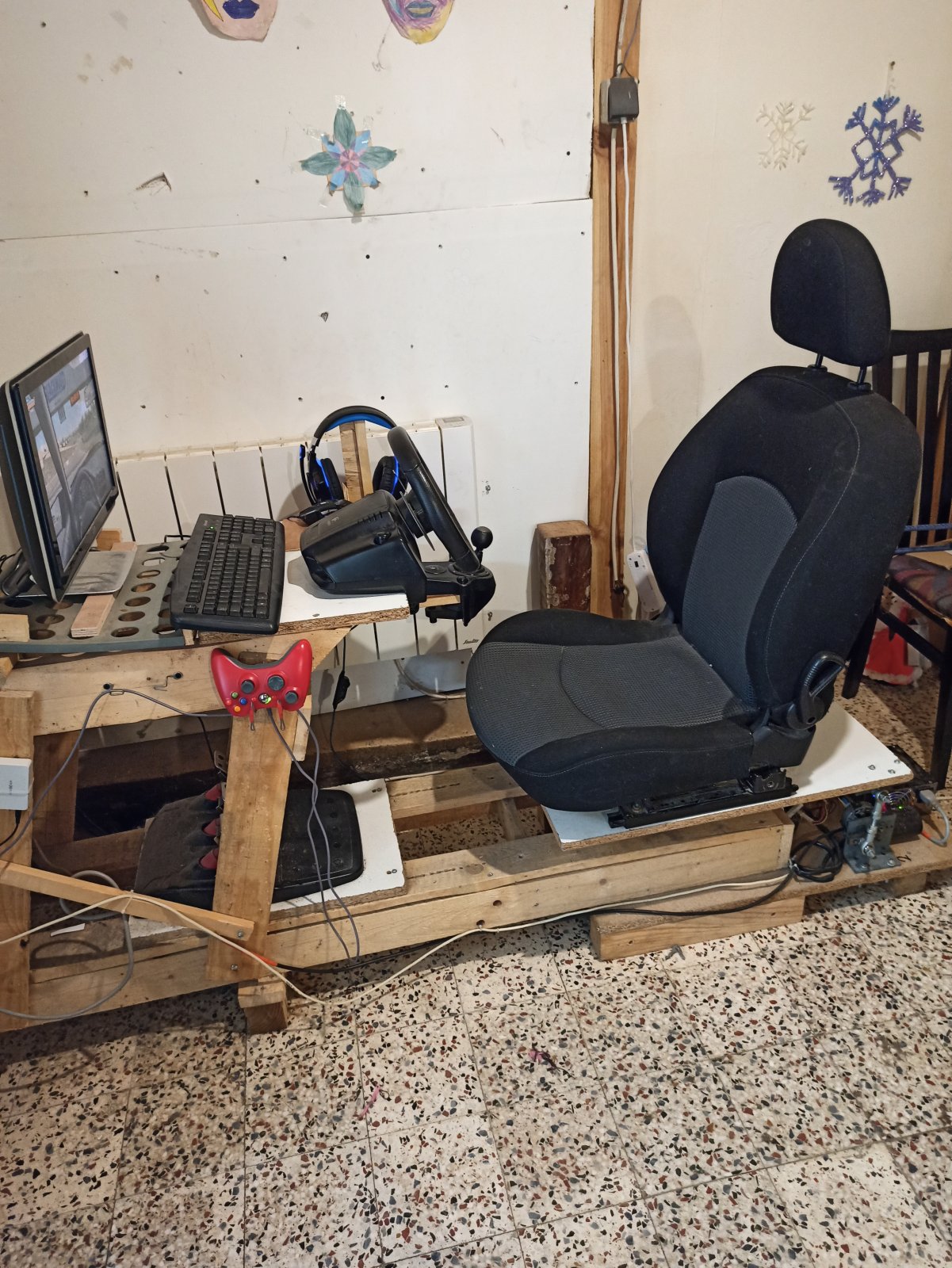

    Hello, I come back to you to show you the final version which is fine with me, there was a long time when I put the project aside, because after a change of pc, go from windows 7 to windows 10, nothing worked, and no one knew why. Voila, but children one myself are delighted.
    thank you for all your tutorials.
