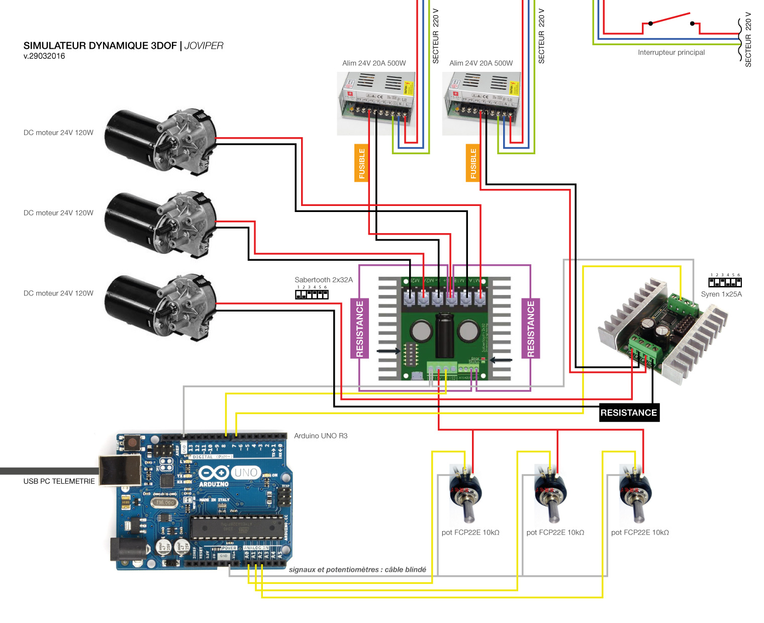

    - 2 SABERTOOTH 2x32A cards
    - 1 ARDUINO GENUINO MICRO card
    - 2 Power supplies 24V 1000W
    - 1 12V 800W power supply
    - Various connectors such as M/F usb cords and electrical cables
    - 3 Legrand Plexo waterproof sockets
    - 3 Mosîc 45 legrand socket outlets

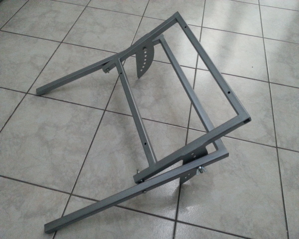

    Now that the plans have been drawn up ,
    it's time to build and weld all this scrap,

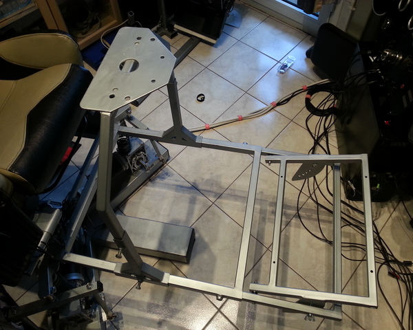

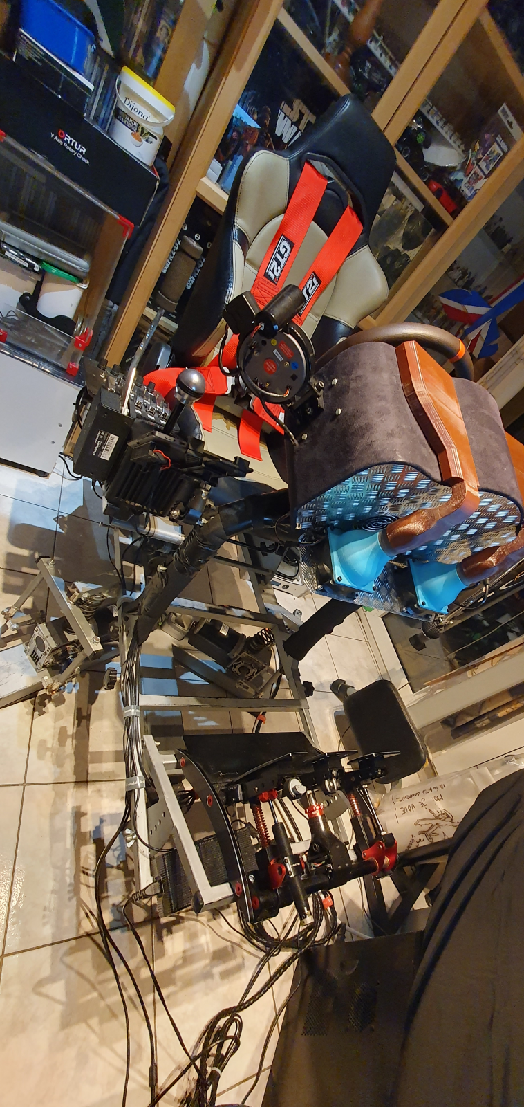

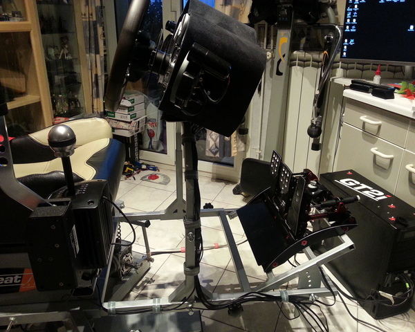

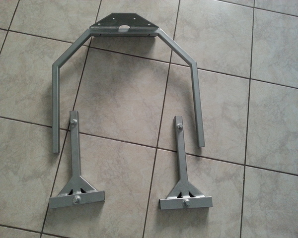

    This is the part of the steering wheel that will be adjustable in height and depth,

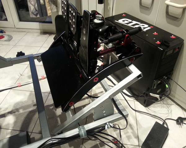

    Depth-adjustable and tiltable bottom bracket for long legs

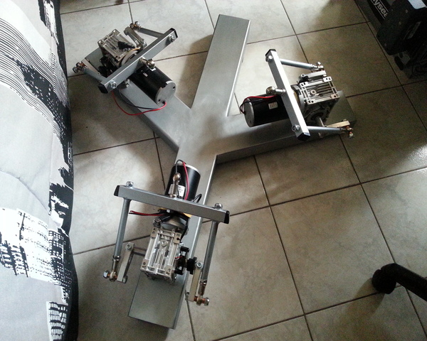

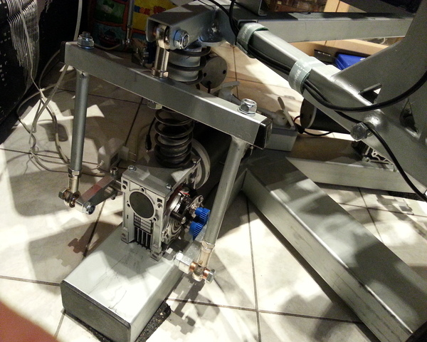

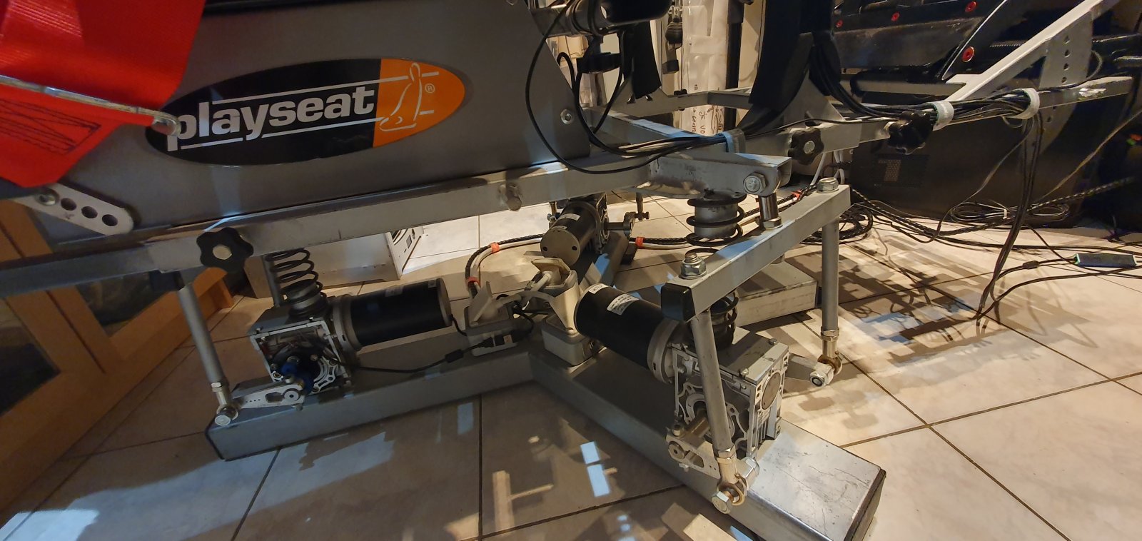

    The simulator base with its 3 large 400 WATTS motors

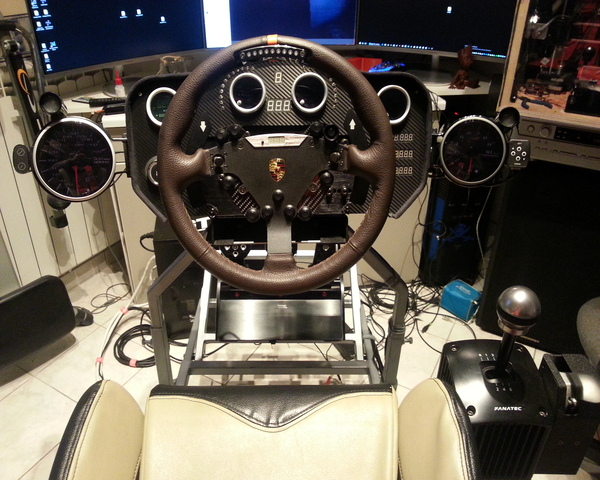

    FANATEC crankset installation

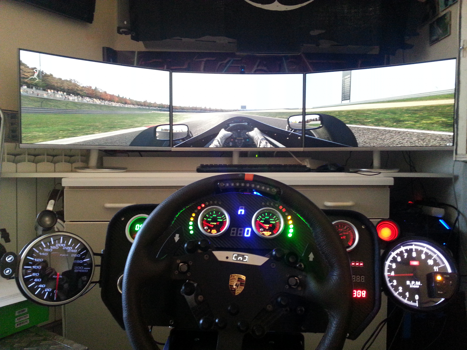

    Installing Fanatec's ClubSport Wheel base v2 with its Porsch steering wheel and my dashbord

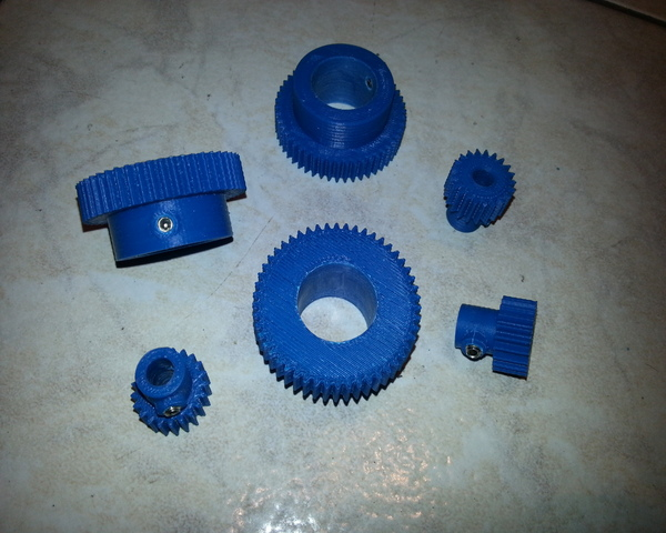

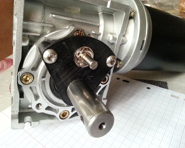

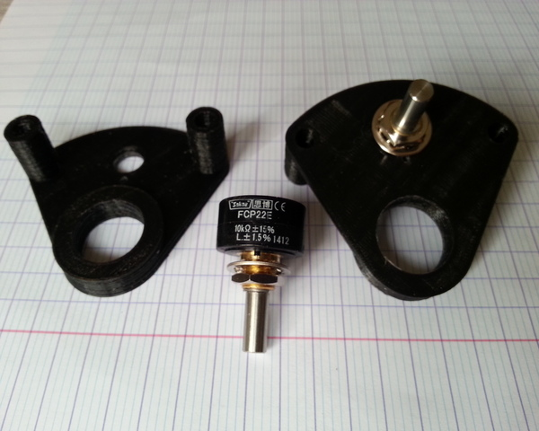

    Prints of the ABS motor pinions and potentiometers made with my 3D printer

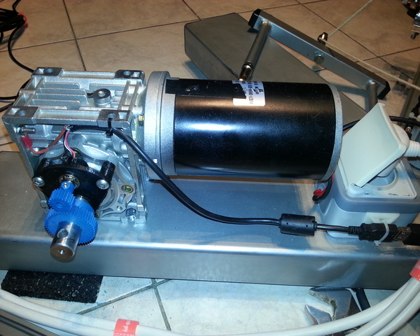

    Potentiometer support assembly
    Mounting the assembly on the motor

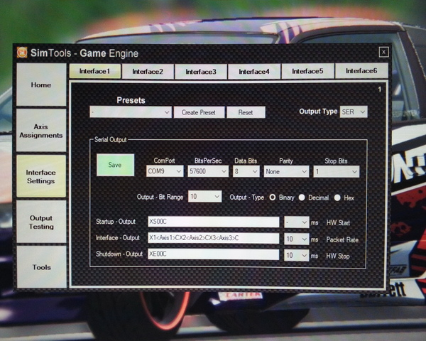

    I chose to connect the potentiometers via USB and the 24-volt motor power supply via extension leads and plexo sockets, which is quicker in the event of dismantling the assembly,

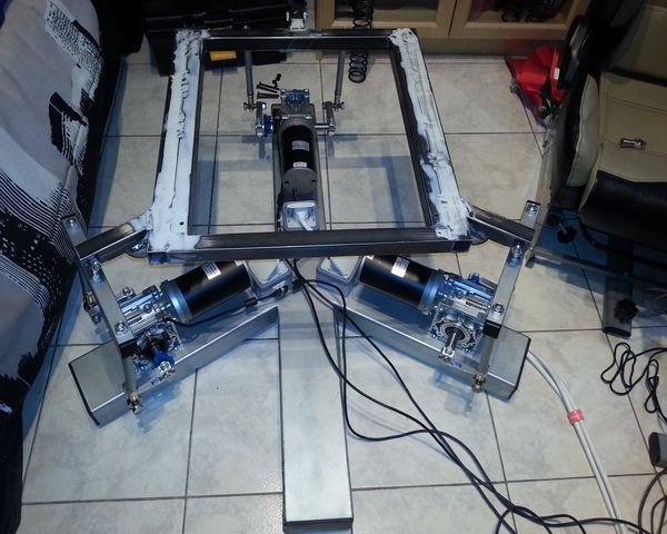

    Assembly of the platform that will hold my wheelchair, the former base of my playseat 2 DOF.
    Compensation spring to relieve the weight of the structure on the motors

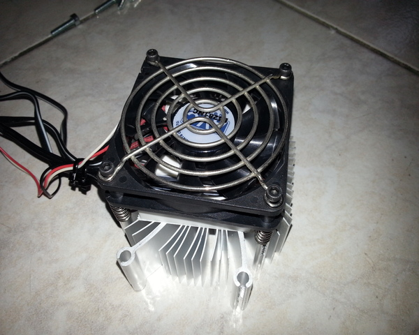

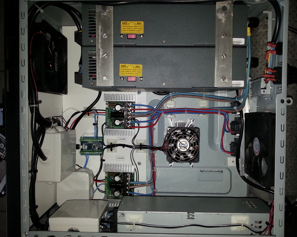

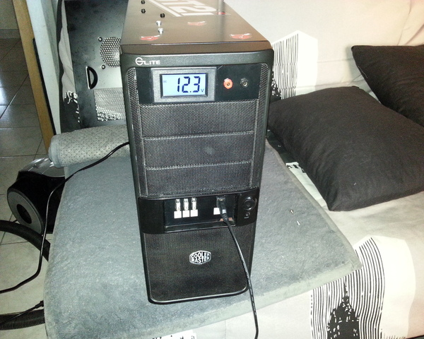

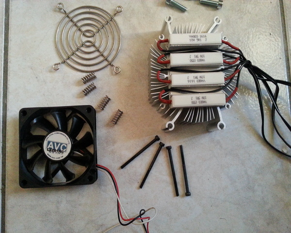

    Installation of the electronics, here the 4 resistors for the 2 SABERTOOTH 2x32A boards
    Resistors that are well ventilated
    Here's the little world gathered in a PC tower
