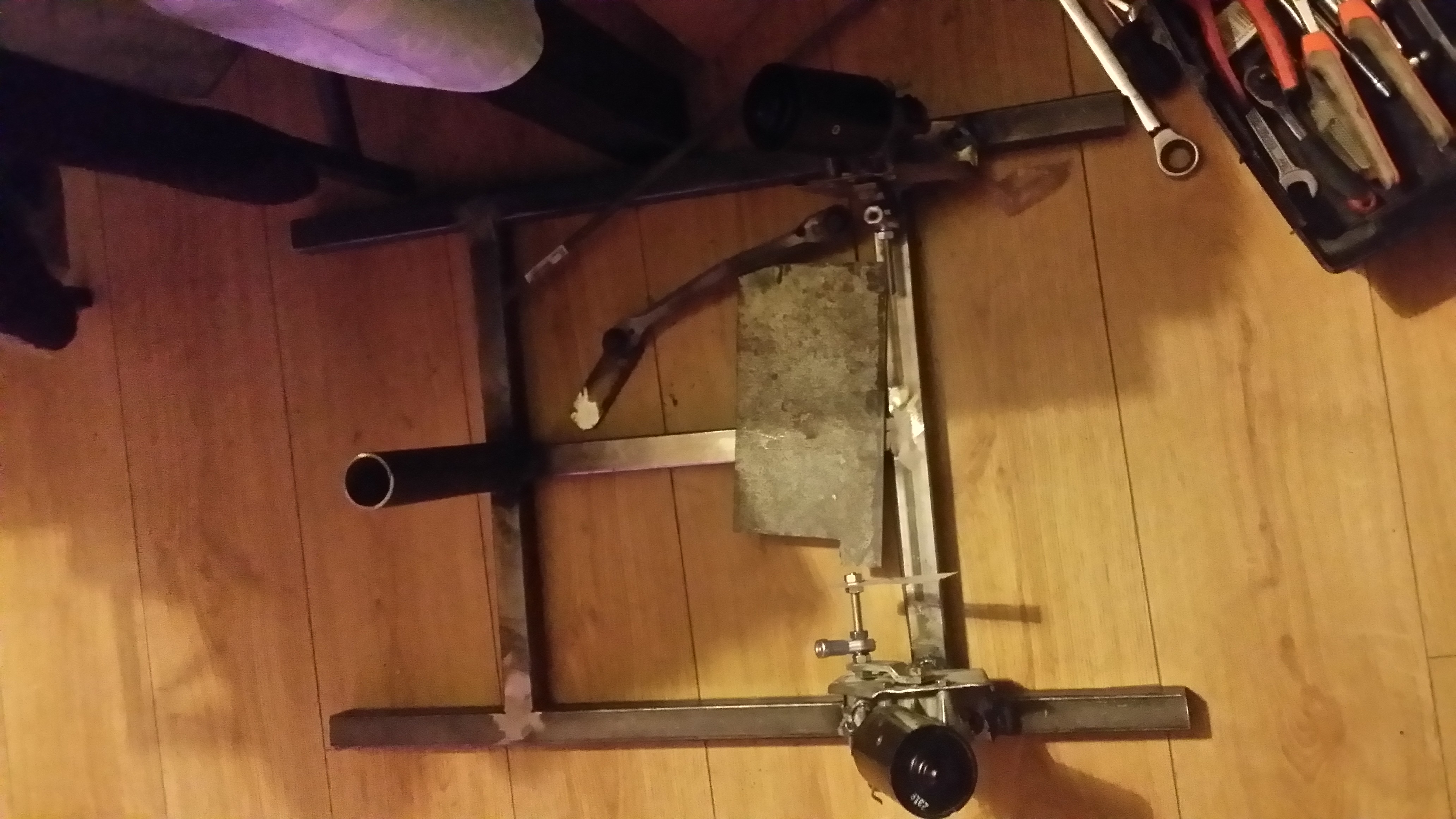

    hello i want made simulator homenade

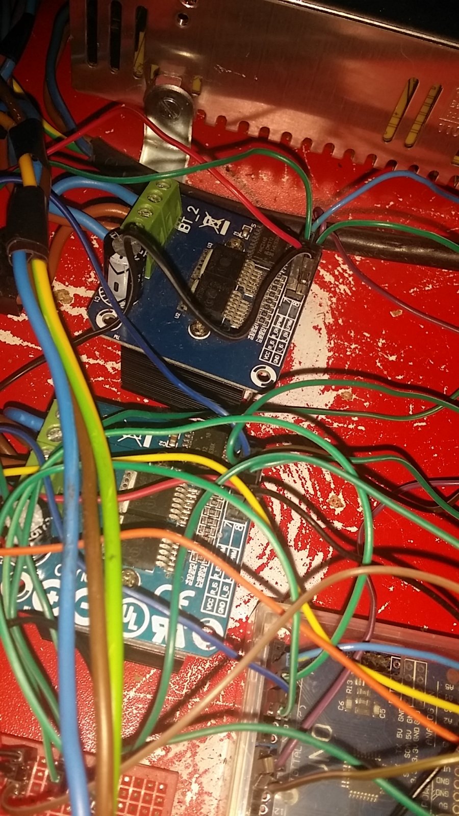

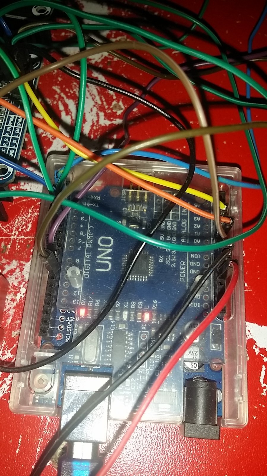

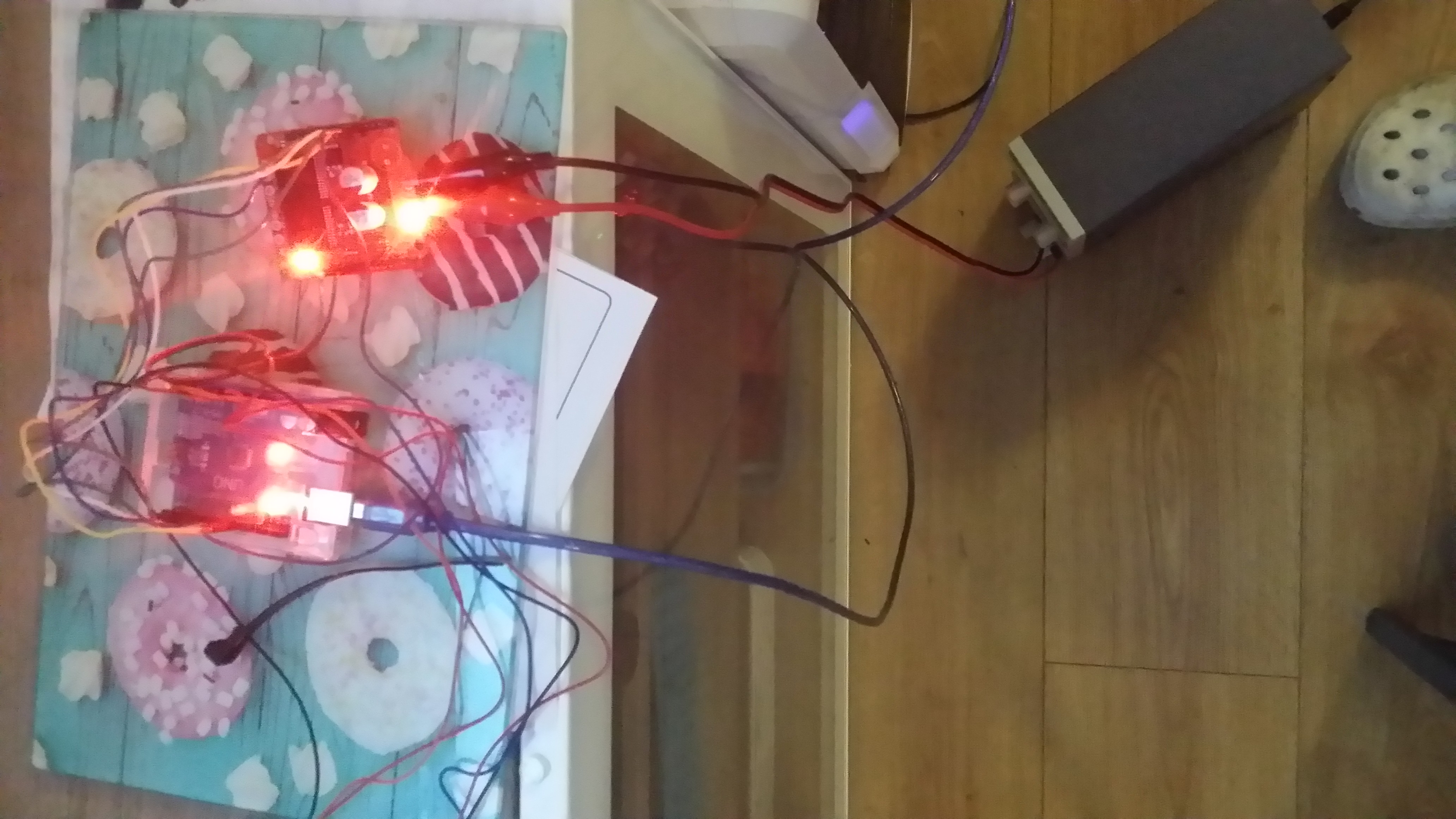

    I bought two motor ice wiper with an arduino card and a motomonster card

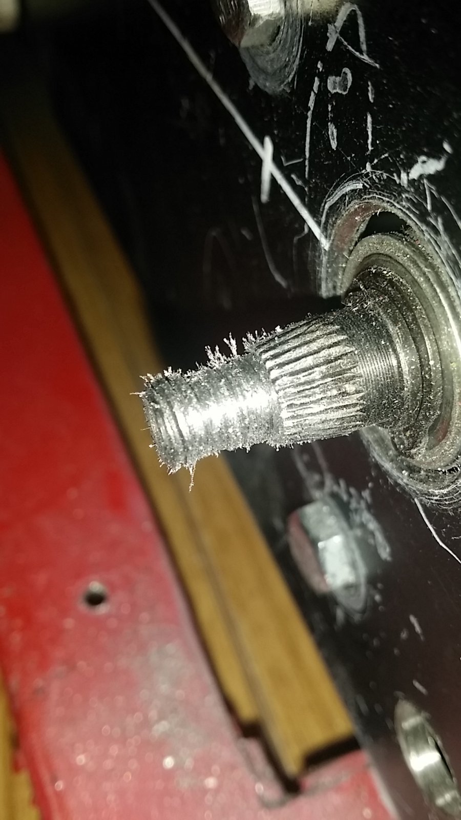

    problem with motor axis

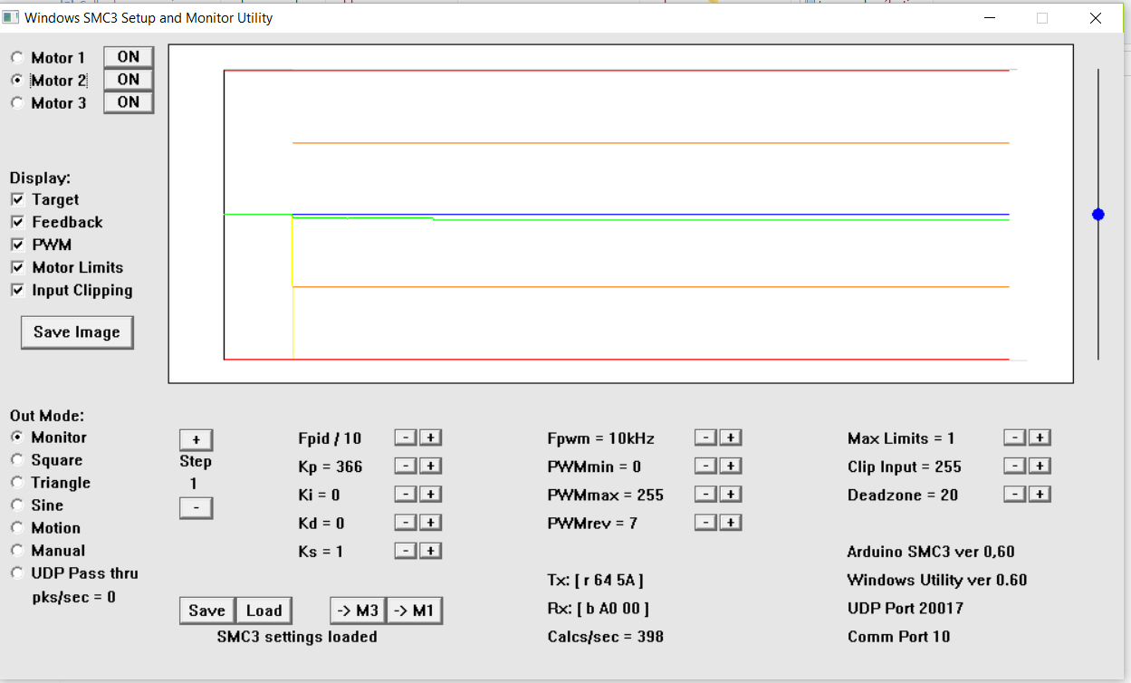

    I have not set up smc3 it was going too fast too much and it has damaged the axis
    password : simtool

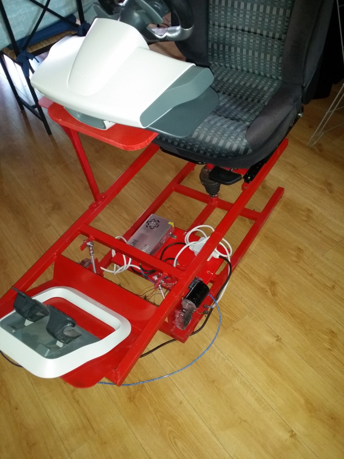

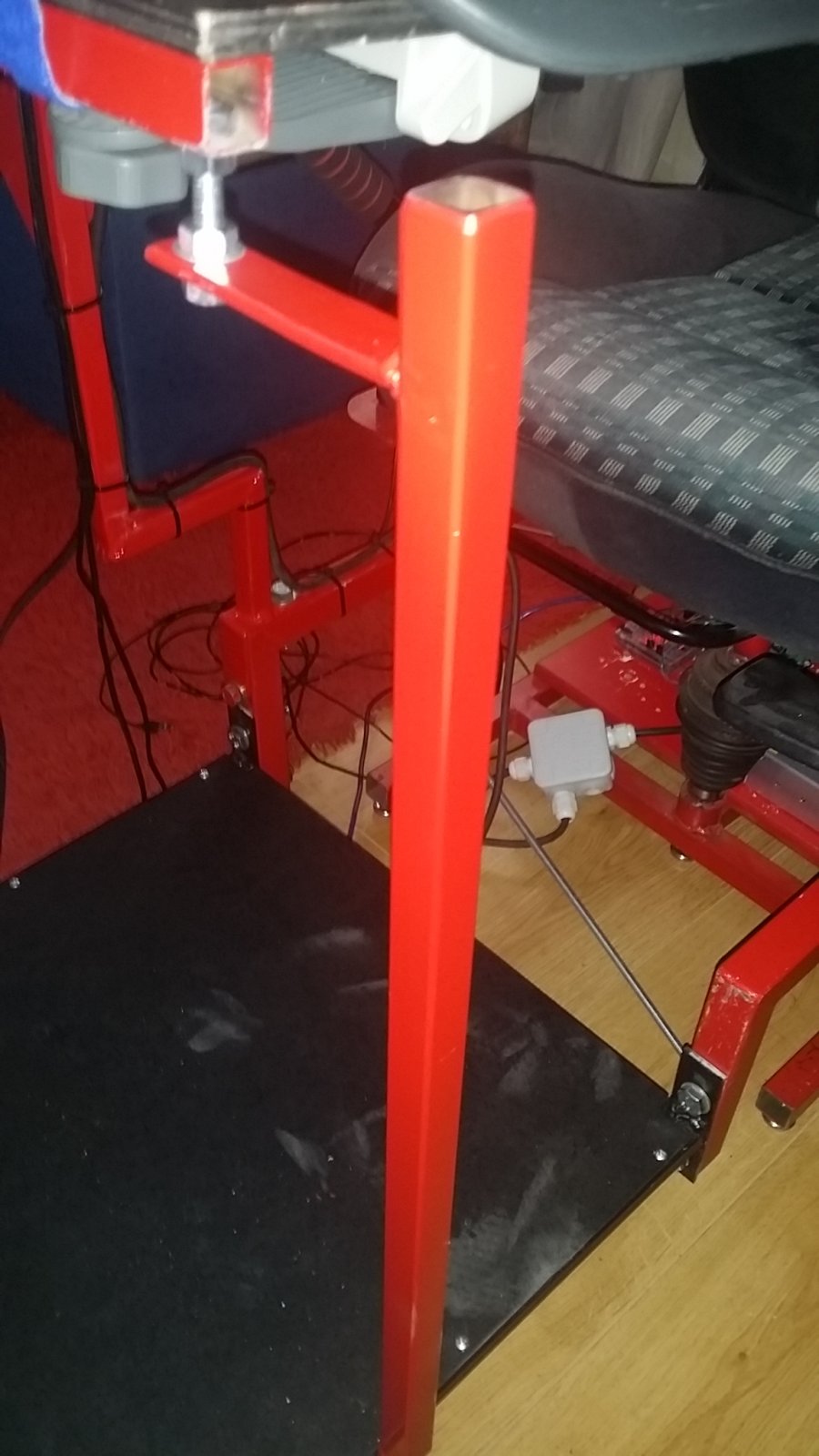

    my first prototype 2dof seatmover test engine right .
    another prototype but full mover seat with engine back
    I wanted to try with the engine at the back
    but I do not like

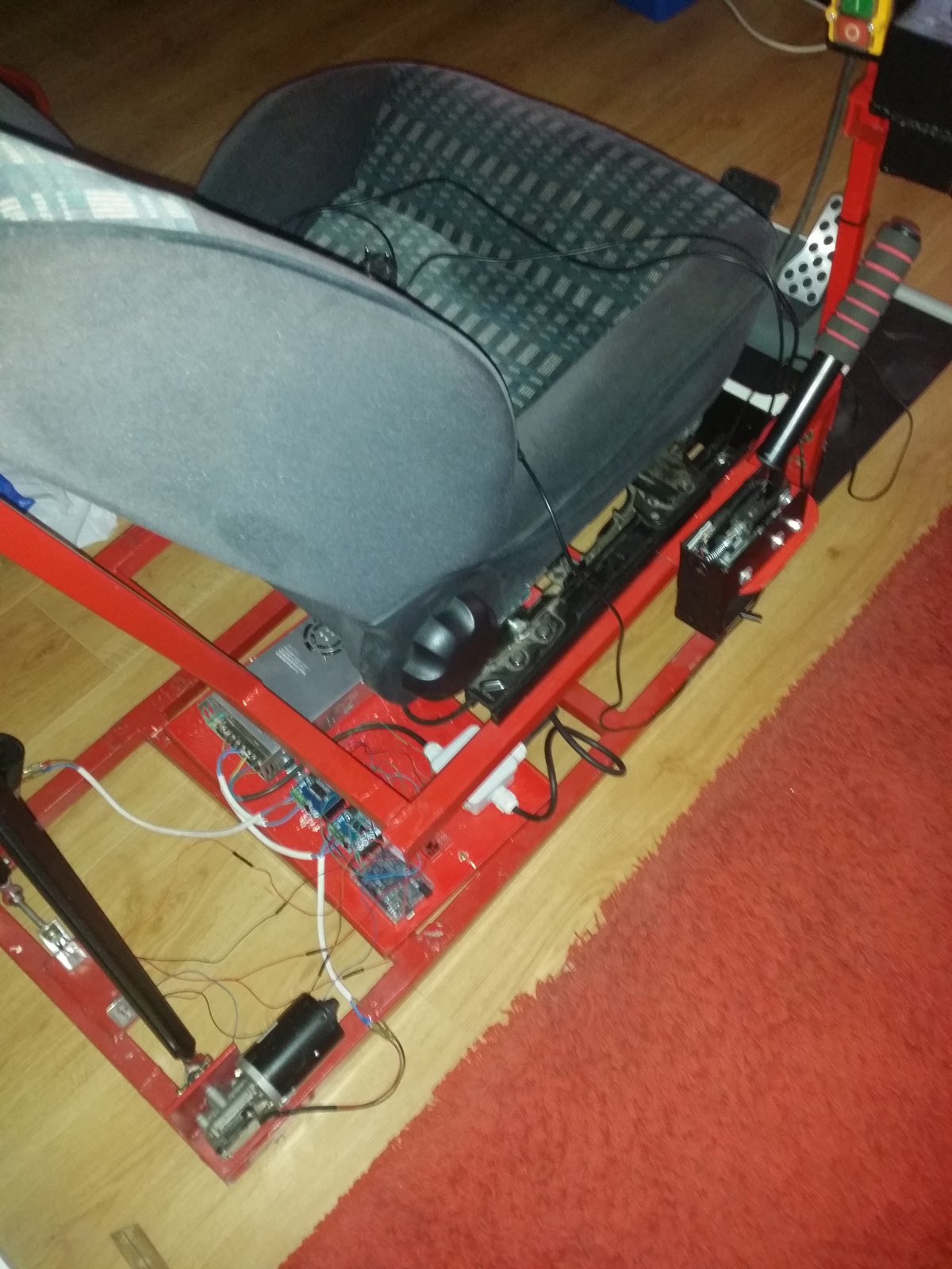

    Another prototype full mover seat with
    the engine is in front
    I still have to change because of the engines .

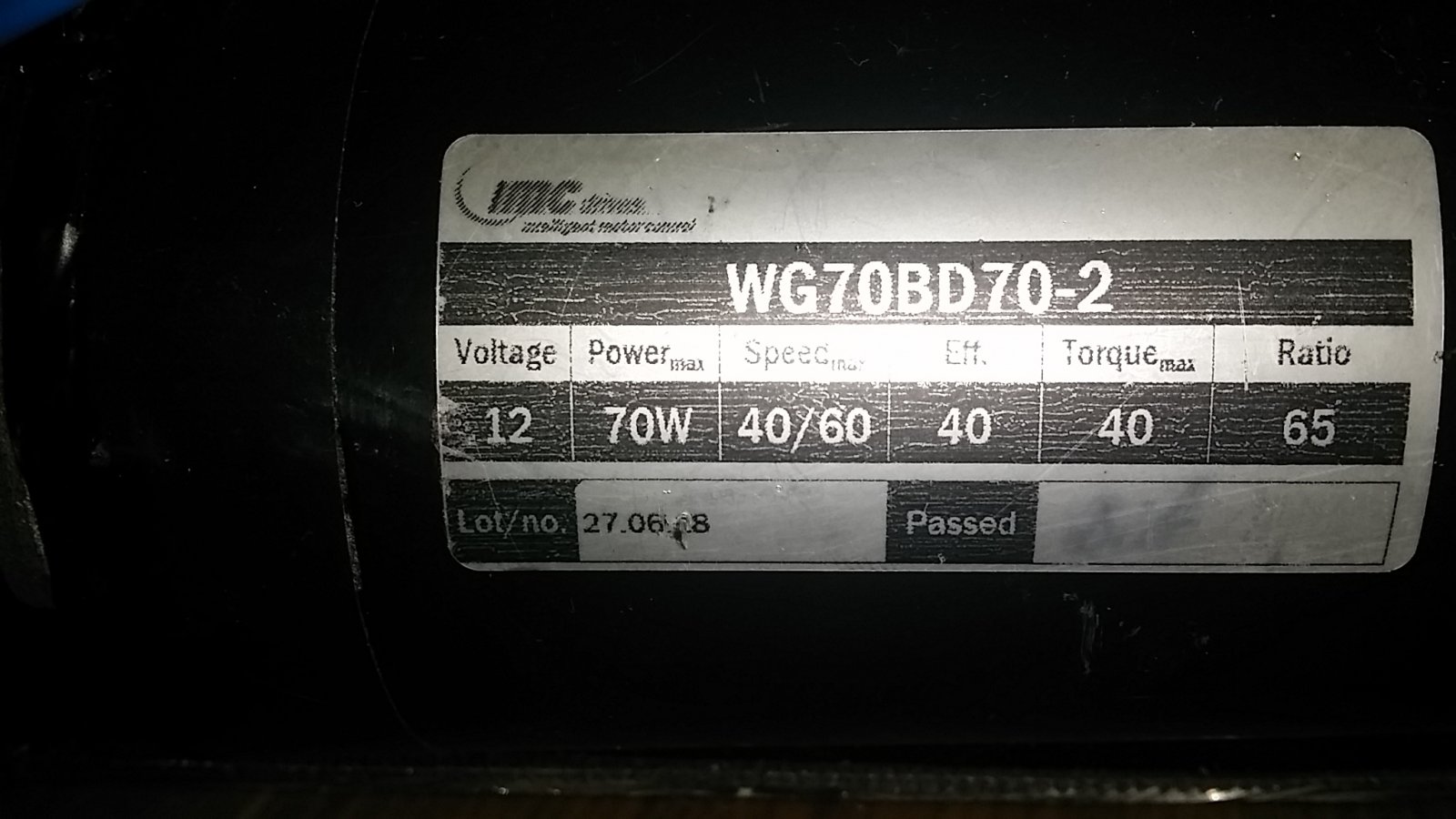

    the engines are not powerful enough I'm going to change them
    it is very difficult to build a simulator alone I had a lot of problems I had to make several prototype before I managed
    I change for a final version with engine on the back but without the two bigs crank

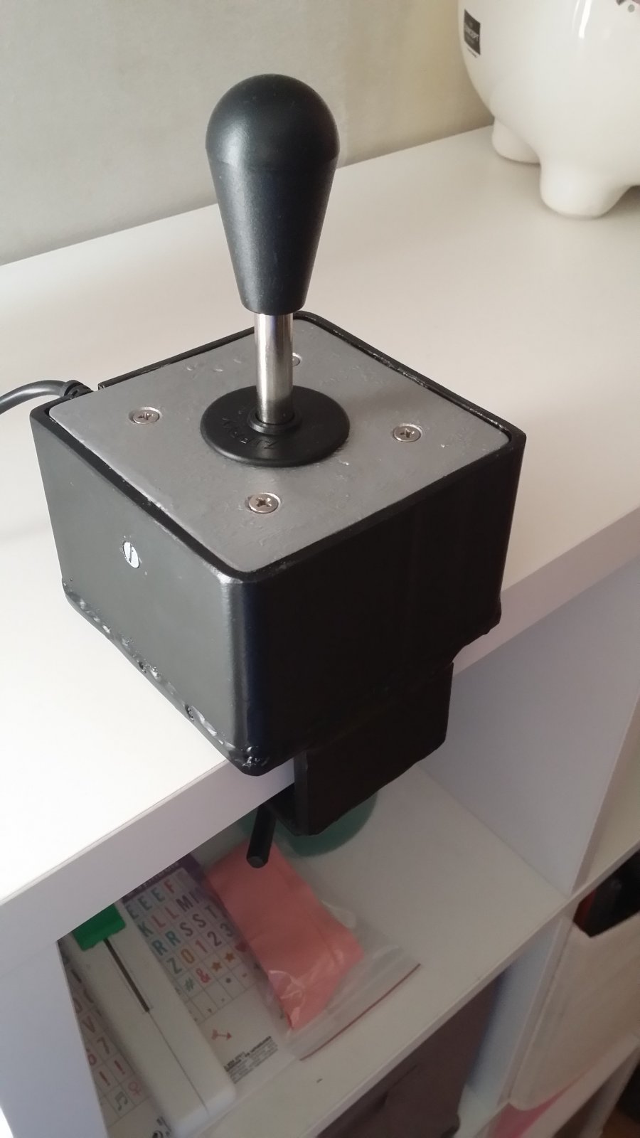

    My homemade DRIVING SHIFTER for my playseat

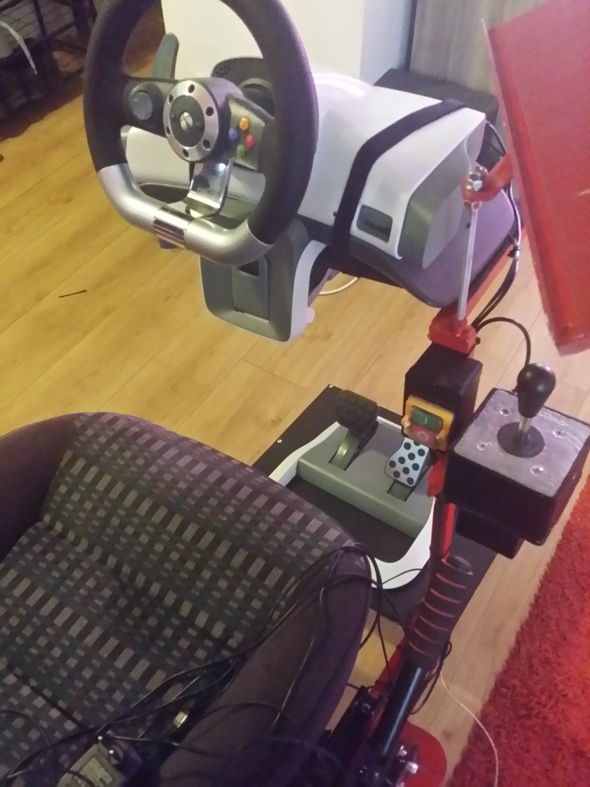

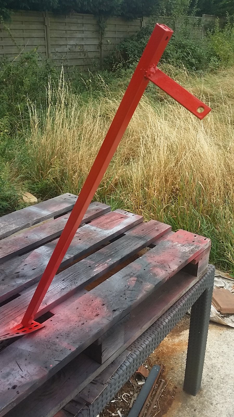

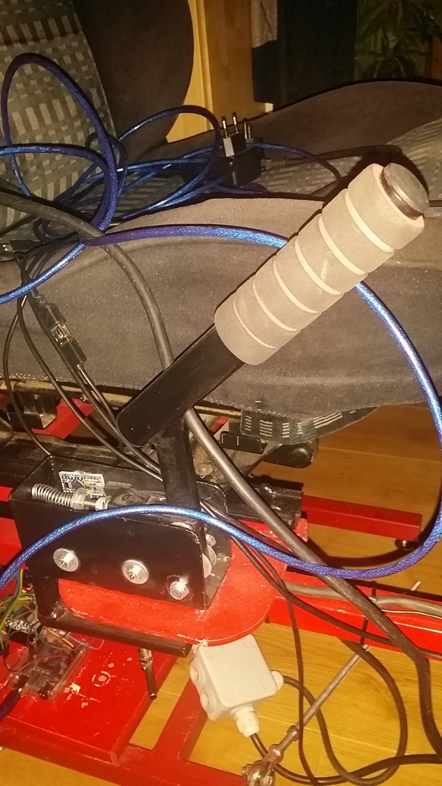

    My progressive handbrake homemade for my playseat

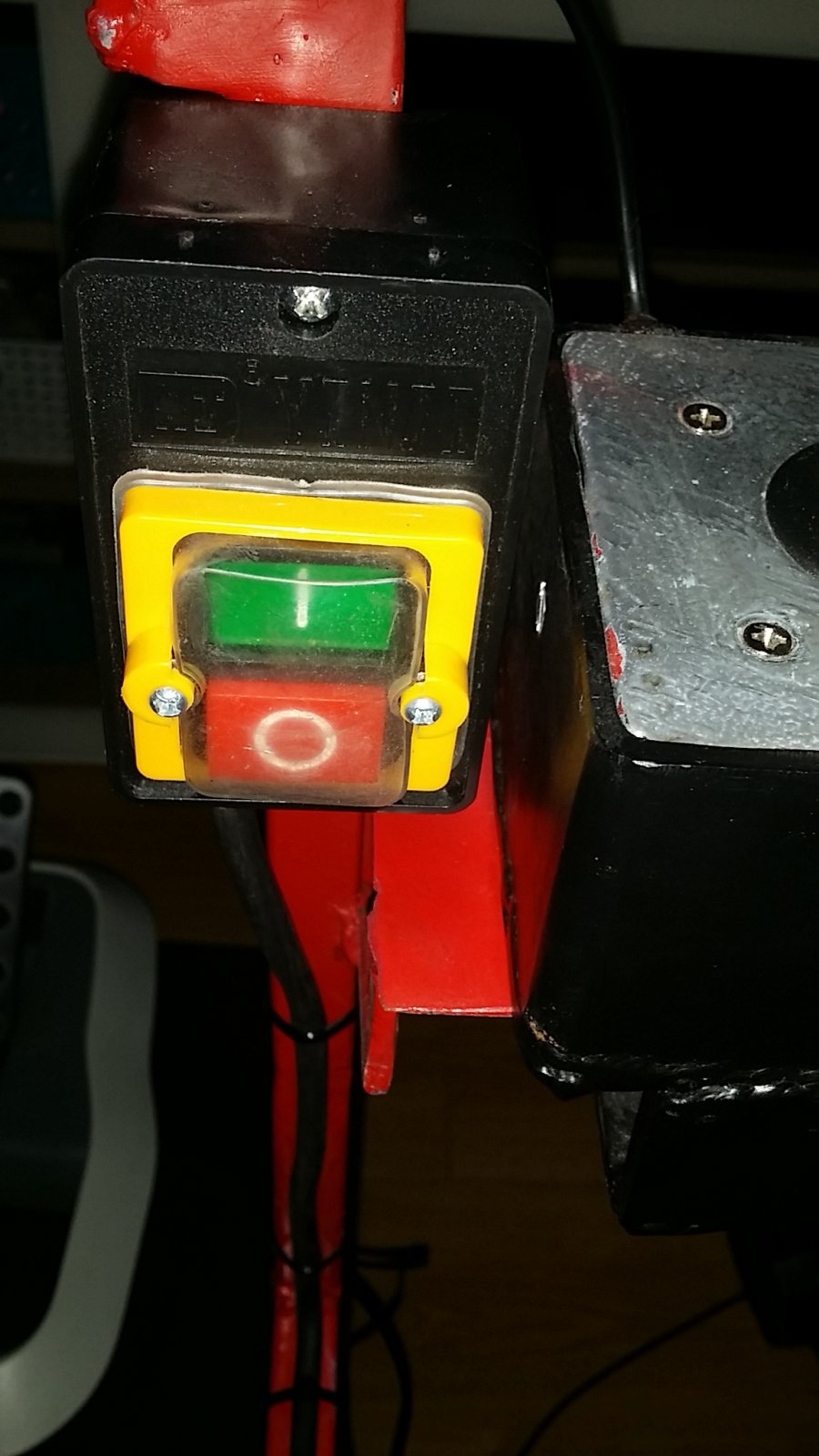

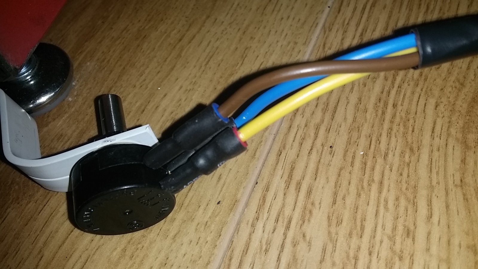

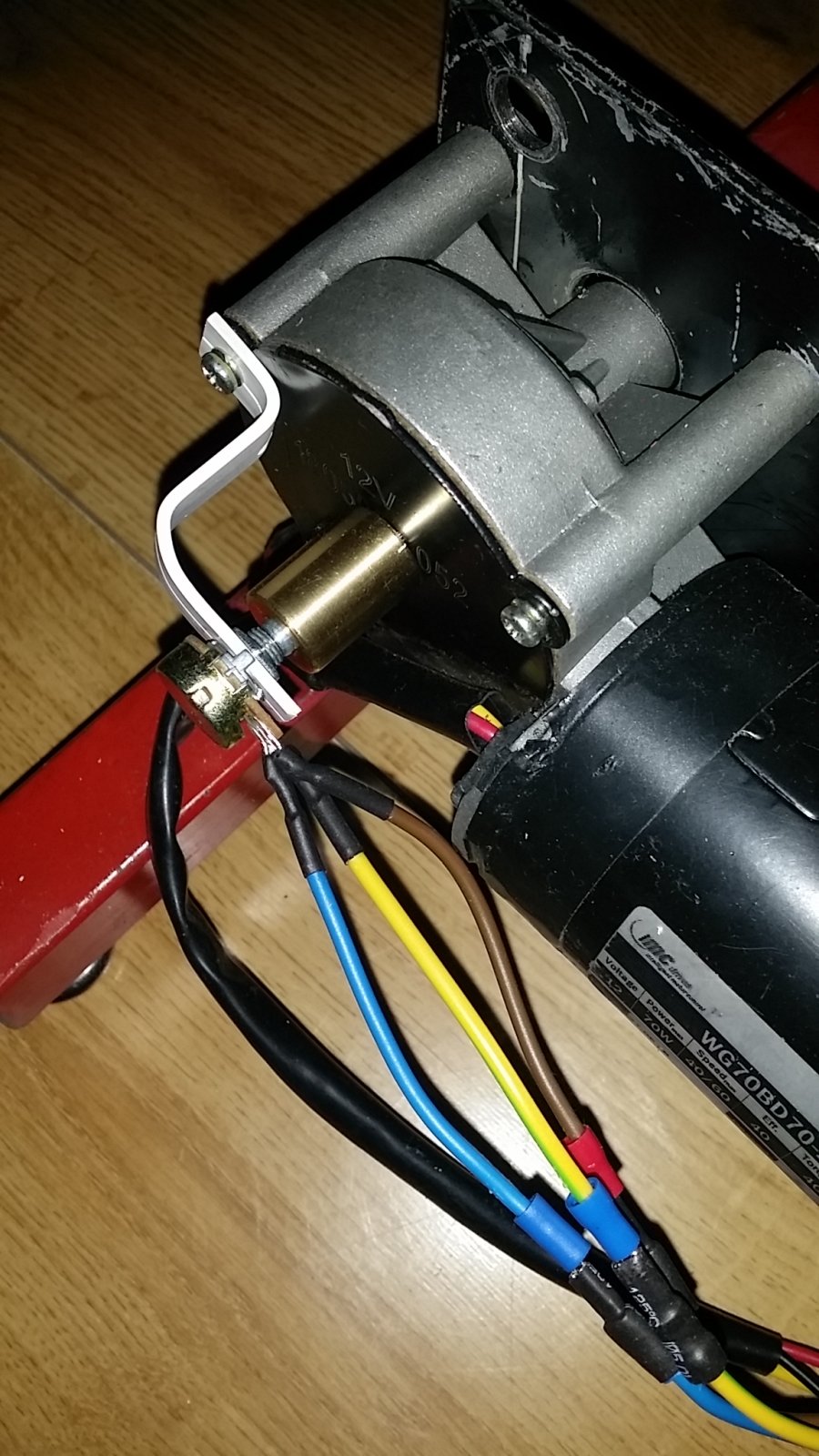

    The potentiometer for the engine
    Potentiometer connected to the motor
    modele engine for playseat
    engine

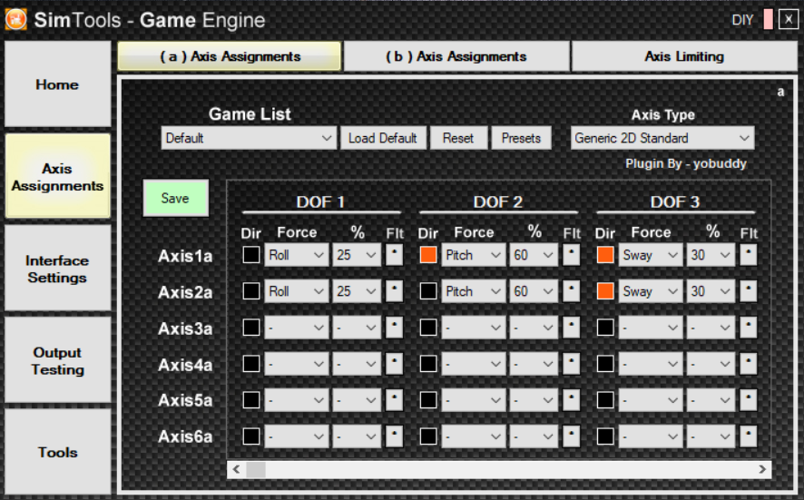

    set SMC3 for engines

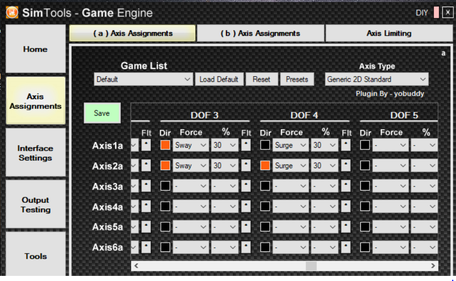

    Set dof simtool for lfs

    H-Bridges BTS7960 43A

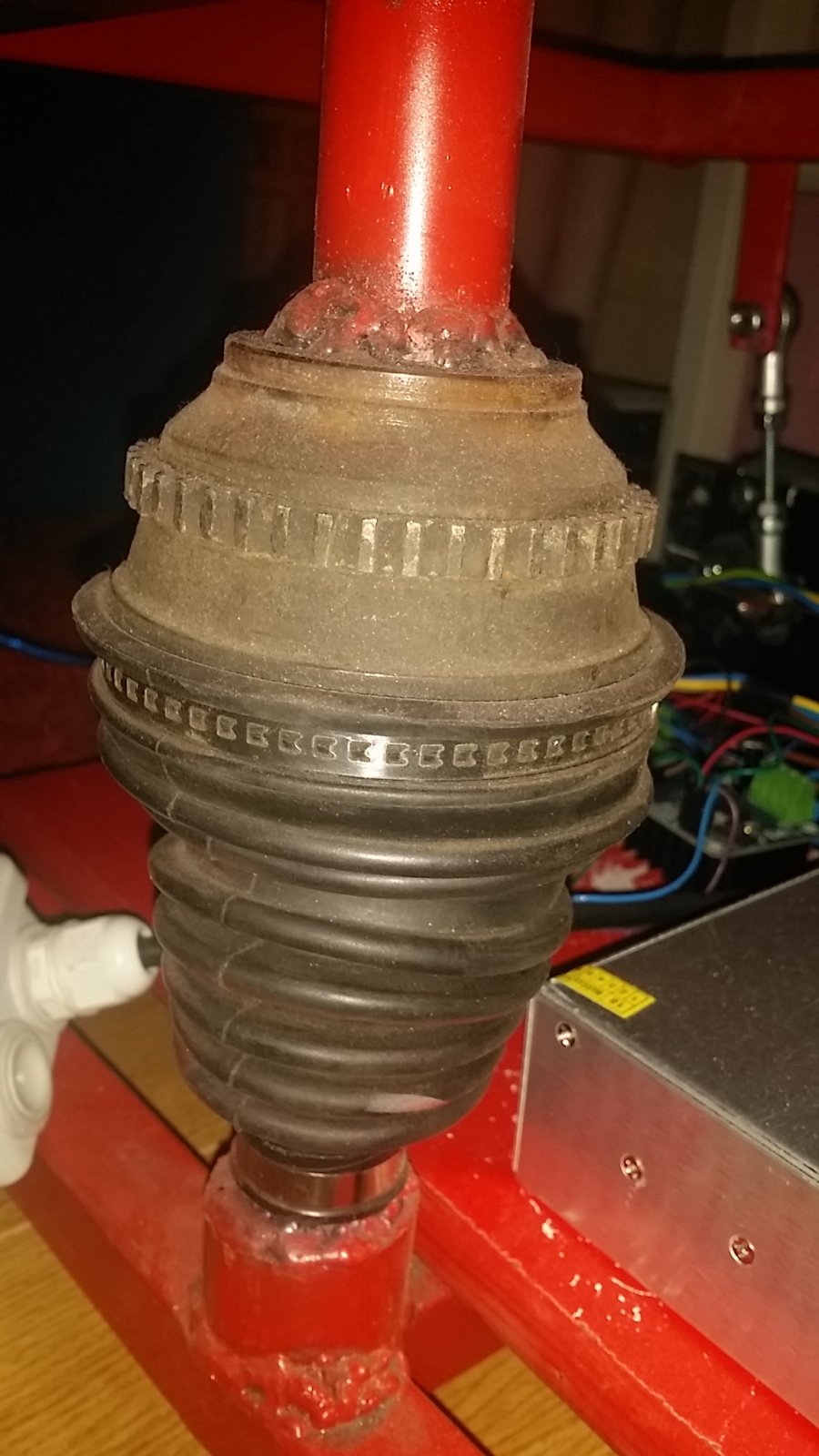

    i use a cardan for axis
    uno R3

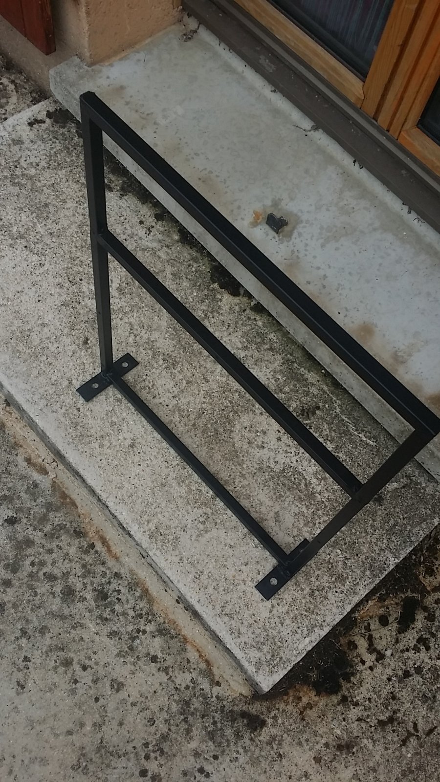

    Support for the moving wheel
    support for Pedalboard
    support for the moving wheel braket
