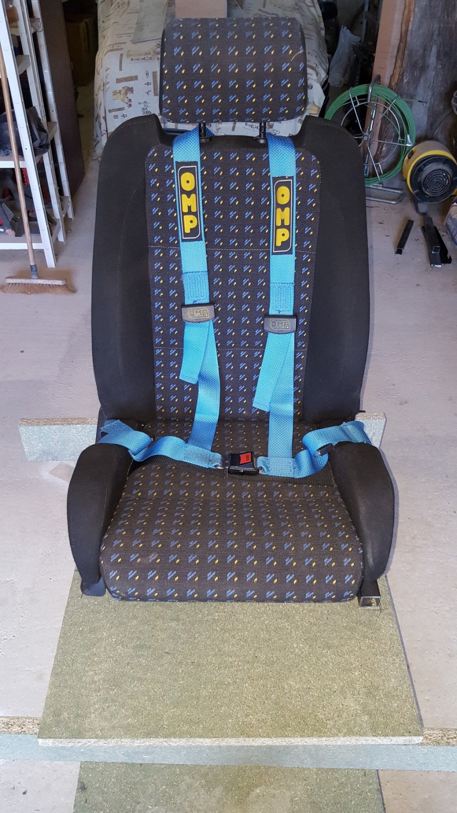

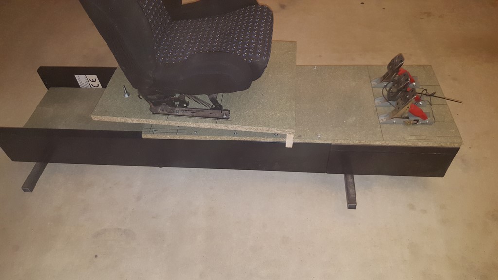

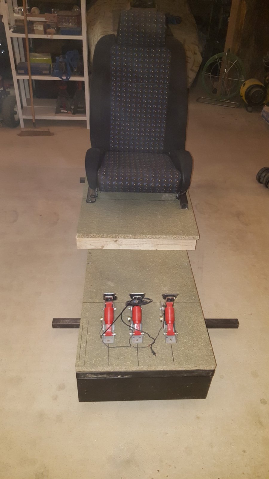

    Hello everyone.
    Finally ... I throw myself into the creation of my 2DOF simulator prototype to begin with to hopefully eventually evolve.
    For now, the creation of the base through one of the masters of this place Wanegain course.
    As salvaged wood, scrap metal, seat ....

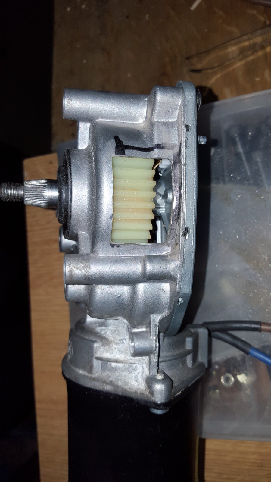

    Purchase at this time: Alim 2x20A, 2x32A Saber Tooth, Arduino Uno, 2 Valeo same reference heavy duty engines that Bebert on which I will take the idea of the knob
    http://www.xsimulator.net/community/attachments/20160123_181309-copier-jpg.28000/
    http://www.xsimulator.net/community/attachments/20160123_181319-copier-jpg.28001/
    http://www.xsimulator.net/community/attachments/20160110_110921-jpg.28003/
    http://www.xsimulator.net/community/attachments/20160113_221611-copier-jpg.28005/
    http://www.xsimulator.net/community/attachments/20160117_174600-copier-jpg.28006/

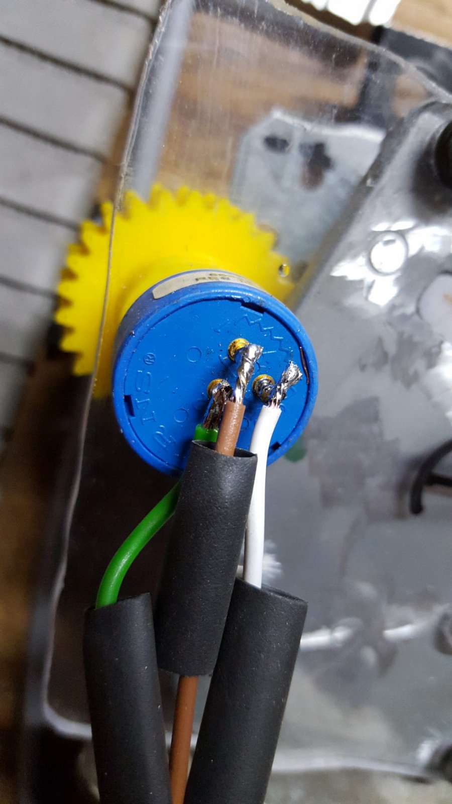

    20160128_221331 (Copier).jpg Progression in my simulator, pose potentiometers.

    could be a short circuit once upon a time:

    Yes he's right maybe you can use heat shrink sheating (en français de la gaine thermorétractable), but you should think before welding :D

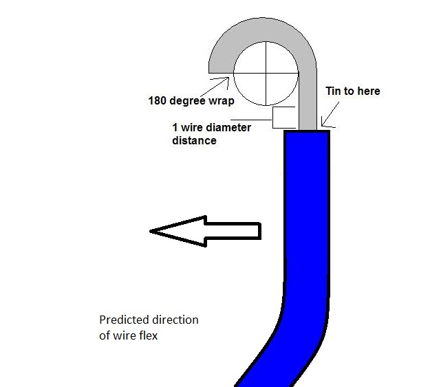

    Also you should really think about re-soldering those connections, butt joints like that will fail after flexing.
    Pin soldering should have the wire hooked around the terminal like so:
    I must admit I have definitely soldered connections like that for a "rush" job but nothing permanent. Pit is definitely right about a good potential for a short across those two pins.
