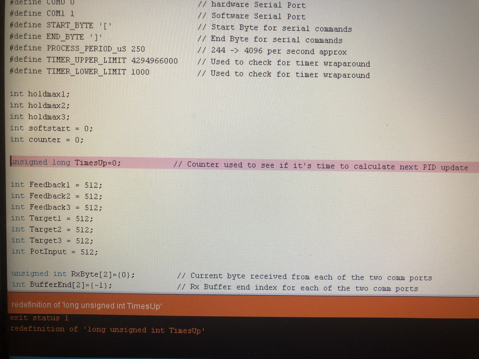

    Hello @BlazinH, I have tried uploading your SMC3 SoftStart changed sketch. I am getting the following error when it compiles and uploads. Any idea? I apologize I am not a programmer by any means. Thanks. 146DA313-F9A6-4775-97E7-6C3509106C4C.jpeg
  16. Gadget999
    1,935
    11,838Coins
    +473 / 9 / -0
    it looks like TimesUp is declared twice
    remove that line and see if it compiles

  19. Bo Howell
    Bo Howell Member Gold Contributor
    Mar 4, 2020
    33
    Product Specialist
    New Sharon, Iowa
    119Coins
    +24 / 0 / -0
    I tried removing that line and it still wouldn’t compile. It says that TimesUp is missing now. Unless I deleted the wrong one? Thanks.
  20. BlazinH
    BlazinH Well-Known Member
    Oct 19, 2013
    2,145
    Oklahoma City, USA
    16,613Coins
    +1,835 / 32 / -1
    Does it say Uno in the lower right corner? If so download the sketch and try again. I just uploaded a new version that fixed a soft soft error but it still compiled fine for me before that.
