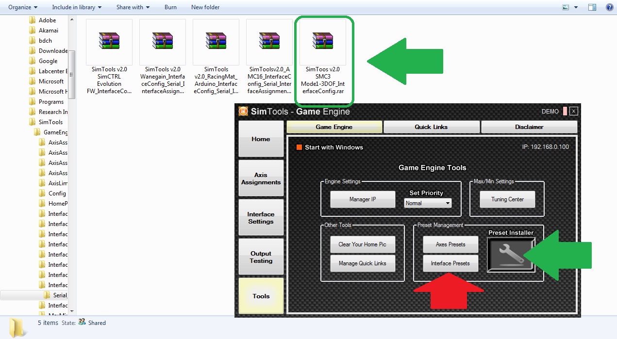

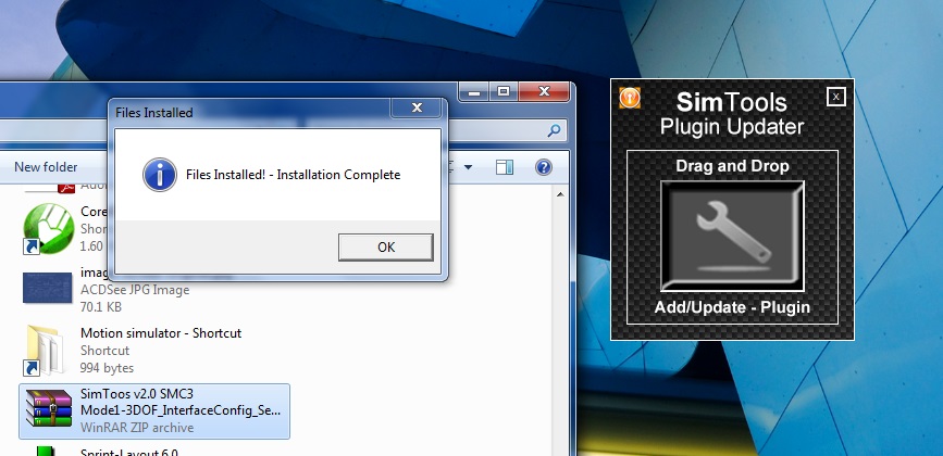

    SimTools v2.0 SMC3 Arduino 3DOF InterfaceConfig ... UPDATED .
    just download the zip file and go for tools => Interface presets ... drag and drop the zipped file there and you're ready to go ...
    Edit :Sorry guys ... the file was not working and updated with a working one :thumbs

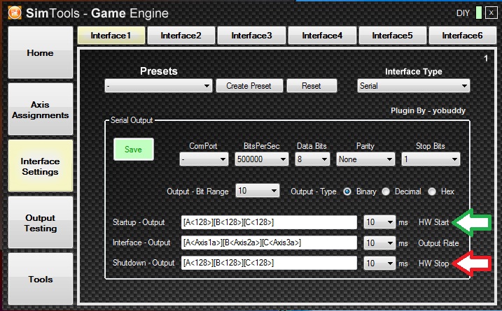

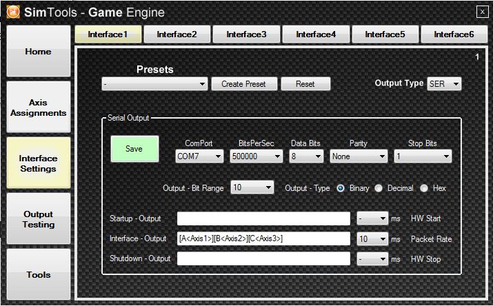

    Center Startup and shutdown strings are the same for v2.0 as the old v1.3 ...
    just copy and paste this in both lines with 10ms sec and save ...
    [A<128>][B<128>][C<128>]

    hi mate im trying to use your prefix file but its coming up invalid
  9. speedy
    speedy Well-Known Member
    Feb 1, 2012
    1,193
    Alexandria , Egypt
    7,931Coins
    +1,287 / 10 / -0
    Maybe you need to extract the zipped file then drag and drop the extracted file to Game Engine preset installer .
    Or use the main Plugin Updater for the zipped file .
