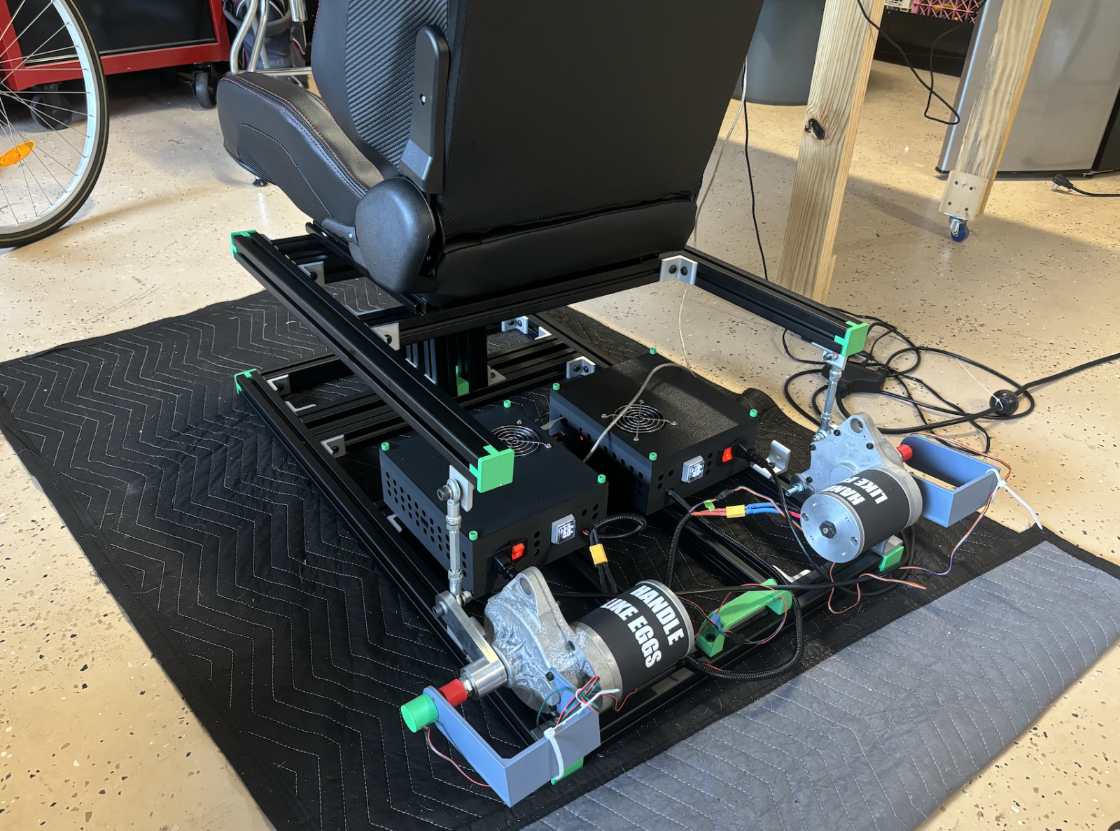

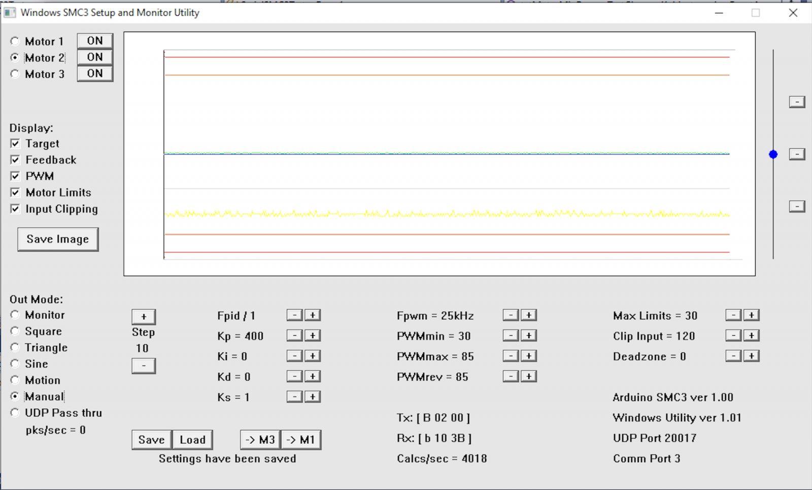

    I am almost done with my 2DoF. I am using SMC3. When the 2nd motor hits about 2 amps, the motor cuts out.
    • 2 IBT-2 High Current Half-Bridge controllers,
    • 2 Mean Well LRS-350-24 AC/DC Switching Power Supplies
    • 2 24v DC Jazzy wheelchair motors.
    I also have an amp meter that monitors the amperage pull. I have attached my SMC3 Utilities settings. I have adjusted the PMWmin from 10 to 50 and it has no affect. I also moved the seat up about 3 inches to get some better leverage.
    Any help is appreciated!

    If you swap the motors to the opposite IBT2 does the issue follow or not.
    If not it may be a faulty IBT2, as members have reported issues running them at 24v, and often limited them to a bit less than that.

    Thanks! - The was the issue. I turned down the voltage output to ~21.7v and that solved the issue.
    One more question - Where can I find information on how to make it a little less jerky aka "smoother"?
