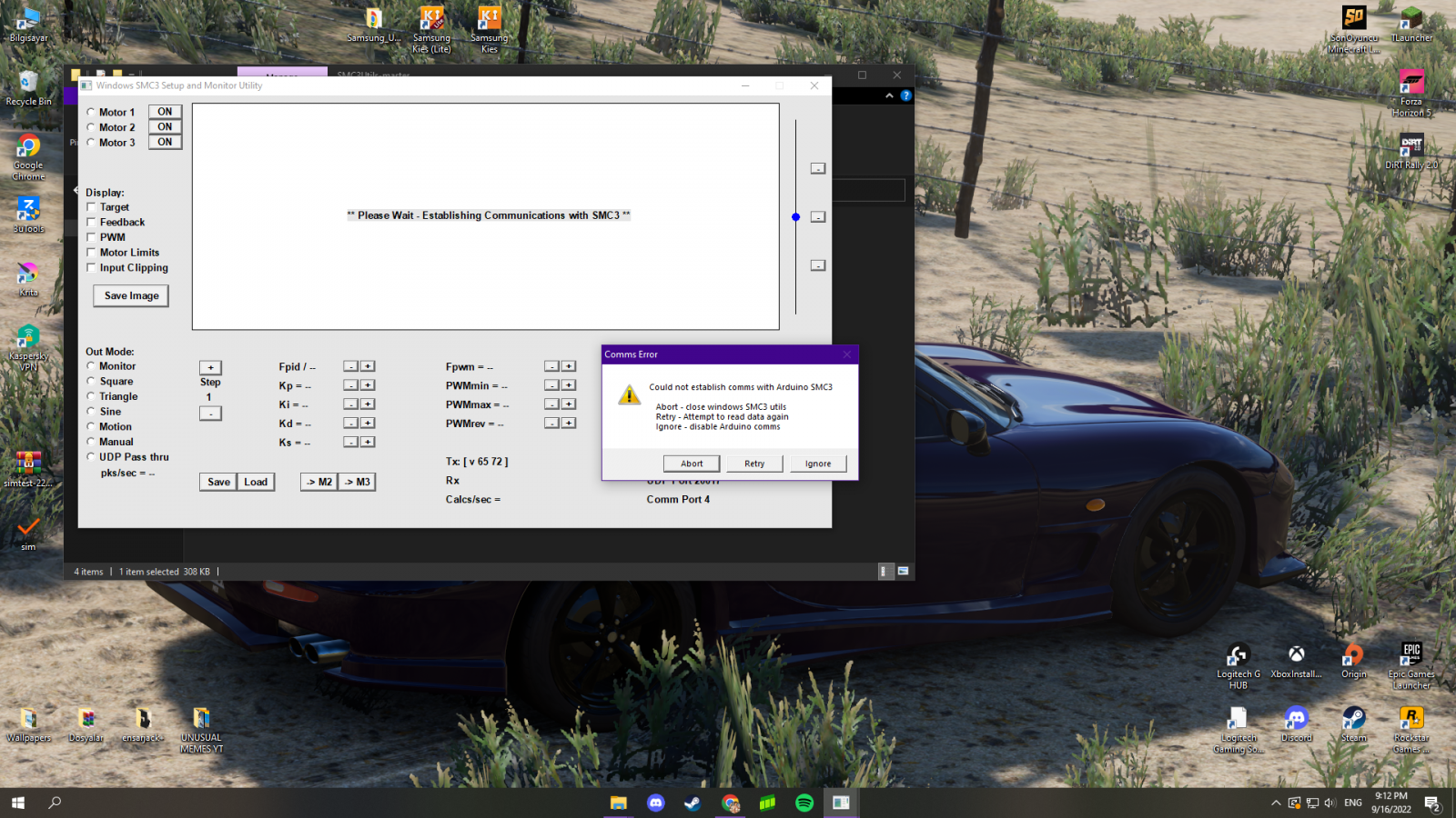

    hello i am new
    can you help me with this problem

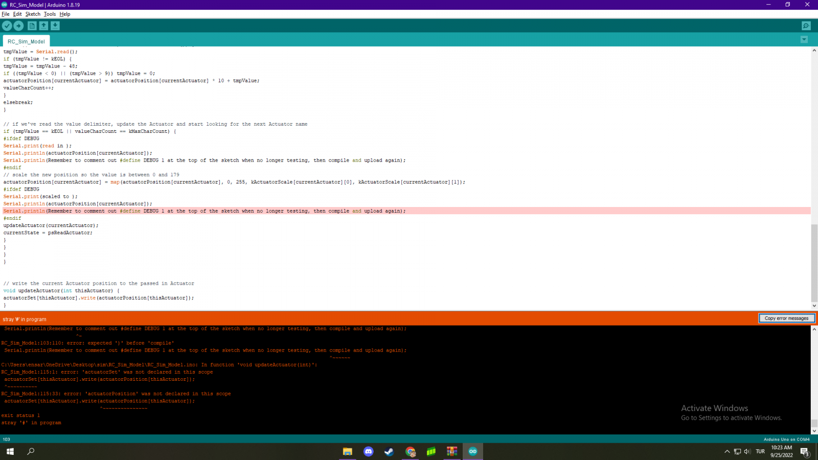

    Comment out the Debug line like this: // #define DEBUG 1

  8. rasim
    rasim New Member
    Sep 13, 2022
    10
    68Coins

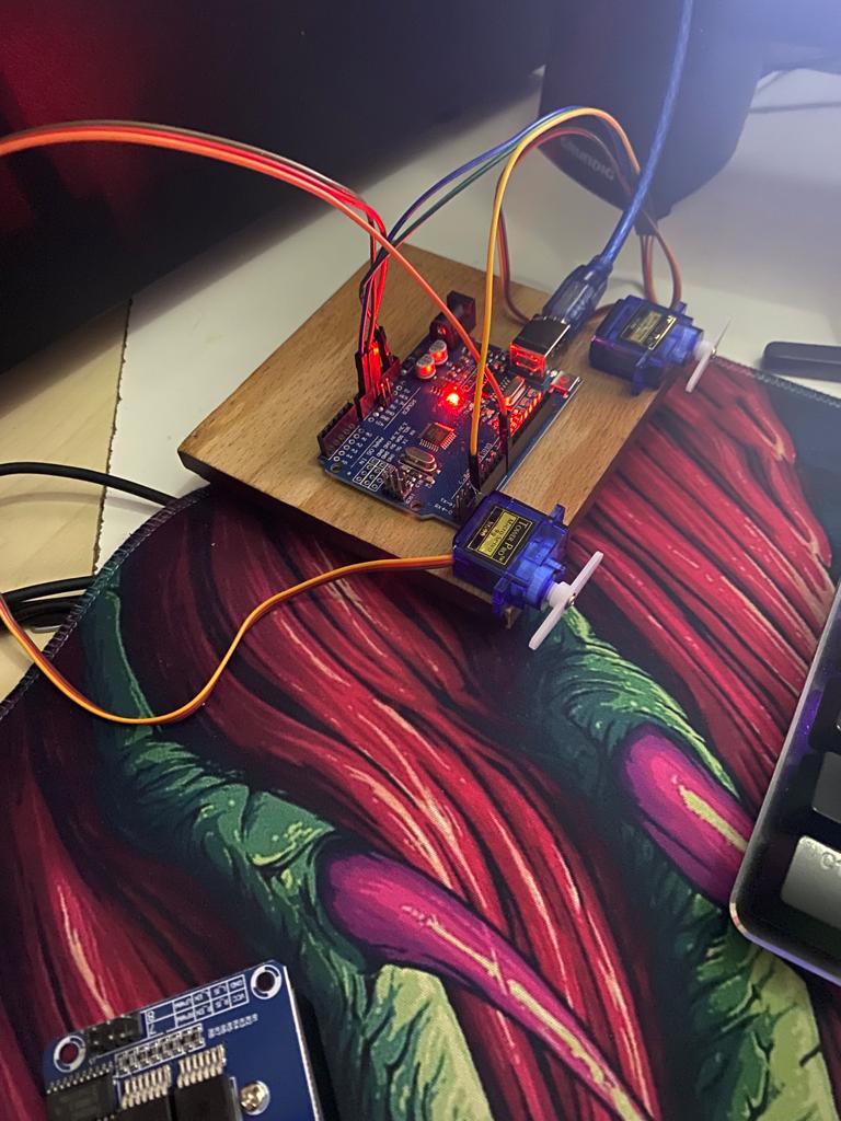

    the servos must have been bent where am i going wrong
    this is the code i used

    Has the code successfully flashed to the Arduino and is SimTools set up as per the instructions?

    yes, the code is already loaded, otherwise would the servos work?
  12. noorbeast
    21,337
    149,687Coins
    +10,954 / 54 / -2
    The Arduino will need to be configured in SimTools as per the instructions, you will need create a Default profile and then test in SimTools Output Settings.

    I understand, I will check from the beginning
