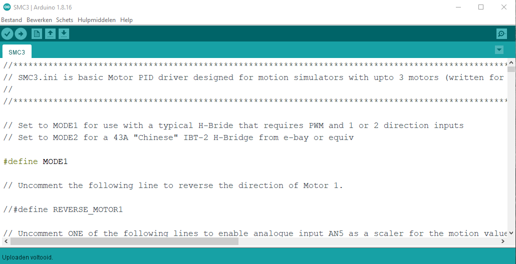

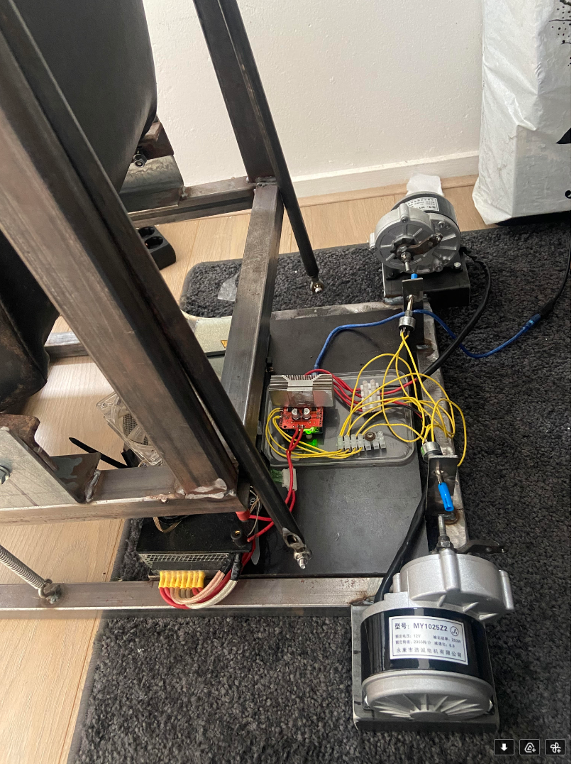

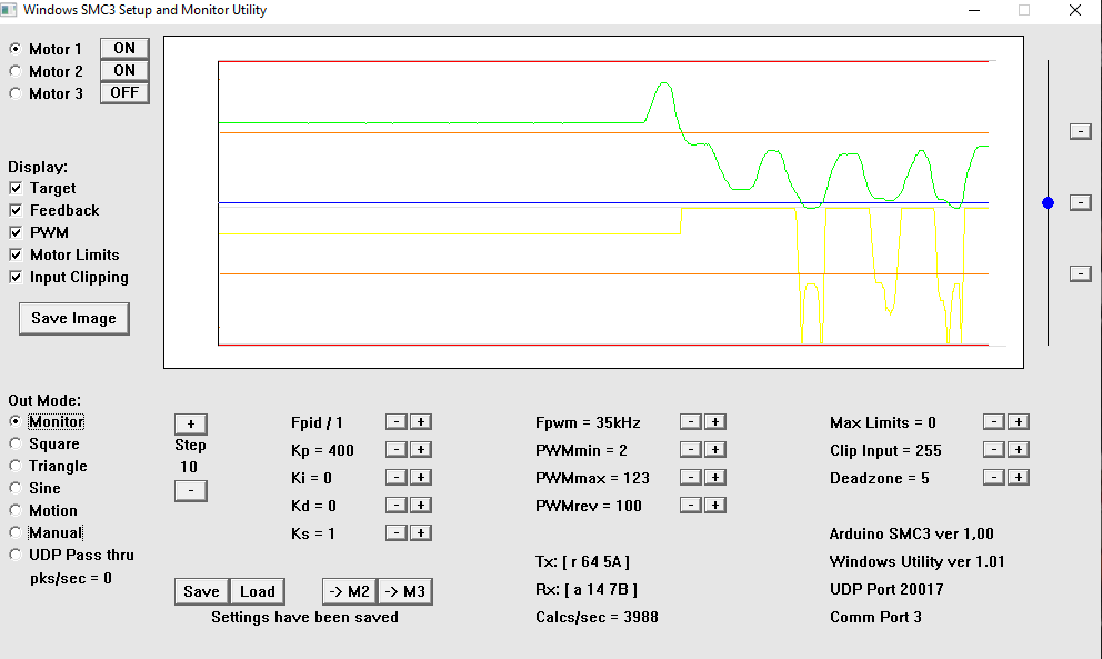

    Hello, i've been getting my rig up and running again. Last time i used it i used another software which is down so i cant use it anymore. The Arduino program stil ran fine after installing my recent new motors (Wheelchair) Instead of wiper motors.

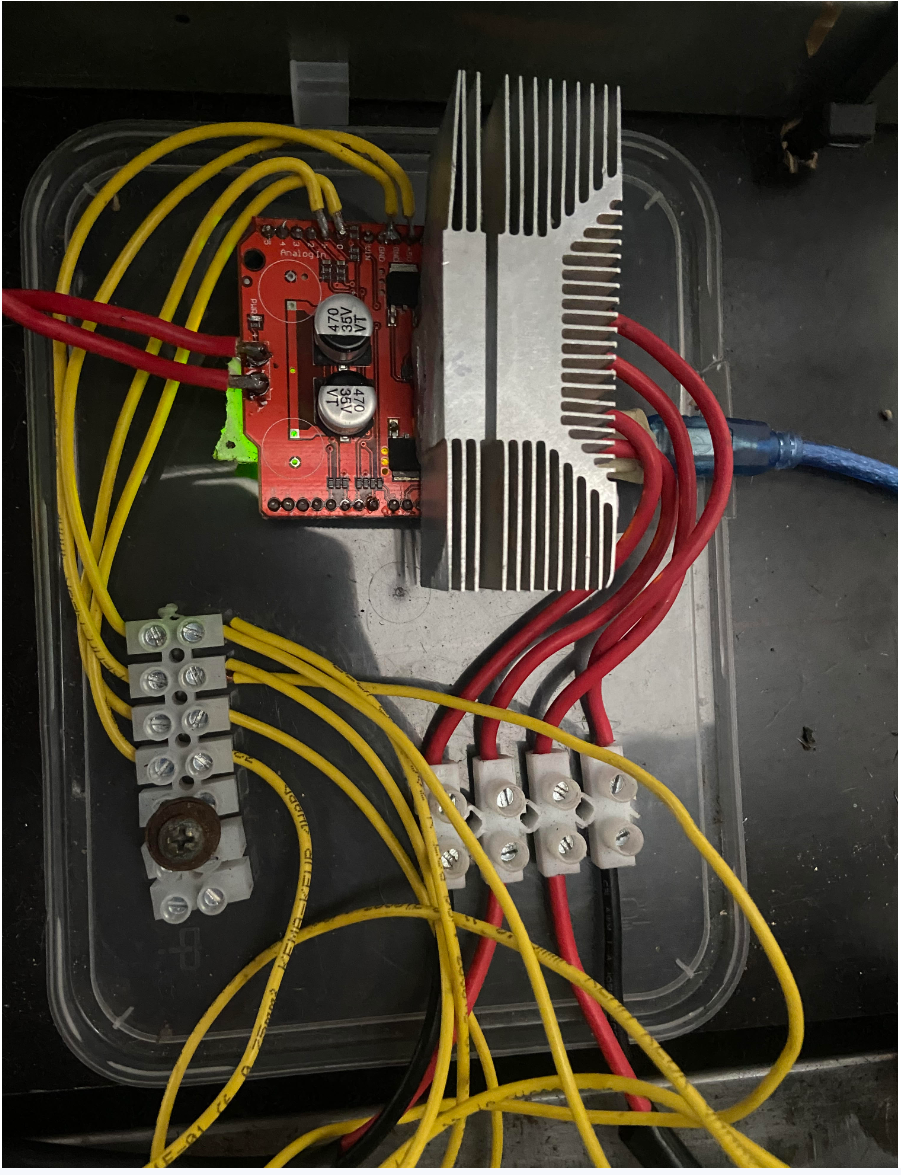

    Now when i boot the SMC3 software in the Arduino, load up de smc utility's. I can see my pots giving feedback. But no motor is giving a kick. Once bumping the PWMmax around from 0 to 50, each step the right motor wil give 1 rotation. Every change of settings it wil do that.
    If i bump up motor 1, it wil activate this right motor. Also if i bump up motor 2 the same motor wil start turning. 1 spin and nothing more.
    I really dont know where i am going wrong, and i cant find the specific problem in the forum with a motomonster
    I am using a moto monster , it stil works with the other program so the board should be fine.
    Defined mode 1 in the smc3 program.
    upload_2023-2-6_10-8-16.png upload_2023-2-6_10-8-29.png upload_2023-2-6_10-10-19.png upload_2023-2-6_10-11-5.png

    Some suggestions.
    First check the MM: https://www.xsimulator.net/community/faq/monster-moto-testing-before-use.158/
    Then if all is fine ensure the pots are centered in SMC3 and attached to the motors.
    Then follow the SMC3 setup routine, I am suggesting starting from scratch as currently you have Max Limits at 0 and it is hard to guess how you came to decide the values you are currently using:
    8. Set Kp to about 400
    10. Do the above for each motor

    The MM board should be fine, as of it had worked before. It stil works when i load the other program. Motors move according the pots. I wil reload the smc with the basic settings according the toturial. And try again

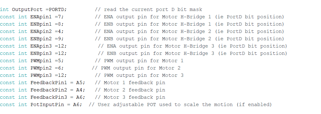

    As i follow the program i see that later on they use the pin numbers instead of the directed pins in the top. Ill swap the wiring and test again. A shame i cant stack them
  9. Diggle
    Diggle New Member
    Dec 1, 2021
    6
    31Coins
    Redoing the wiring, like the picture of the toturial works. Downside is stack is not possibile which is very annoying because i need more space for the board.
    Motors behave as they should. Sorry for this dumb mistake..... Thanks alot for all help everyone, ill be back with my next stupid problem :):):):)

    Indeed, the coupling is not correct due to the pin assignment, something was wrong
