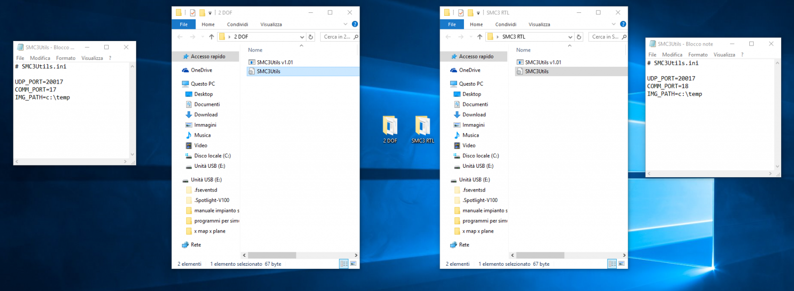

    hi mate to get the second ard working in smc3 you need to make a second smc3 folder.. i was told this info mate so im repeating it in no way did i get this working on my own...The credit must go to Avenga76 and BlazinH thanks heaps guys
    call your first folder smc3 2dof and the second smc3 rtl. copy and paste the smc3Utils and the smc3Utils1.01 to both folders
    this allows you to change the com port for both ards for me its 9 and 10
    so my smc3 2dof com is 9 and my smc3 rtl. is com 10
    in simtools run the second ard as interface 2

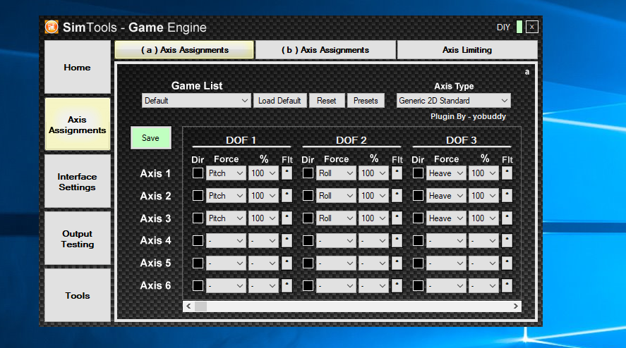

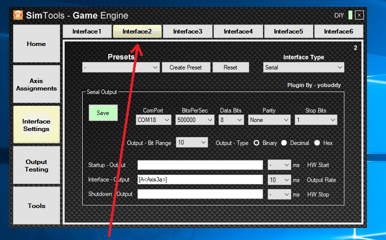

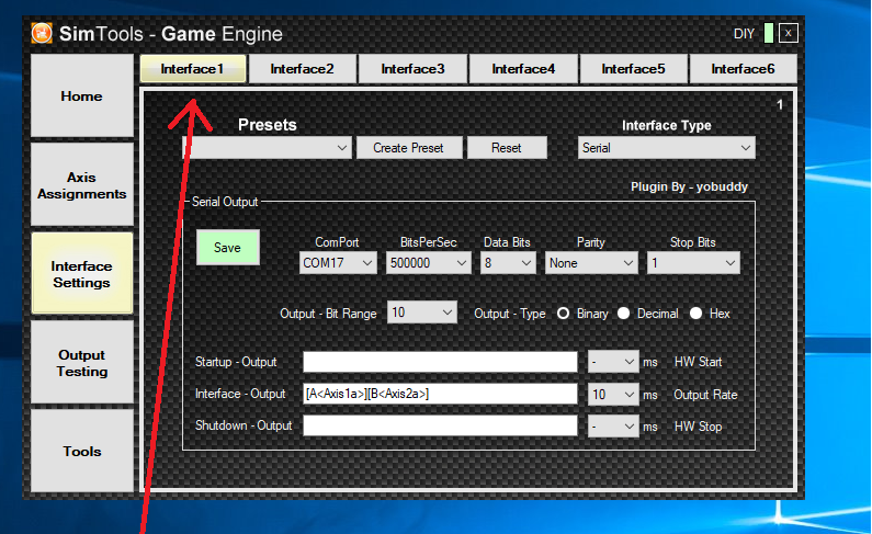

    Hi friend Evan,
    thanks your help was important to me
    I kept the two Arduino boards and I made the two folders.
    In msc3 all 3 motors work but Simtools only works with interface 2 and therefore with motor 3
    Engine 1 and 2 from simtools do not move.
    in interface 1 I put com port 17
    in interface 2 I put com port 18
    as I set it on smc 3
    Do you have any idea?
    Best wishes
    Mauro
  9. Avenga76
    Avenga76 Well-Known Member
    Jun 29, 2014
    518
    Network Engineer
    Auckland, New Zealand
    3,261Coins
    +858 / 6 / -0
    Can you take screenshots of your interface settings in SimTools so we can see if we can spot any mistakes.

  11. Blame73
    Blame73 Well-Known Member
    Nov 6, 2014
    1,215
    8,295Coins
    +1,127 / 2 / -0
    Maybe I'm worng, but I would have put what you now got under
    (a) Axis Assignments > Axis3a
    under (b) Axis Assignments > Axis1b
    then in Interface2 write [A<Axis1b>]

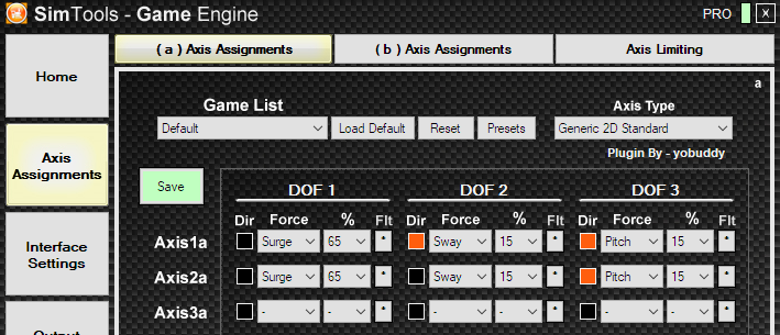

  12. Blame73
    Nov 6, 2014
    1,215
    8,295Coins
    +1,127 / 2 / -0
    Also, the sum of your axis% is maybe 600%, while it should be around 110/120% (for me it's the best), otherwise when one force reaches its 100% there's no more room to feel the others.
    take a look at mine settings (yes I know, I love feeling the gear change that's why I got Surge that high compared to the others...)
    PS: sei italiano? EDIT: si, ho letto ora. Catania

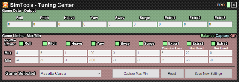

  19. noorbeast
    21,395
    150,025Coins
    +10,993 / 54 / -2
    Please post pictures of your settings. A video where we can see the rig movement and game screen at the same time also helps.
    It sounds like you need to refine your motion profile: https://www.xsimulator.net/community/faq/steps-to-create-a-motion-profile.228/
    In particular make sure you capture the base Max min values in the tuning center.
    Once you have the basics sorted then you will likely need to also use some smoothing and washout gain and return in the filters.
  20. Blame73
    Nov 6, 2014
    1,215
    8,295Coins
    +1,127 / 2 / -0
    Yes, sounds like you haven't configured your tuning center, have you?
    Once in a game you have to 'Capture max min' (average car, average speed), then save new settings.
    You can also write the numbers to your liking if you want to. The lower the numbers (as in my case Surge 1 -1 for better feeling acceleration and gear change), the higher the force of the axis
    una volta che avvii un gioco avvia il tuning center upload_2018-1-25_21-30-44.png
    e premi 'Capture Max Min' con una macchina di media potenza ad una velocità media. dopo un po' salva i settaggi.
    Se vuoi puoi inserire i valori a mano (ricordati di salvare). Più bassi i valori che inserisci (come nel mio caso Surge 1 -1 per sentire l'accelerazione ed il cambio marcia), più sentirai la forza di quell'asse.
    Ciao
