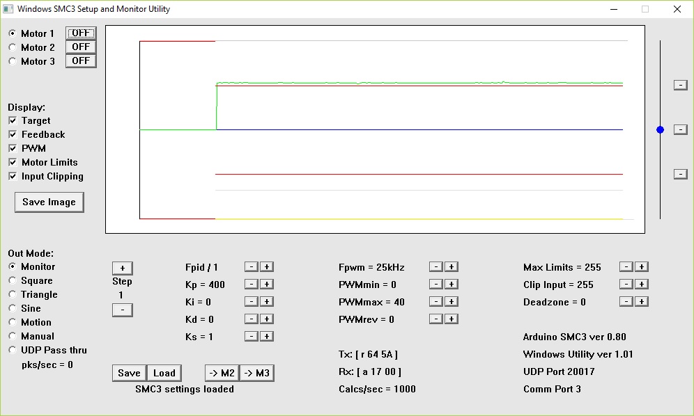

    After a year offline I am trying to get my sim working again. It is a 2DOF Simukit running an Arduino Uno and a sabretooth 2x32.

    and the testing worked OK in SMC3, the motors moved when I raised PWMmax to 40. I then tried it with Simtools and got nothing so I went back to SMC3 but the on/off button wont stay set to on anymore.
    This is my SMC3 screen. Whenever I click 'On' for any motor it immediately returns to 'off'.

    Usually the reason for SMC3 to turn the motors off is that the potentiometer has exceeded its max or min value. This is a measure for protecting the mechanical setup.
    Try to manually move the motors back into their neutral position. After this, SMC3 should keep the motors on again.

    Ah that indeed gets SMC3 working again. I think I will need to do some more SMC3 research though as have little idea on what the settings should be :(

    Actually the problem seems to be the motors just spin 360 degrees and then cut out when the pot limit is reached. Every time it does it and I manually move the pot, the motor spins the same way again until it cuts out.

    Try reversing the motor direction by swapping motor leads.

    Back at it tonight with large success but not quite 100% :)
    I have the sim being controlled by SMC3 and both motors behave as expected, except I can't stop them moving without shutting down SMC3.
    If I then try using Sim Tools then nothing happens so I guess something in the set up is wrong for SMC3 and Sim Tools.

    Turns out the issue was just I had the pot sensors wired the wrong way round, we move onwards to SimTools!

    Reversing the motor leads as suggested has the same effect SMC3 Testing. When using hall effect pots reversing the motor leads is the only way.

    Luckily it was just a push pin swap on the Arduino, the delay was having to work a lot :(
    I now have SimTools running in test mode, that was being blocked by my firewall.
