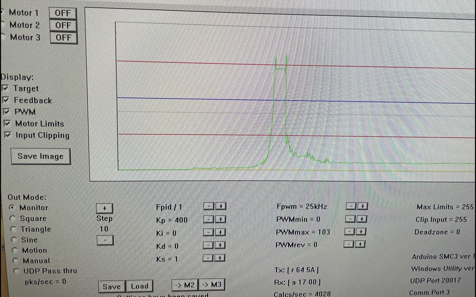

    I got to the part where I use SMC3 Utility to make sure motors work and to properly tune it. I was increasing my PWMmax up and the motor never ended up spinning and I was already around 100. Not sure why that is. I would love to see if someone knows why it would be like that.

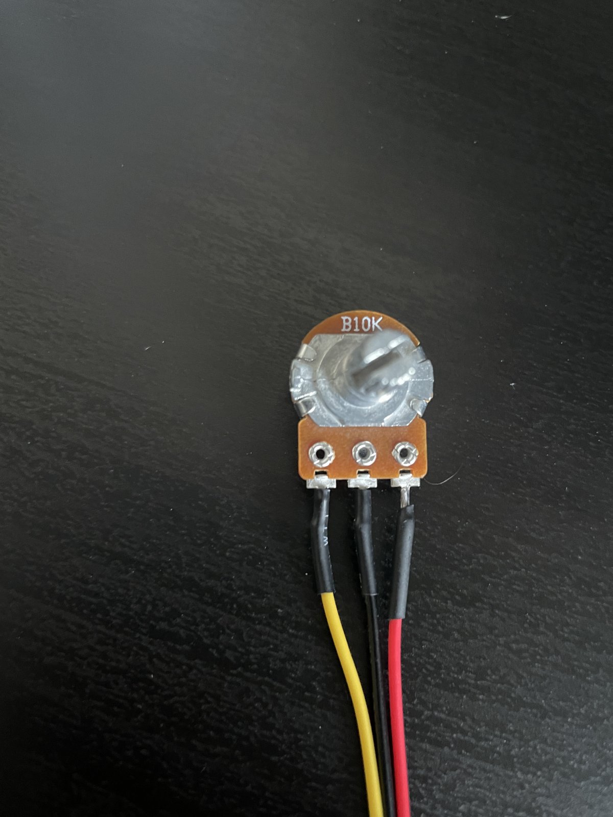

    Something that I noticed is that my potentiometer (green) is at a very low position and not towards the middle. After I got to 100PWMmax I decided to twist the potentiometer and see if its working still but it will only have movement in the last 90% of the twist and spike up like in the image. The potentiometer I use will be linked below. Has anyone used these potentiometers?

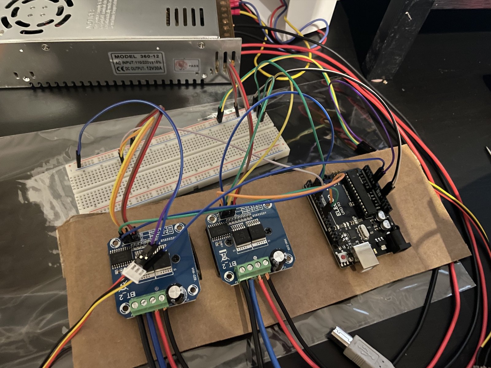

    Also I am pretty sure I burnt out both of my motor controllers after twisting the potentiometers because they smelled burnt. This is how I had everything for testing.

    Was the code set to Mode 2 for the IBT2s?
    Are the pots connected to the motors?

    Yes the I changed the mode to 2.
    They were not attached, I am going to 3d print mounts later for them.
    I kept messing around and twisted the pot to show the green line above the motor line and it worked for motor 2. I am almost positive somehow the first motor controller ended up frying itself.

    What motors are you using?, are they ground isolated? if not the IBTs will burn out quickly ( especially with wiper motors),
    check if any of the motor's wires are connected to the motor housing, you can do this with a multimeter in continuity mode.

    Swap the h-bridges around. If the problem persists it's not the h-bridge that's burnt out.

    Thank you everyone for your help. I figured out the issue. I was being dumb. So if anyone stumbles upon this post and they have the same issue that I did, this is how you can fix it.
    What went wrong: It's always the darn wiring. The way the potentiometer works is it has the positive/negative leads on the end and the range pin is in the center. I was being dumb and the potentiometer that I bought as shown in the picture isn't wired that way. I assumed that maybe there is a reason why black was in the center and yellow was on the edge so I plugged negative to black and Pin A0 to yellow.(WRONG)
    What to do: In fact now that I read some more about the potentiometer I decided to plug the black wire(center wire) to A0 and it worked.
    Lesson Learned: Never trust the wire color from manufacturer!
