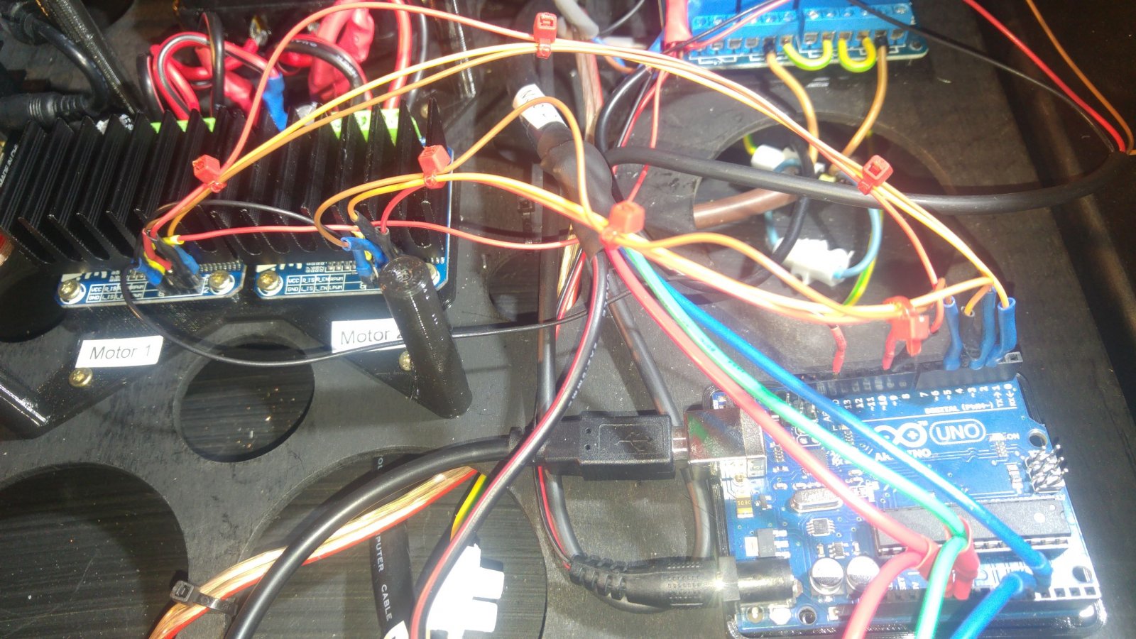

    Hi Guys. I'm new here. XSimulator inspired me to finally build a flight simulator. The frame is ready so far.
    The wiring I have taken from this great forum (see picture).
    The two H-Bridges 43A you know, I have only remounted the heat sink on the opposite side.
    When I press "Motor on" in SMC3Utils, the switch will remain OFF.
    The motors remain dead accordingly.
    Even if I position the pots in the middle position.
    For SMC3 V1.0 I also set "#define MODE2".
    Wiring I have also tested several times.
    Do you have any idea what I can do?

    In the SMC3Utils the green line in the graph should move up and down as you turn the pot by hand. Does it do that?

    That was a good hint.
    I noticed that the green line was very blurry. After I removed the ground of the electromagnetic shielding I had a much better signal (don´t knwo why, but it´s true).
    Know I can switch the Motors on.
    Thank you !!!!!!:thumbs

    In my case I removed the grounding of the poti-cable at one side (only one side of the shield remain at grounding).

    The first thing you should have is a stable potentiometer signal, once it is stable to adjust clip and dead zone if it exceeds those lines it will automatically turn off the engine, it may be necessary to restart arduino to re-select on

    That's my problem. it's bad connection pot signal so its alway turn OFF the engine. thanks so much
