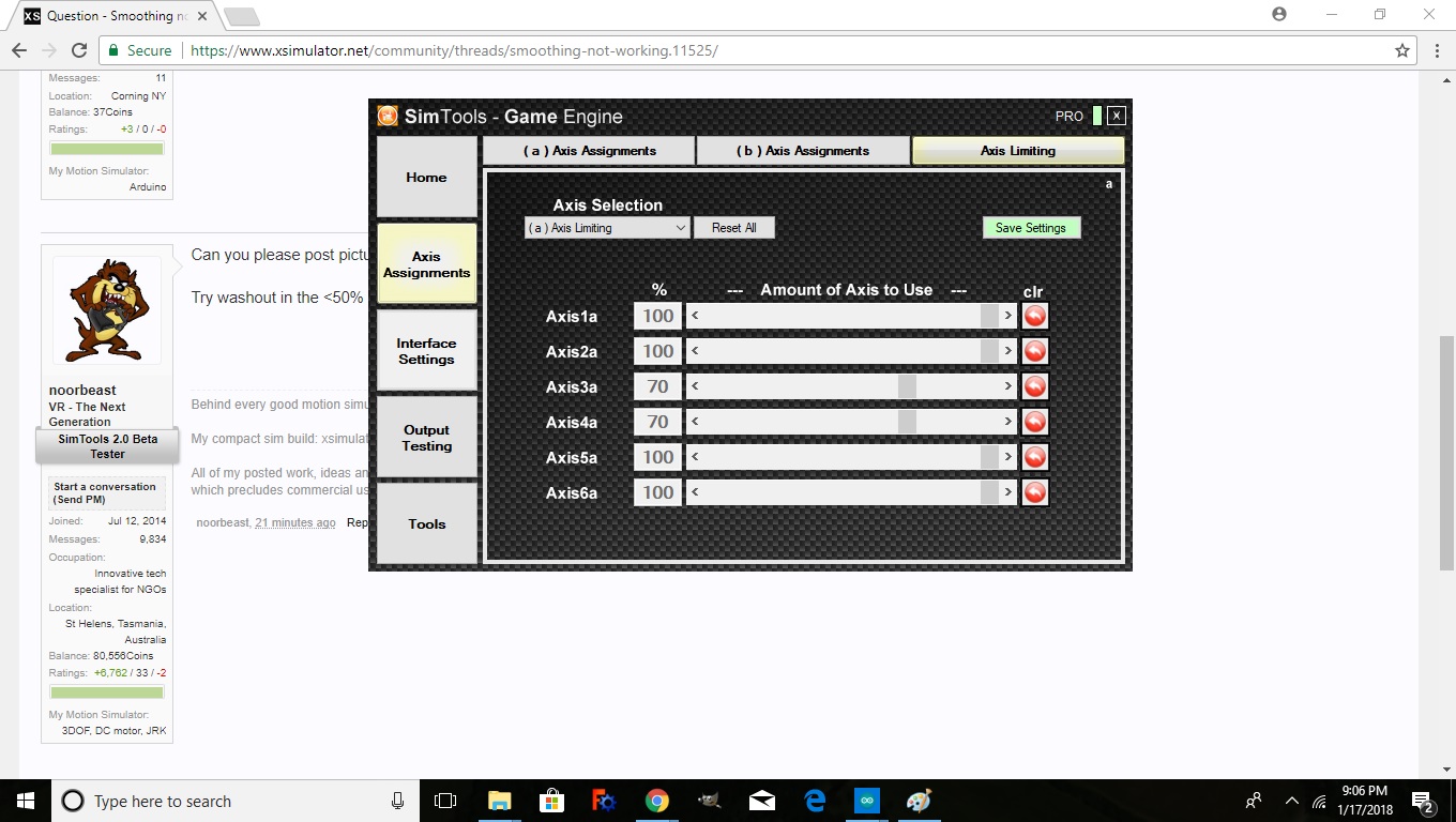

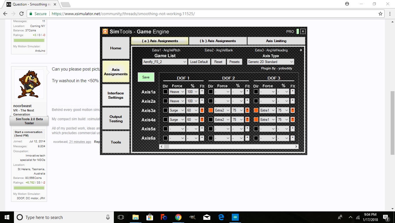

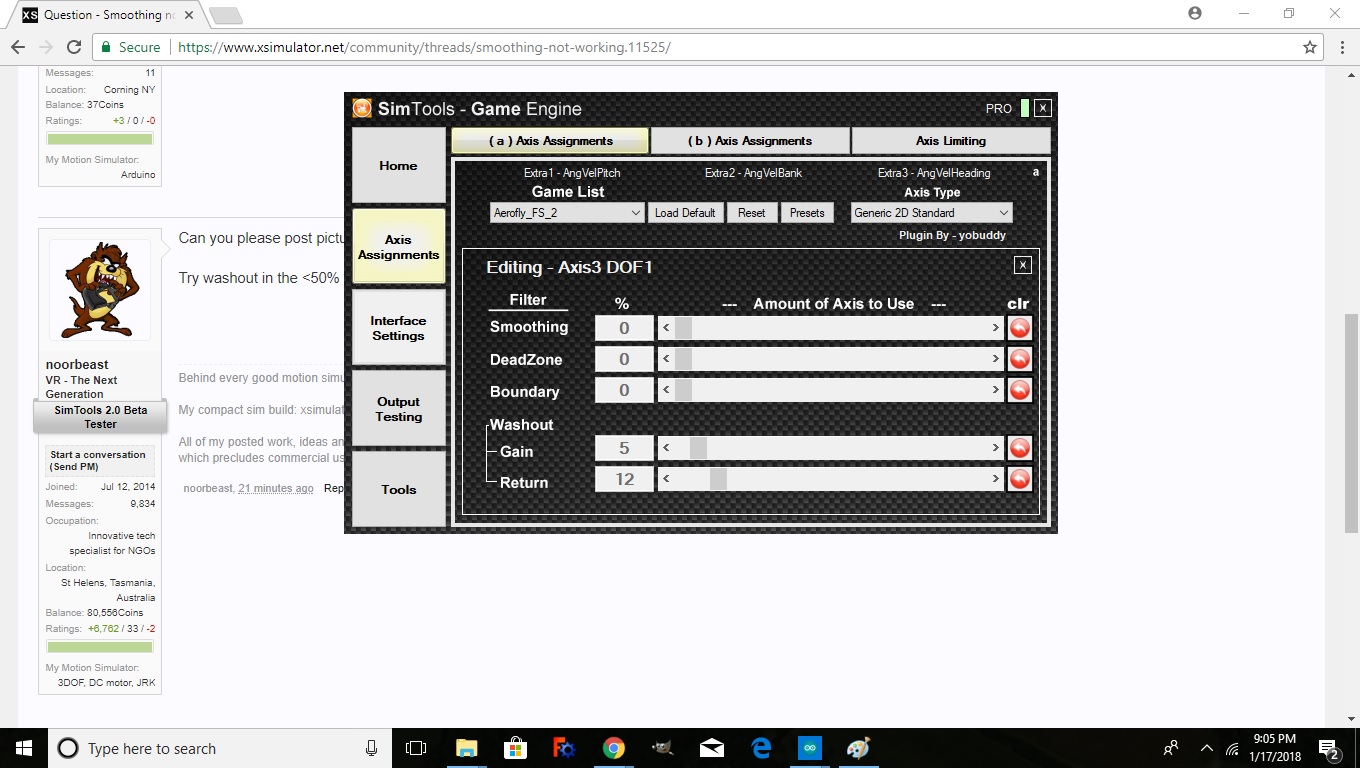

    Here are the screen shots of the settings. I have played with the washout, but it seems to take way to long to come back to neutral. I will play with it some more while you look at these.
    I am only working on the Surge flaps at the moment. Washsout is the same on all DOF. I have tried a number of positions in smoothing, but can feel no difference.

    Turn the "Return" speed up

    It feels better with no washout at all, but still feeling the chattering, I can hear it too. Smoothing seems to have no effect with washout off either.

    Turn it all the way up?
    If you getting "chattering" everywhere, use the Main slider in the Profile editor of Game Manger.
    It adds smoothing for all outputs in one full swoop!
