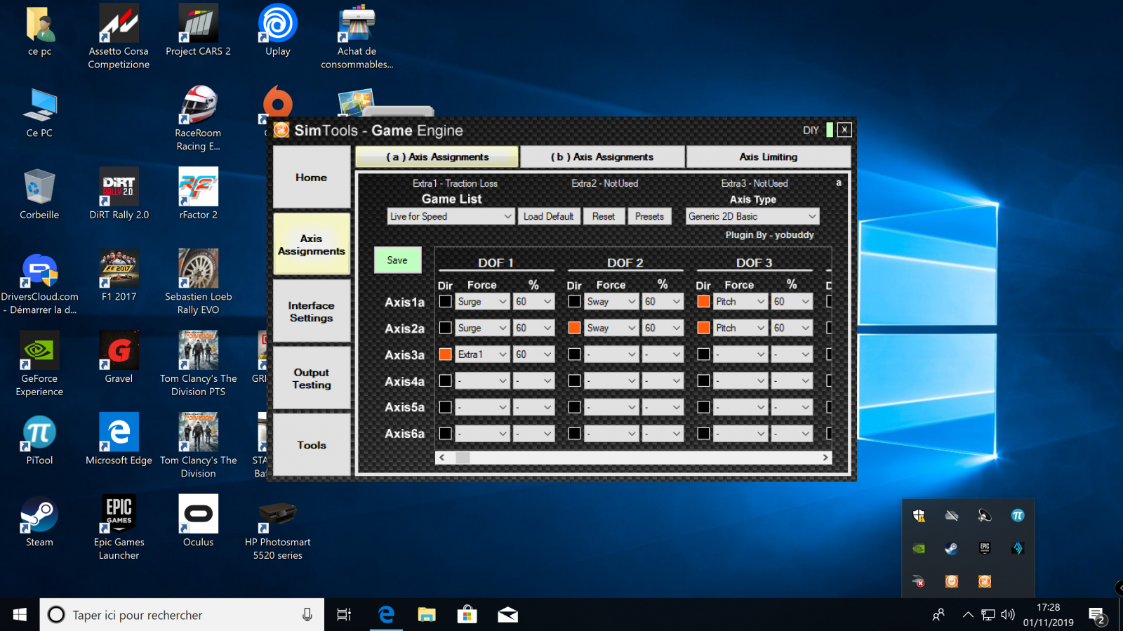

    I'm a very beginner with the software.
    I've have purchase the T1000 3Dof, but when I try to test the axes, it doesn't work (It tells that one of the interface requires to restart the GameEngine. I do that, but after, it's the same message....).
    It doesn't work also when I want to had a game with the Simtools PuginUpdater....
    Anybody can help me.
    Bets Regards
    21,032
    147,890Coins
    +10,880 / 54 / -2
    You will get this message if one of the actuators can't startup, or has not initialized.
    Also please post pictures of all of your settings.

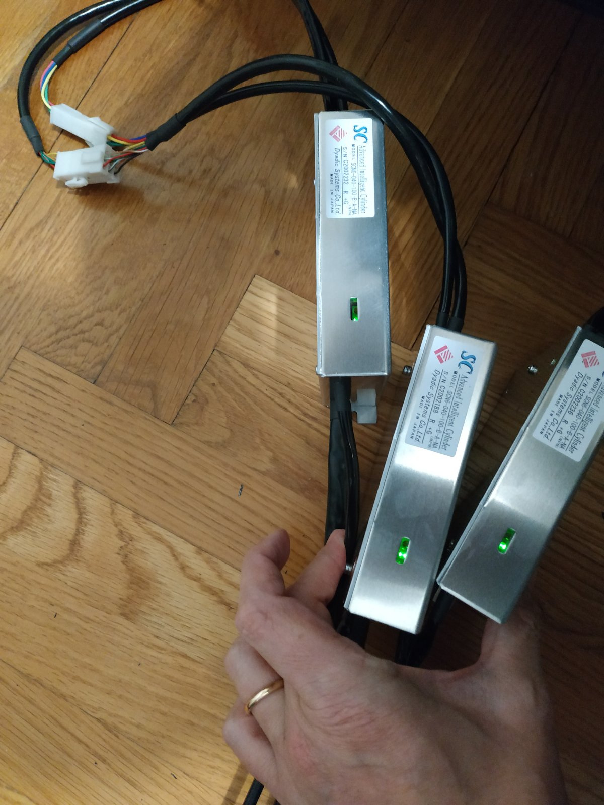

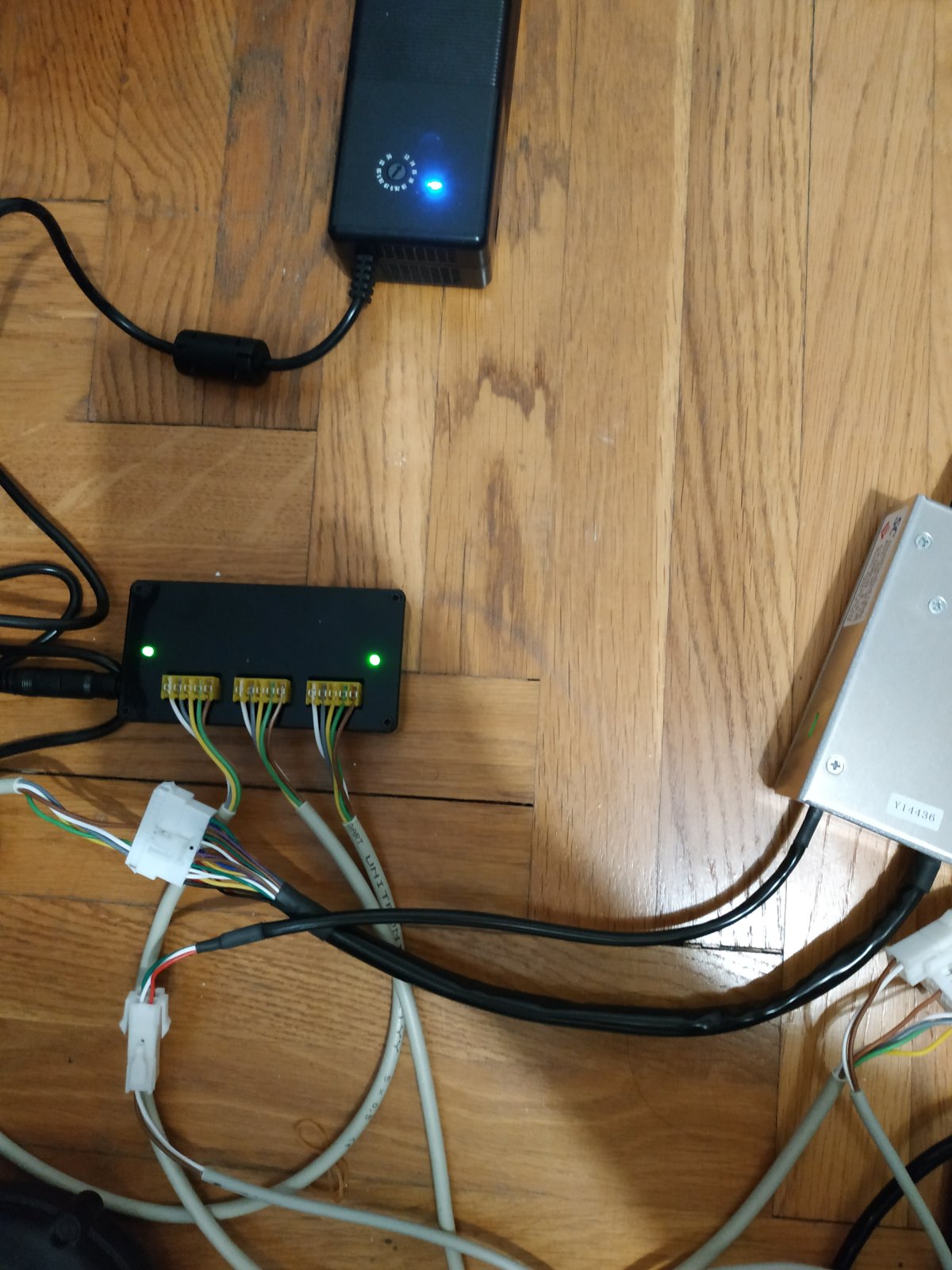

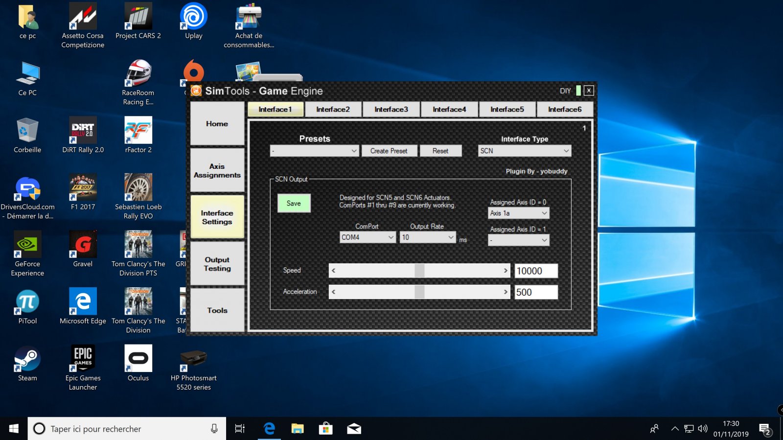

  3. de Galembert
    de Galembert New Member Gold Contributor
    Nov 1, 2019
    6
    2Coins
    Tk you for your answer. Here's some photos...
    Bets regards
    Tk
  4. de Galembert
    Nov 1, 2019
    6
    2Coins
    Hi. All seems to be ok, but it doesn't work….

  5. de Galembert
    Nov 1, 2019
    6
    2Coins
    Hi !
    My problems are solved (I putted on 24V on the battery) !

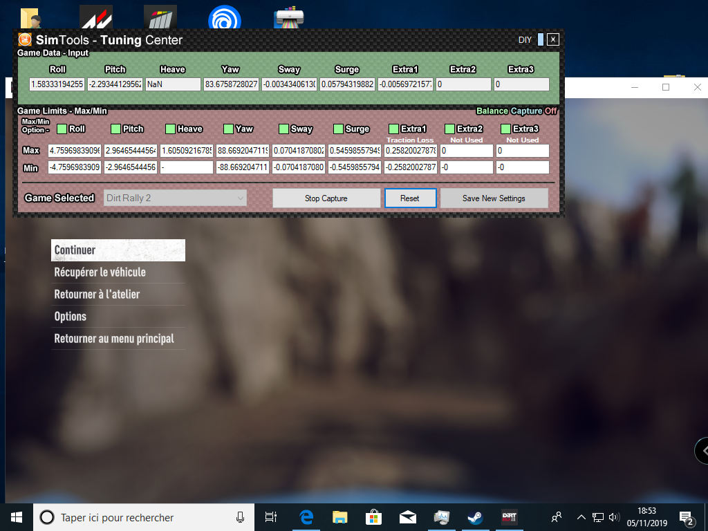

    But I have another problem.
    When I want to reset the paramters for the game Dirt 2 in SimTools - Tuning Center,
    when I put Pause in the game, I cannot save the new parameters (I cannot click on "Save New Settings").
    Why ?
