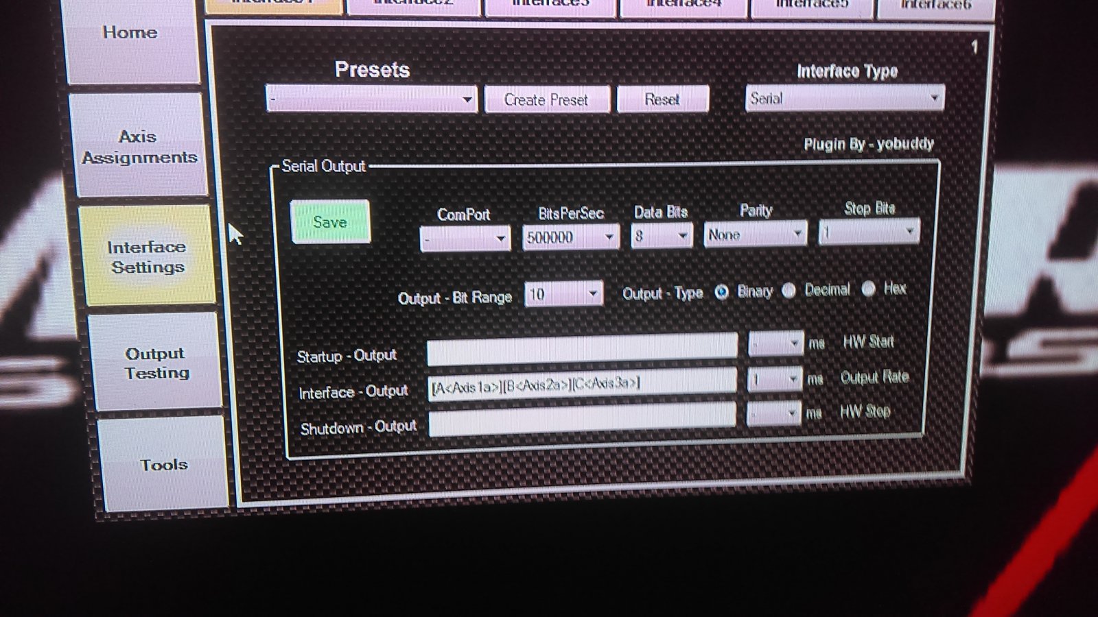

    here are my settings

    ive just turned it on with the frid at 2 open output testing and moved the sway slider afew time it started shaking on motor ive now got it at 9 and its fine FOR NOW im running no limits to test it

    I have great news i have fixed the issues i was having...
    it seems having C Axis3a in simtools axis assignments was the issue
    i also found the ard com port set at 9600 not 128000
    after 4.5 hour non stop testing on all sims no issues no shakes or crazy behavior
    thank you to all the guys that helped try to sort this out with me
