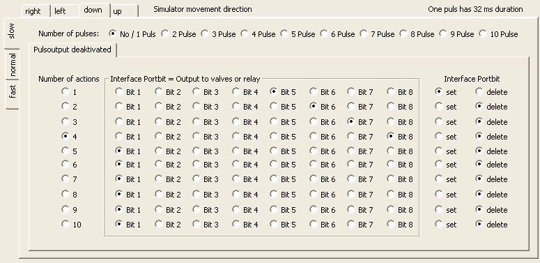

    I have a problem with hanging up platform
    My configuration is
    4 festo MEHs (G)
    2 potis
    K0855 plus relay card
    1 right
    2 right
    3 left
    4 left
    5 down
    6 down
    7 up
    8 up
    Sometimes platform moves left (or right) sometime moves up (or down)
    What`s wrong?

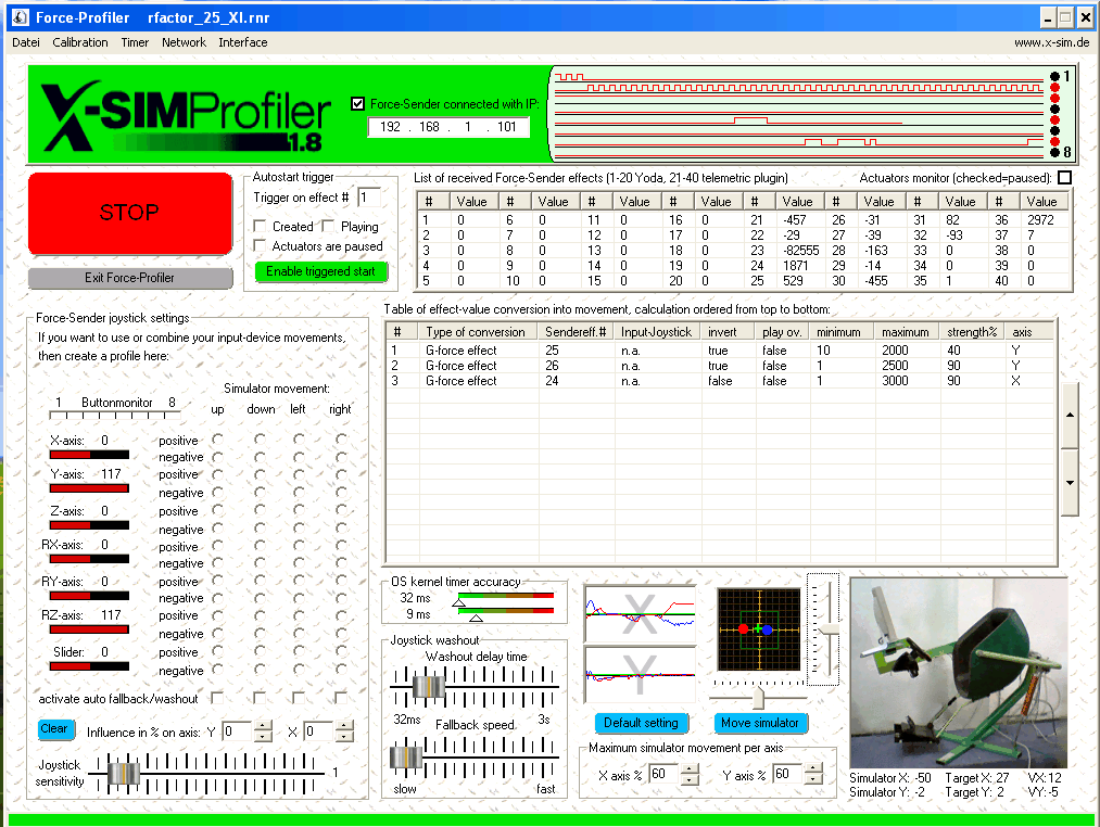

  5. steelsim
    steelsim New Member
    Sep 2, 2007
    10
    1Coins
    With this setup (screen.gif) simulator doesn`t move, when i turn wheel.
    Here another screens, takes with auto pilot in rfcator with suggested settings.
    Hanging of platform is not still, but sometimes is shorter sometimes is longer.

  6. egoexpress
    egoexpress Active Member
    Dec 13, 2006
    3,839
    Germany - Frankfurt/M
    421Coins
    +10 / 1 / -0
    I havent seen that you hadnt activated any joystick axis at all, so the 100%per axis had no effect anyway.
    In case your simulator works fine, besides those hanging ups once a while, then your Profiler setup should be fine as well.
    As you can see on this image, the Profiler tries to move the simulator (blue line), but your set rests in position (hangs).
    So either your pots are not able to provide a stable signal, or your valves are not able to open/close properly. Perhaps there is a mechanical problem with the valves?
    Please make a picture of your pot setup.
    Regards
    Christian
  7. steelsim
    steelsim New Member
    Sep 2, 2007
    10
    1Coins
    Yes, i turned off joystick definetly, and hang ups is often... :(
    Valves is ok, when you open attachment you will see that signal is conflicting. Because says to platform go up and go down (go left and go right) simulatenously.
    I check configuration with K0855_Demo and its look ok (1-right, 2-right, 3-left etc.)
    I have problem with camera now, i`ll try draw it later.
    But signal from pots are very stable and smooth.
    And if you couldn`t open attachments, here are files http://rapidshare.com/files/167258106/screen.zip.html

  9. egoexpress
    Dec 13, 2006
    3,839
    421Coins
    +10 / 1 / -0
    I think there may be some mess with the valve matrix. He wrote that he uses 4 MEH valves (5/3 I think). Perhaps he made wrong settings for the 4 valves setup.
    Perhaps there is a problem with different speeds. It may be that the valvematrix is assigned correctly for slow speed (one valve activated), but wrong for fast speed. As long as the values are low and the Profiler demands slow speed, it works fine, but if the Profiler demands normal or fast speed, a valve matrix error could take effect.
    Perhaps the second valve for fast speed takes air in the wrong direction into the cylinder. This would result, that the cylinder would get air in both air-intakes, keeping the position.
    @machman
    Is it the just the Y-axis, or are you experiencing the problem on both axis?
    Did your simulator did worked well before?
    Please make 3 screenhots of your matrix (slow, normal, fast) with the keystroke (alt|print) and paste it into MS Paint, save it as jpg, and load it up here. So we can have a look on it together.
    Regards
    Christian
  10. steelsim
    steelsim New Member
    Sep 2, 2007
    10
    1Coins
    i use hack with soldering.
    No i have that problem from beginnig
    I change PC, card, add relay card, and change potis with construction and still have this problem.
    Here you are, and complete screens are here: matrix_screens.zip
  11. steelsim
    steelsim New Member
    Sep 2, 2007
    10
    1Coins
    Thanks, here my matrix screens.
    now its working! :clap:

  12. egoexpress
    Dec 13, 2006
    3,839
    421Coins
    +10 / 1 / -0
    I doubt that your valve matrix setup works
    Have a look on this schematic, it should help to see how 3 speeds with four 5/2 valves work in general.
    regards
