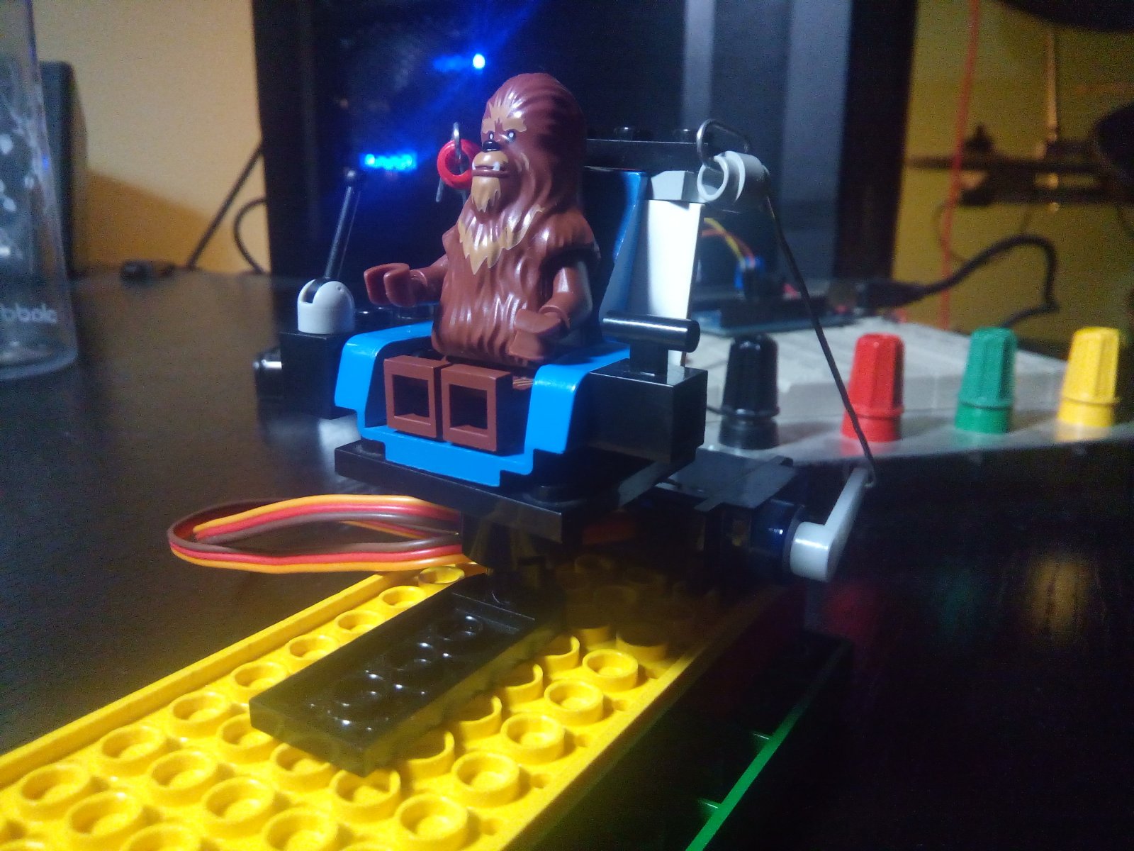

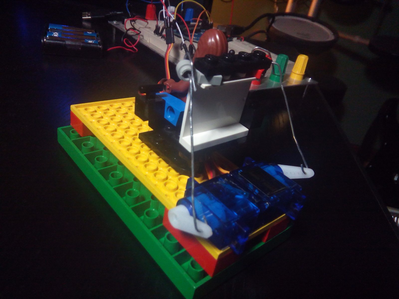

    Thank you @Historiker and @noorbeast for your replies and tips. So sad to hear that of Elite's plugin, hope that it gets resolved soon. I will first try lunarflight or another flight sim then.
    Here are some pics of my rc model, HOTAS included :D IMG_20160320_222210.jpg IMG_20160320_222238.jpg

    nice work

    That's some beautiful pics :)
    Elite wookie in the seat hug:

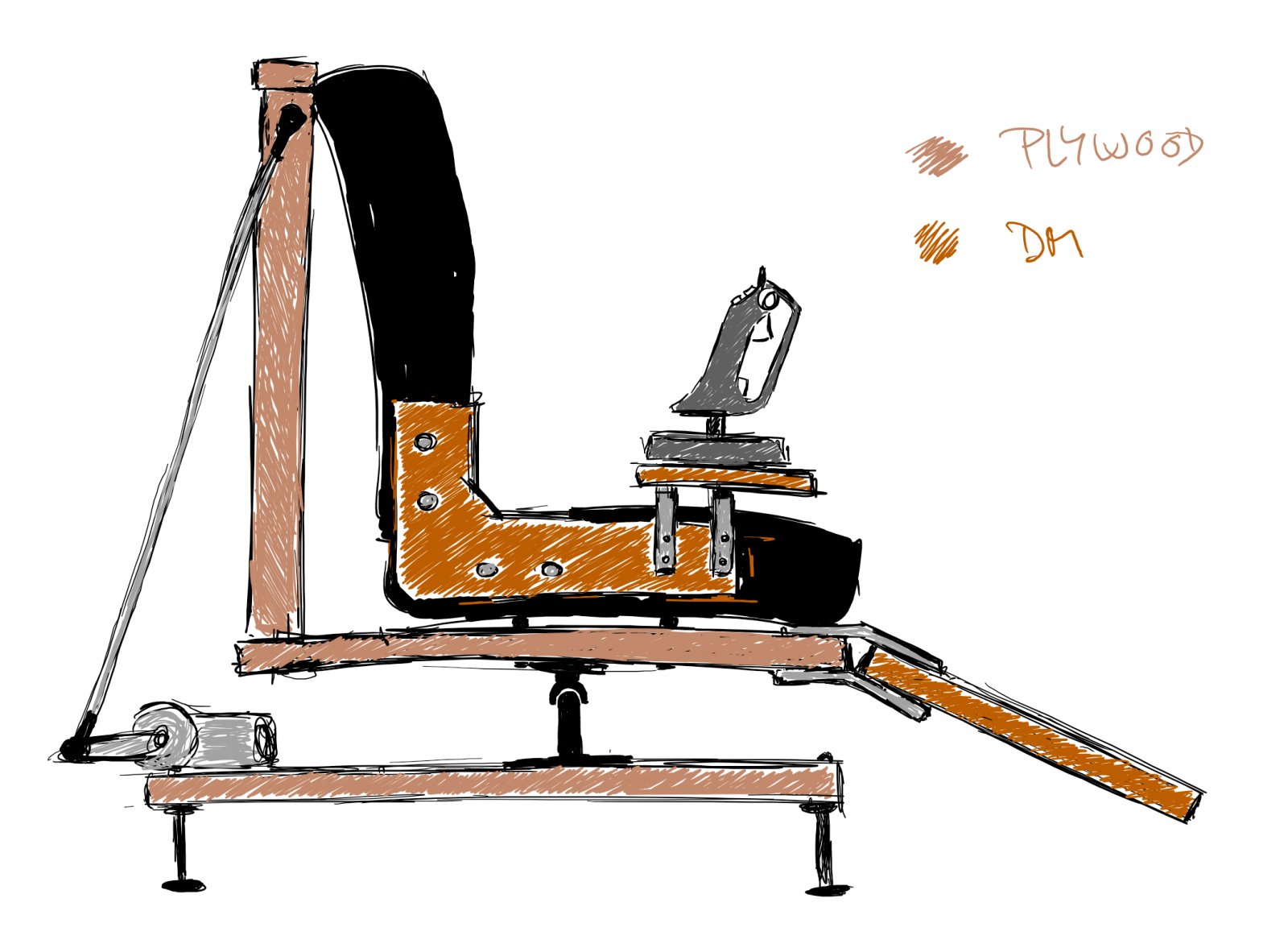

    Ok so here is the first basic sketch of what I've got in mind:
    sketch1.PNG In order to keep things as simple as possible, I decided to go the wood way, with playwood or similar for the parts that require to be strong and cheap DM for the rest.

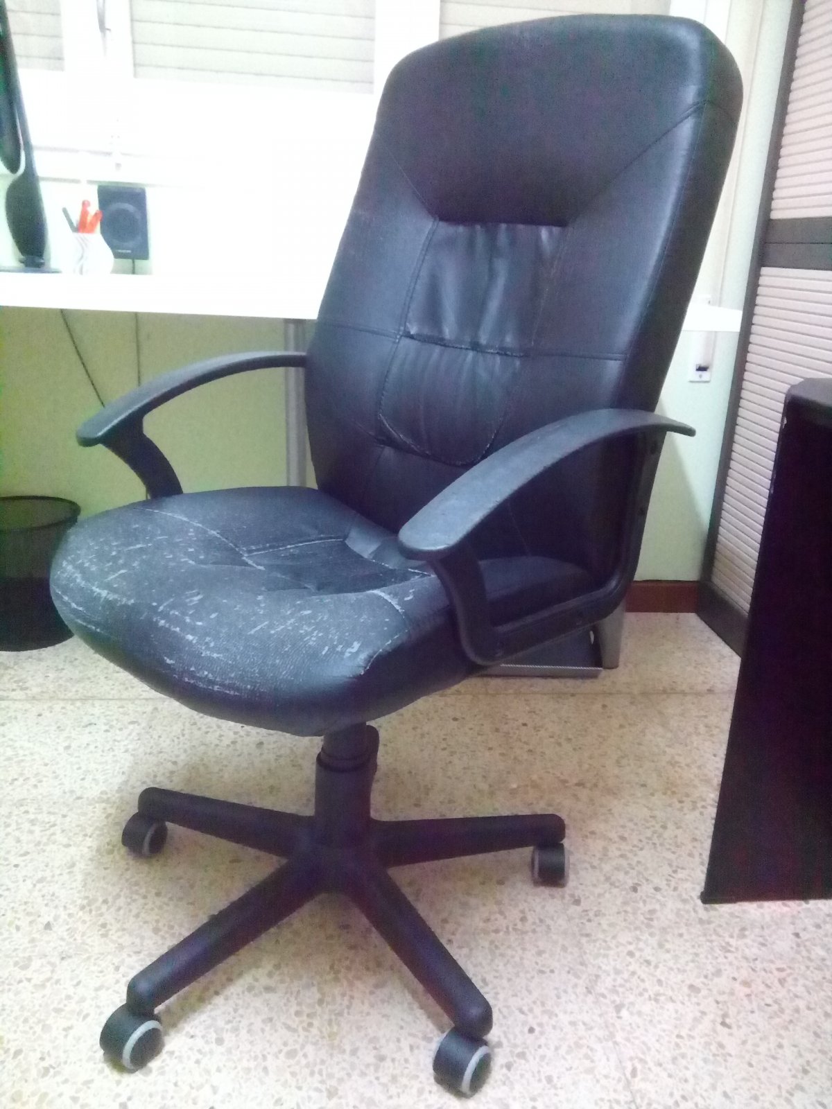

    On the other hand, I'm considering using an old ikea chair:
    I'm not sure wether it's a good idea, but I like it because I could easily unscrew the arms and replace them with some custom ones made out of wood with support for the hotas.
    Any thoughts? I'm all ears!
    Thank you :)

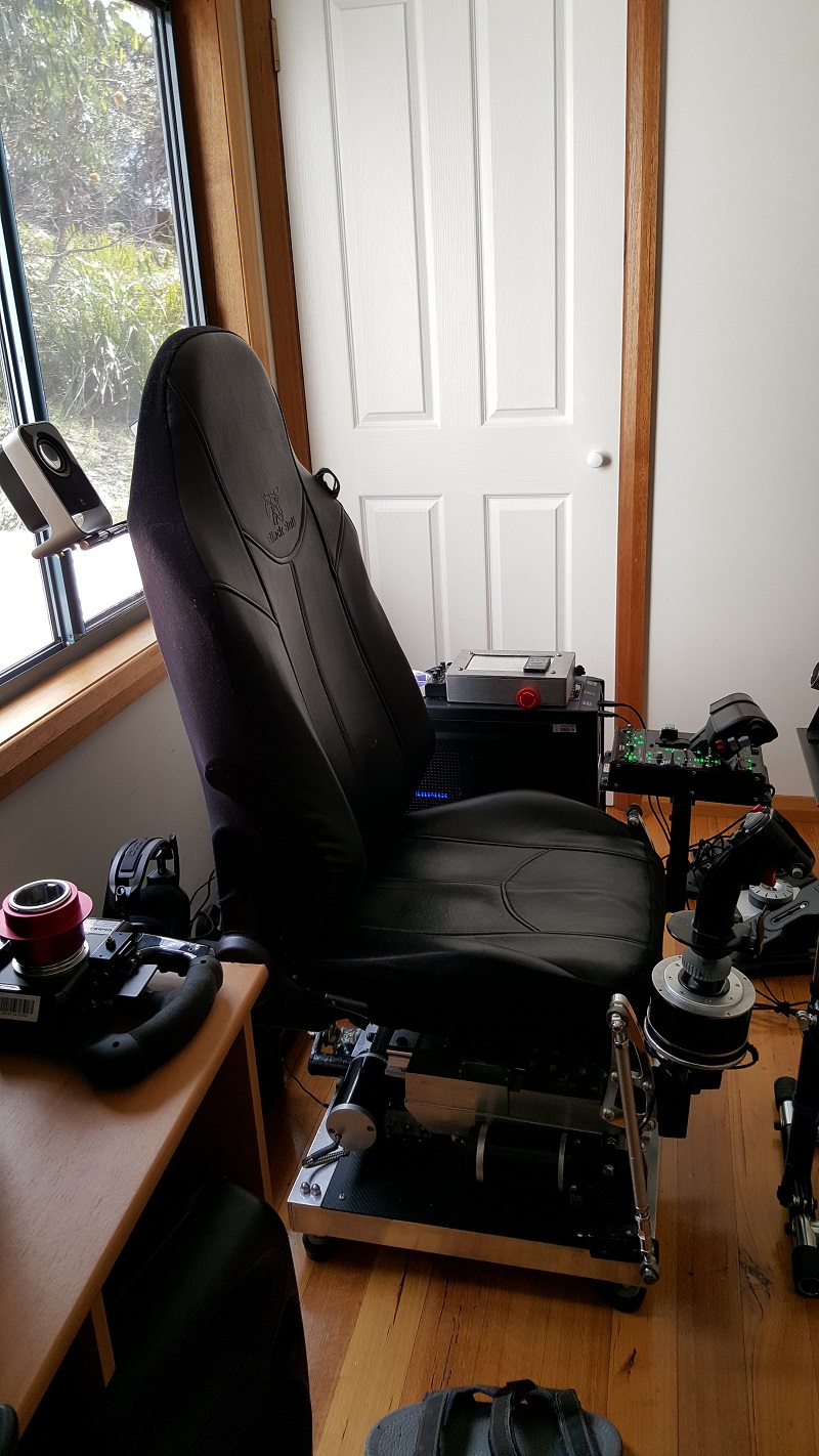

    The HOTAS will likely need to be further forward to be comfortable, here is mine:

    Thanks @noorbeast, you're right. I will set it in a comfortable position when I build it, although I may make it adjustable.

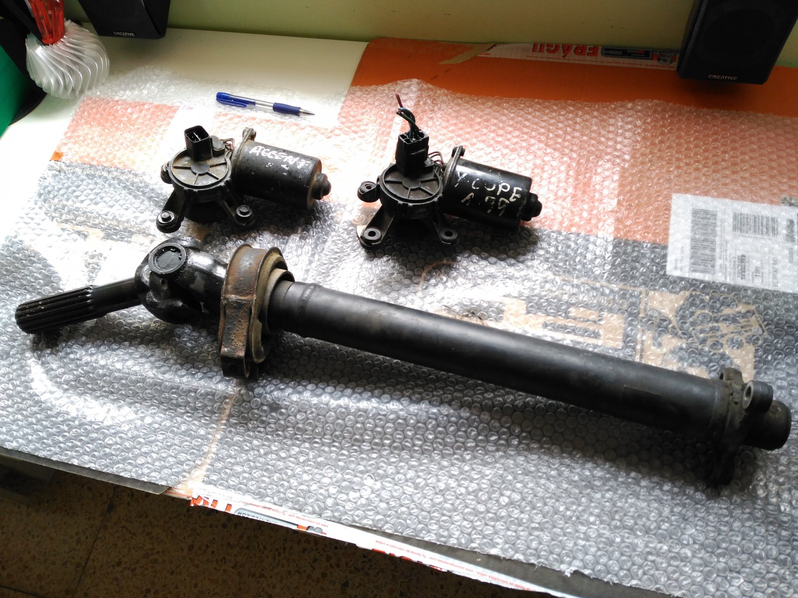

    So I could finally go to the scrapyard and got some wipers and a cardan axis for the universal joint: IMG_20160429_180207.jpg
    I had never seen a wiper before, but I expected them to be bigger. These are from normal cars (not large passenger car or truck) but I hope that are enough for a first rig. After all, they won't have to move any monitor or steering wheel, and I do not weight much. But that's just my guess. What do you think?

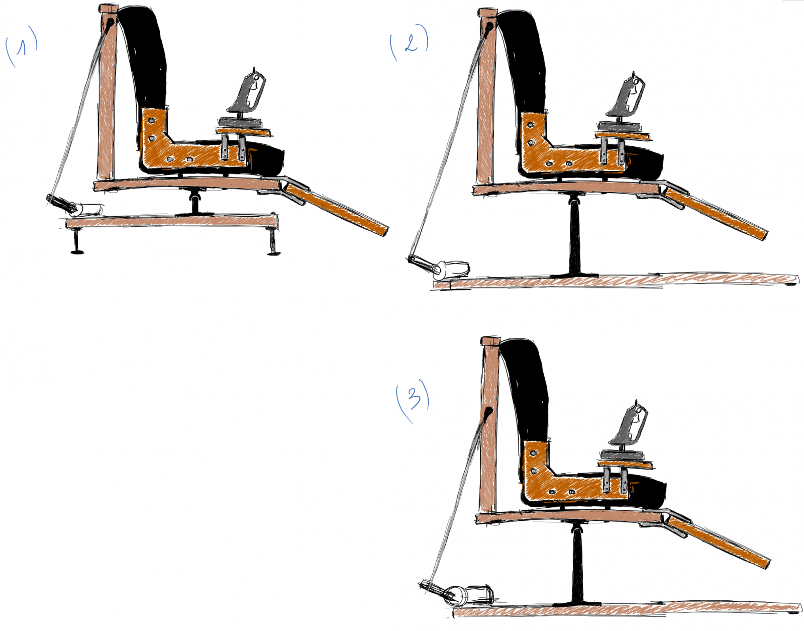

    Regarding the universal joint, I will bring the cardan axis somewhere to cut it and solder some plates. The left side will be attached to the chair, so I will cut the cardan as close to the u-joint as possible. I'm not sure about the right side length though, the one that will be attached to the lower board. A longer bar will result in a higher seat position, which would allow for a more comfortable legs position (not completely straight forward), but would place the motors further as well, which leads to longer rods. How does it affect the rig behaviour? Is there a general rule for this, or it's not that important? Thank you guys.

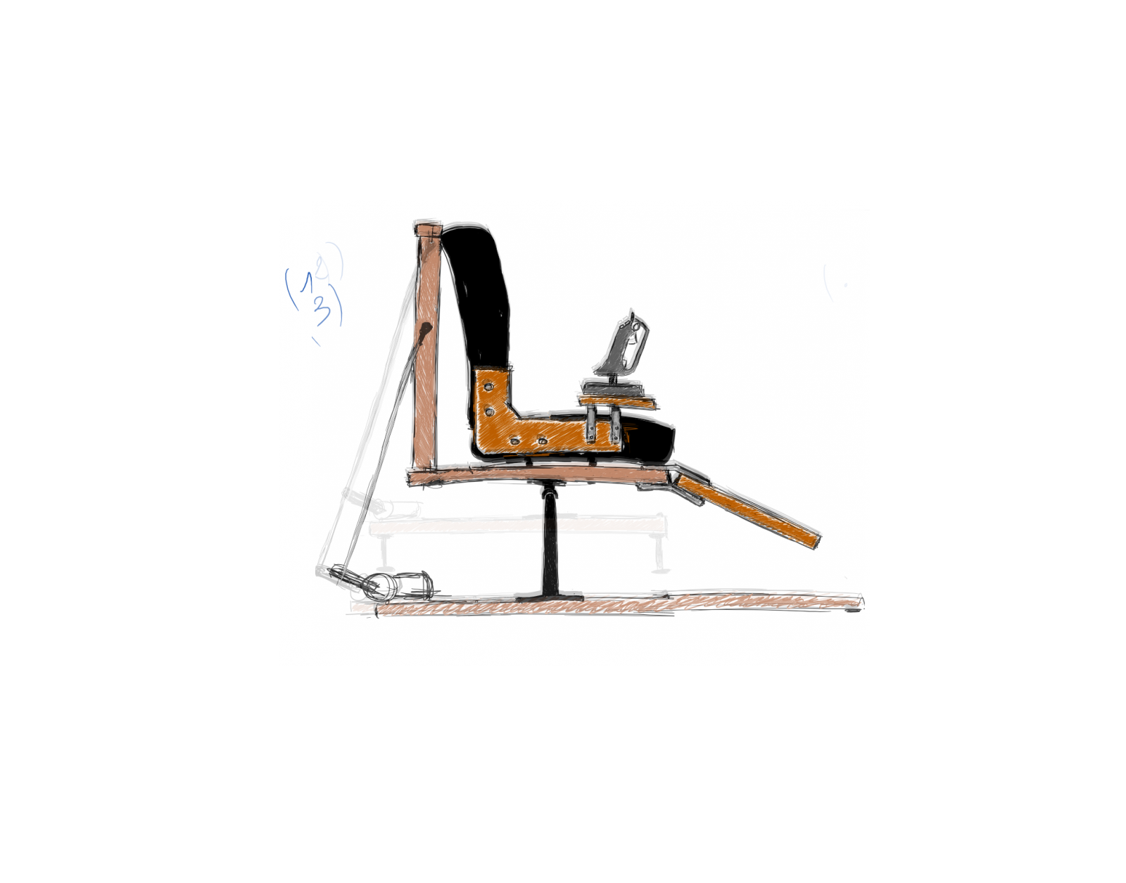

    Thank you @noorbeast! Here are some sketches of the options that I'm considering:
    All of them having the same rod angles. Which one achieves more motor effectiveness? Or, how is the rig affected by the height difference between the u-joint and the motors axes? Thanks guys :)

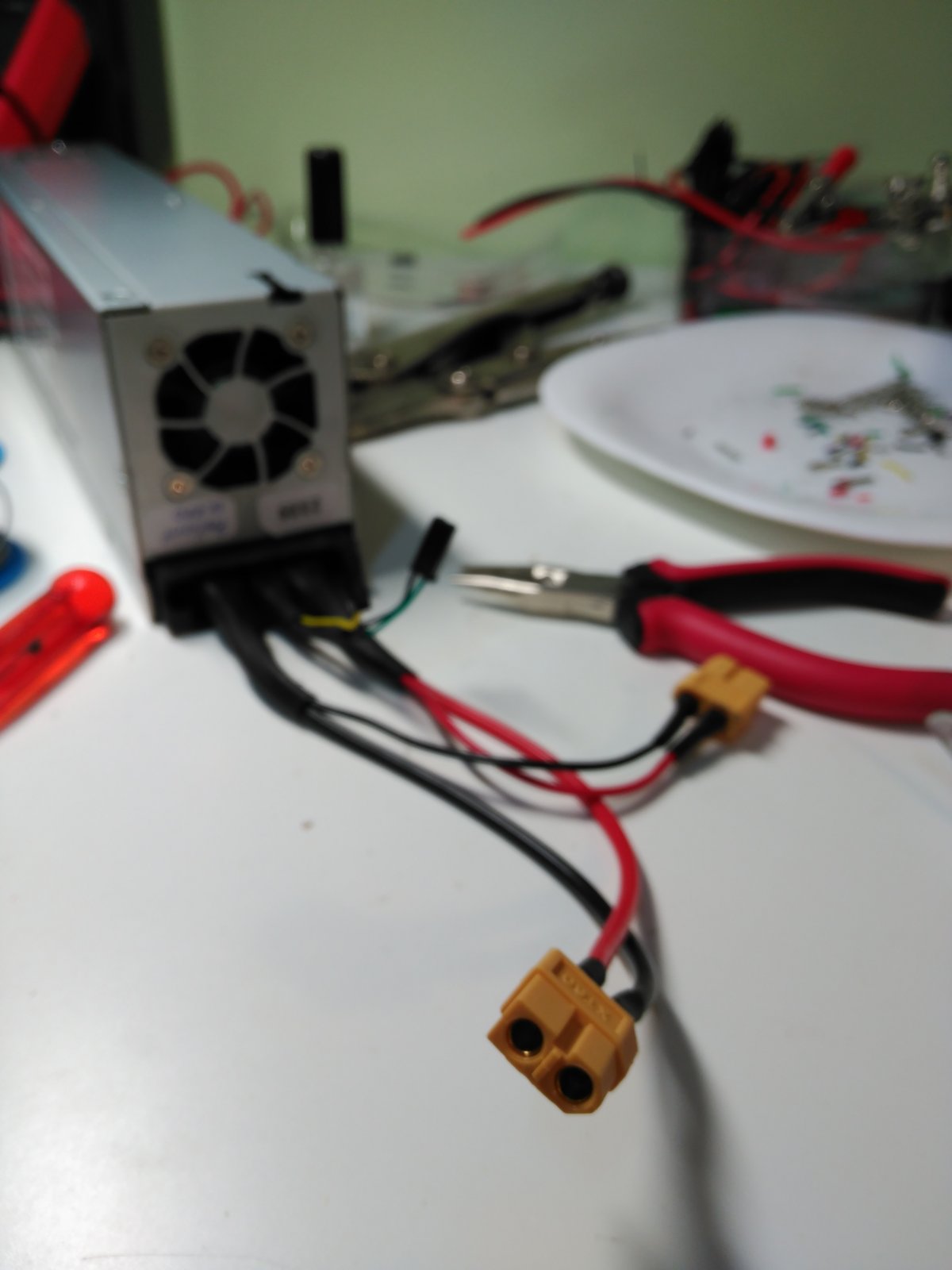

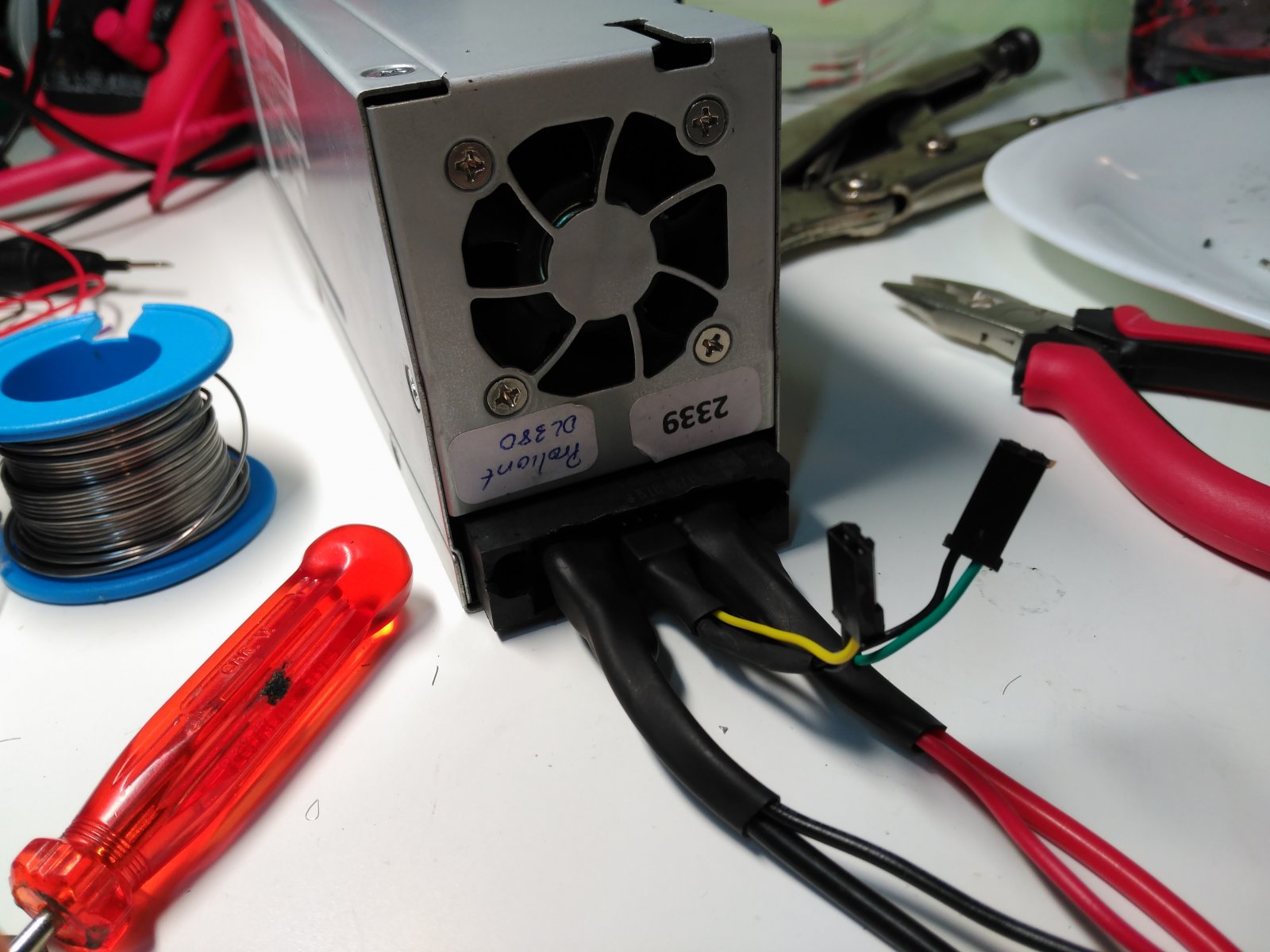

    I've been soldering this weekend. I have prepared the PSU with some connectors, to make it easier to change or add components in the future. IMG_20160605_220751.jpg IMG_20160605_220837.jpg
    Question: about the Monster Moto board, I've seen several builds using it that don't mount it as an arduino shield, soldering the pins with wires instead. Is there any reason for that? Or is just to don't have to solder all the pin strips? My intention was to go with the shield mode, to make the circuit more clean. Just wanted to make sure before I solder it. Thank you all :)
  20. Pit
    3,012
    30,439Coins
    +3,089 / 31 / -0
    First you have to find a code which supports the shield mode. Second most of our users are using one Ard and at minimum 2 MMs - so why to stick one on the Ard and what to do with the second? many of us (me too) are using 4 or more MMs with only one Ard, so better to use bread boards and soldering should not be the hardest thing on earth ;)
