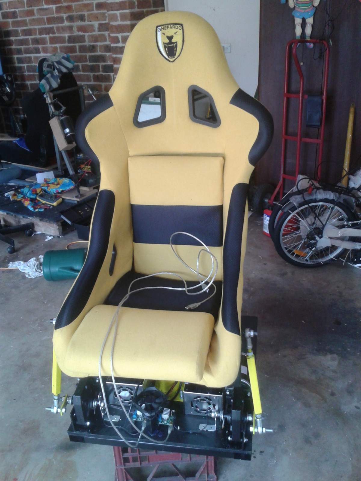

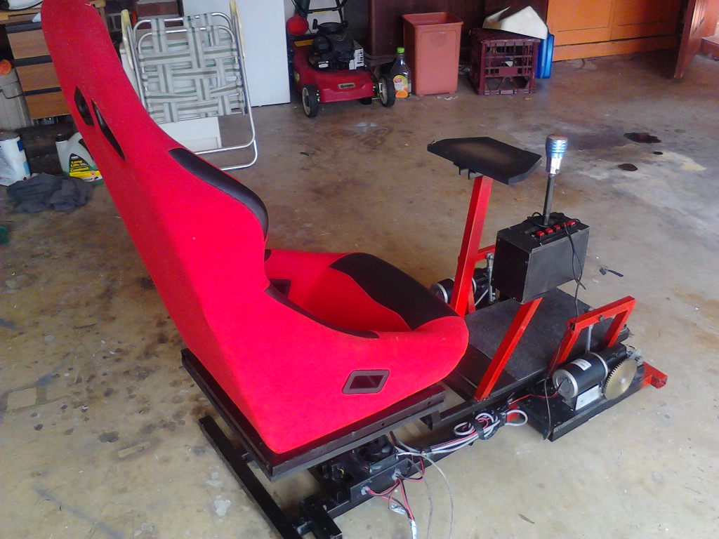

  8. bsft
    Question, is it seat mover or full frame?
    If its seat mover, id suggest a desk racer setup for the motors
    and then you have room for drift at the back
    Or if its a full frame, foot motor mount for compactness
    Dave.

    @Disco42 , I used to have 2 hire sims I ran for a while before time and health gave out, but I can tell you, I had over 100 players and at least 10 professional drivers on them. For a basic seat mover, even the race car drivers found it immersive enough, not realistic, but certainly gave them the impression of realism in game.
    They use 25:1 motors, JRKS, and performed flawlessly. Before that I had a foot motor all in one sim also "hired" out, meaning, it went to mates parties and school fundraisers, again, the realism was there.
    Foot motor with Dirt Showdown, even though the video is not that clear, you can see the level of immersion of the sim in line with the game
    And heres the desk racer showing finer vibration
    both use 25:1 boxes, but even a 50:1 or 60:1 would perform very well, maybe add bass shakers to it if need be
