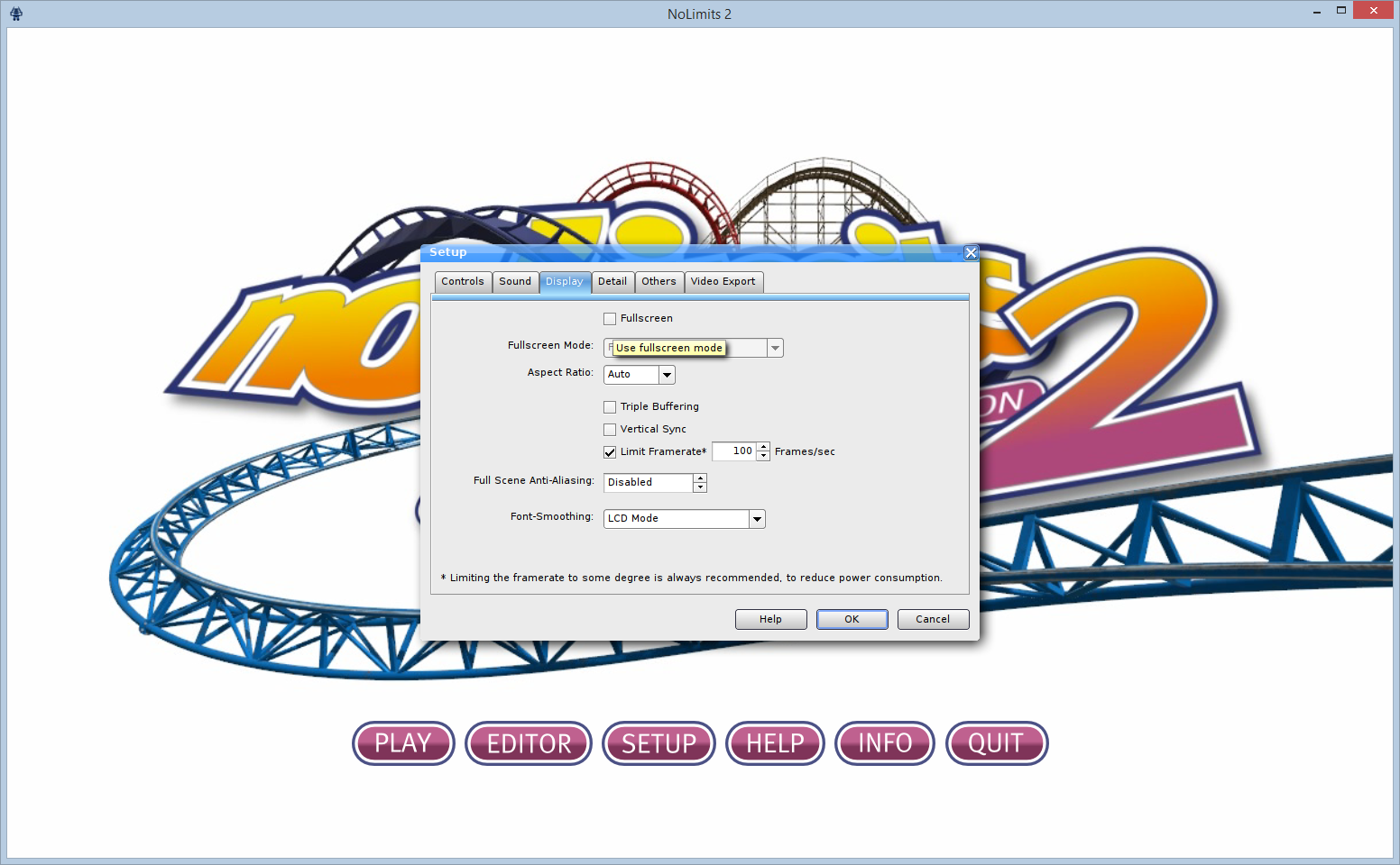

    Setup
    Display
    Uncheck Fullscreen
    NLS does not send out data. This is all done by the plugin.

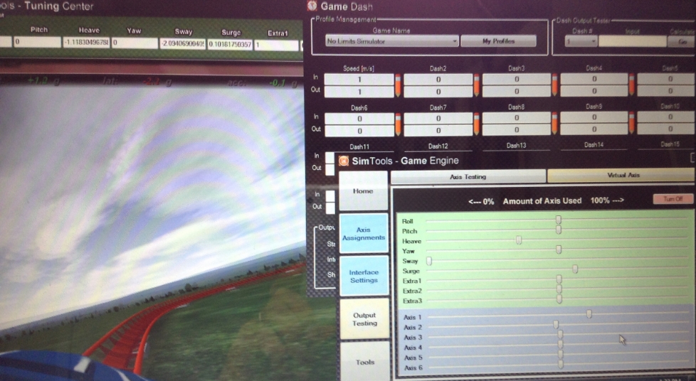

    @value1 - thank you for the help to change No Limits to window instead of full screen. I can now see the Game Dash and Tuning Center - very helpful. Unfortunately, I can now see that No Limits does not include speed as @yobuddy mentioned.
    I am now working with LFS to try to get the fan working with the Dash Board/Arduino. I can see the speed data in the DashBoard, but I am unsure of what to put in the Output Settings area in Game Dash. (Startup - Output, Interface Output and Shutdown - Output).

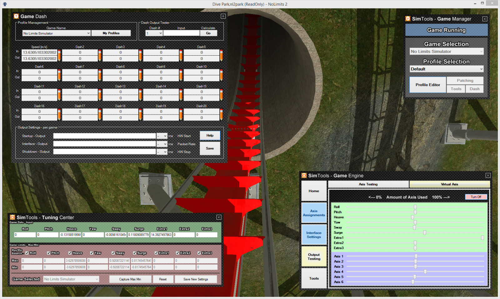

    @value1 - I will try again and try to copy your screen shot on my end. I checked No Limits and I def. see Extra 1 highlighted, I just can't get values to show. Hopefully I will find my problem by copying your screens.

    @value1 - I tried to copy your screens. Mine is not as orderly as yours, but I tried to include as much as I could. I am getting nothing at Extra 1. Could the issue be that I am not running No Limits 2? Should I download the latest plugin again?

    Aha! I wasn't aware that you are running V1.x
    There indeed is no speed availabe. Sorry for the misunderstanding! :cheers
