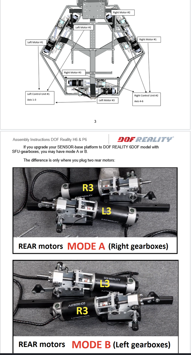

    Evening,
    As the title suggests, I am having extreme difficulty setting up my H6 to work correctly with SRS.
    I have assembled the rig many times, mapped the motors using SMC3. Below are is my motor setup:
    Right Side - plugged into right control box:
    M1 (outer Right side)
    M2 (Inner Right Side)
    M3 (Rear position)
    The left side is the same as the right side expect using the LEFT control box and left motors
    My issue is when i go into SRS testing, selecting pitch the 'chair' slides to the right and vice versa for the downward pitch
    roll is an upward slide/ and downward slide
    Literally NO axis works in the correct orientation. I am totally done with this, I need help (probably mentally as well considering the crap this thing has given me over the past 4 days)
    Does anyone have any suggestions?
    G

    make screen of DOF tools where we can see your configuration of Control Unit
